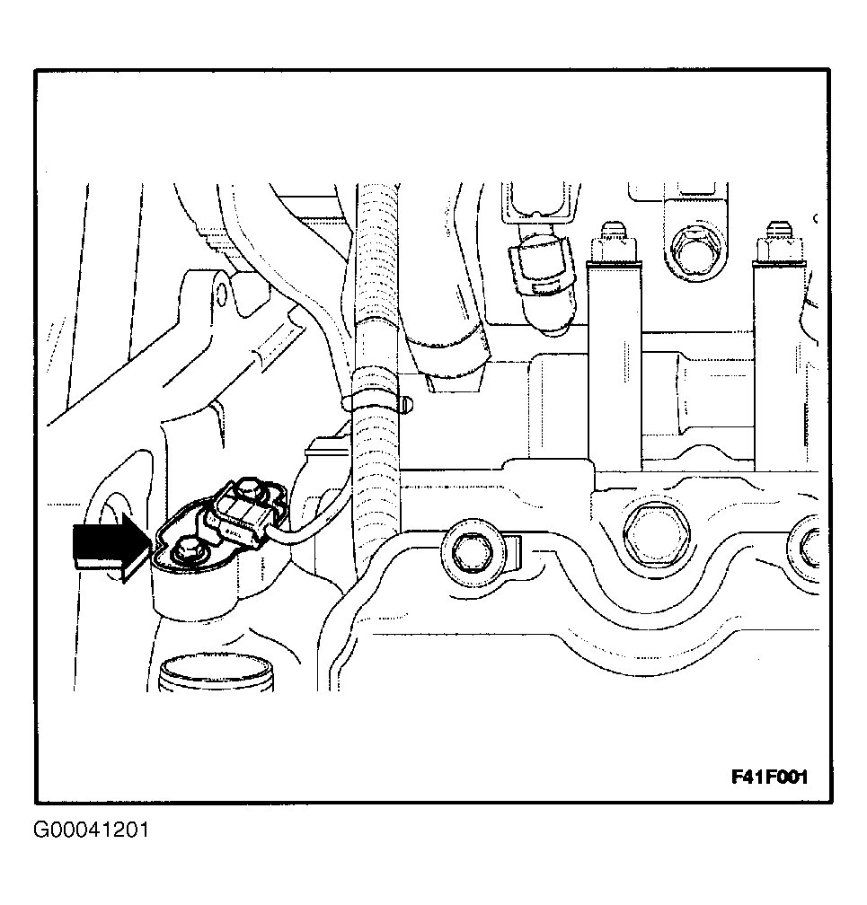

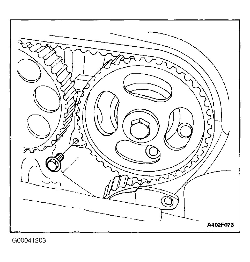

Replaced water pump, timing belt, and camshaft sensor. Timing is correct. Wants to start but will not. Has spark, has fuel up to injectors, but plugs are not getting fuel. fuel injectors are clean.

If you find there is no signal from the sensor, check for disconnected wiring, damaged connector. The cam sensor sends a signal to the power control module which is then used to trigger the injectors in the proper sequence. If it is not working, there will be no injector pulse to fire the injectors regardless if there is gas to them. See if it starts using starting fluid. If it does, at least you can be certain the timing is correct.
I have attached two pictures of cam sensors. The first one is for the DOHC engine and the second is the SOHC engine. I am not sure which you have. Anyway, I thought it may help locate the component for you.
I hope this helps. Let me know what you find or if you have other questions.
