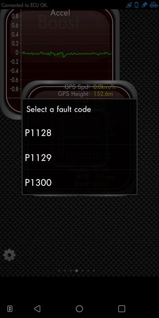

Okay, so I have been without running car for about week and a half now and i'm about to lose my mind. it happen on highway and it just kind of lost throttle response and backfired once or twice then came to a stop. it will crank and sputter like it wants to start but will not. Or it actually has for a second or two but no throttle response and shuts off. I can happily upload video if anyone wants. i am getting codes p1128,p1129 and 1130 . i was getting 1128 and 1300 before and have had throttle issues in past so i had an extra throttle body and i did change the motor TPS and apps, so basically all the components. I tried to start after replacing that and got all 3 codes i didn't clear it but did leave the battery off for at least a day so probably cleared but wanted to include all the codes so i can provide as much info as possible. I don't want or have the money to throw parts at it so help on what the issue is would be appreciated .thanks

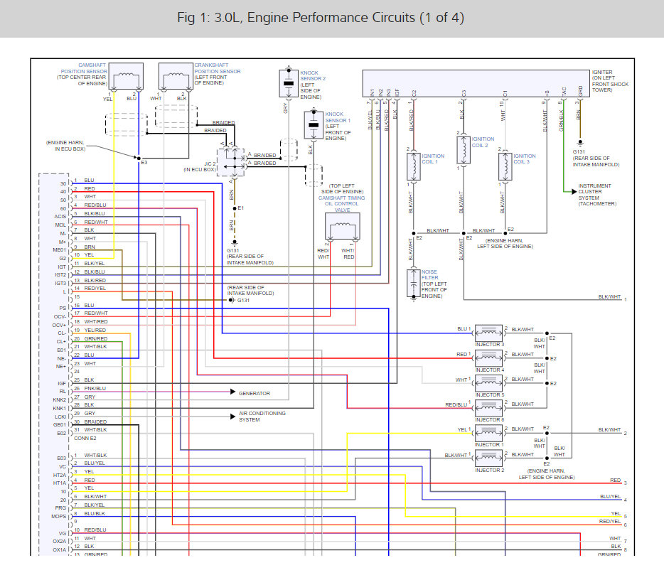

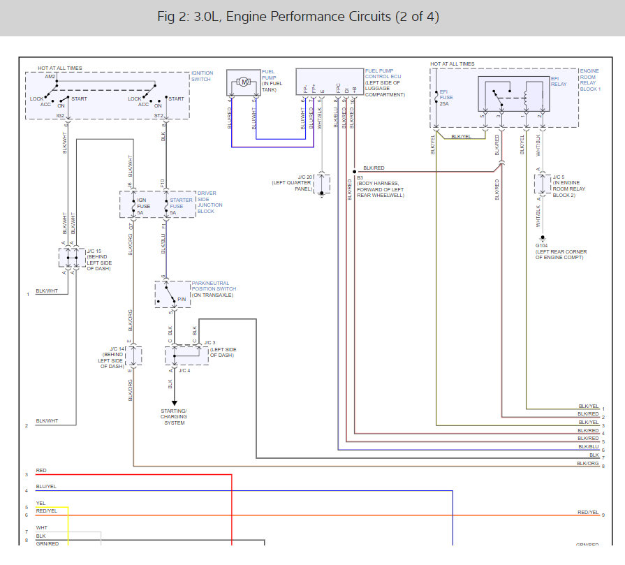

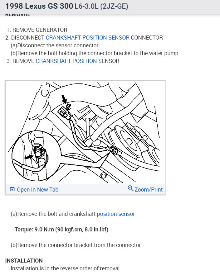

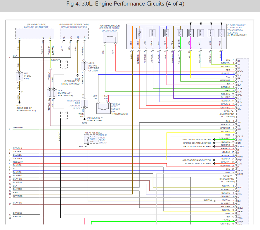

Thanks for the video. it does seem to crank over normally which is good. When you turn the key to the on position without cranking the engine over can you hear the fuel pump run in the tank for 5 seconds? It must be quiet for this test. If so lets try to check for spark because it could be a crankshaft angle sensor that is going out which will not leave a code.
Here are two guides to help us:
and

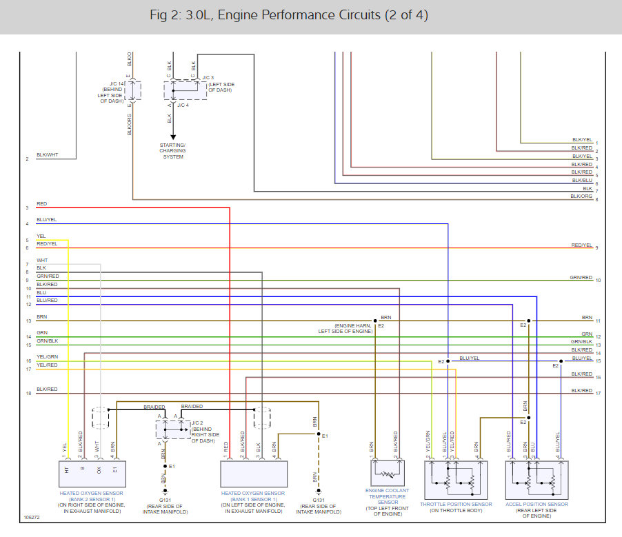

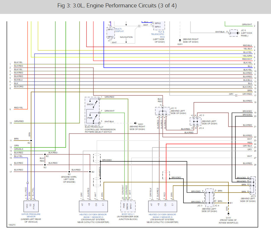

Here is the crankshaft angle sensor location. Check out the diagrams (below). Please let us know what happens.
May 12, 2020 at 3:56 AM
CHRISTA DICKSON
  • 150 POSTS
Okay, so i tested for spark with spark tester and getting spark . this may be a dumb question, but i would like to be sure on the crank sensor it has a ground strap on the sensor side but then connector only has 2 wires, correct? A friend had messed up one of the wire to the harness of the crank sensor i think its behind alternator right? I am nearly positive that's what it is , since i have gotten another harness from pick n pull and soldiered the new harness in but what should i Do with the ground strap ? Do i ground it to something or just leave it unplugged i only see it on sensor side of connector and the other end has a 2 wire harness, it you could clarify that for me would appreciate it i also tested crank harness resistance with multi-meter appears good.

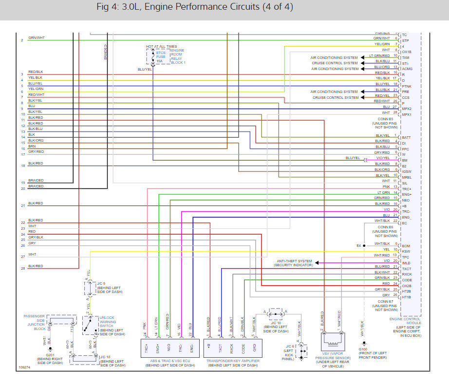

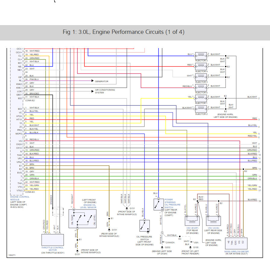

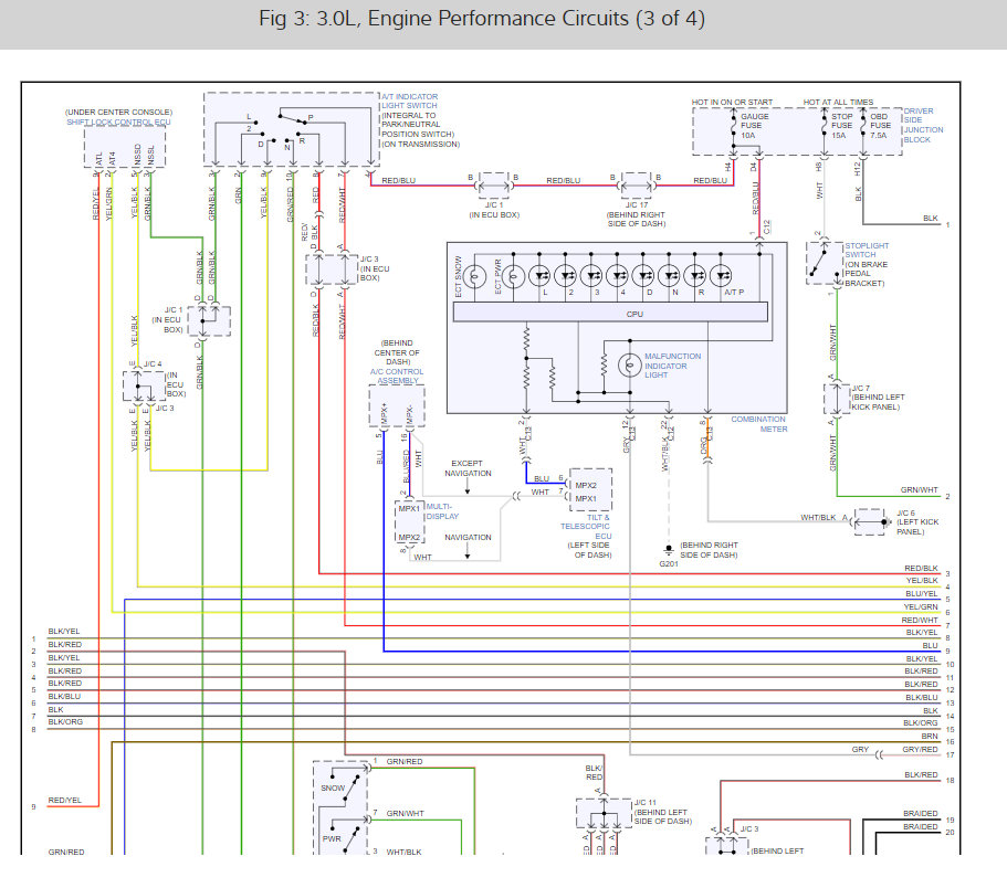

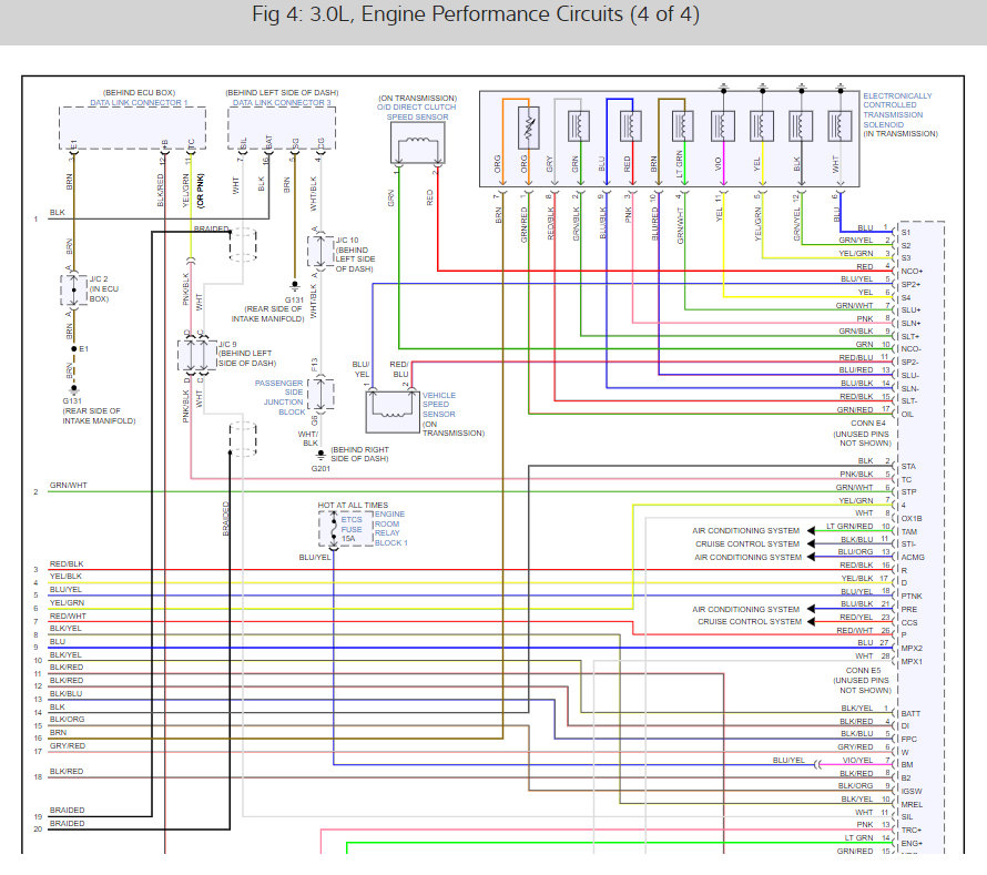

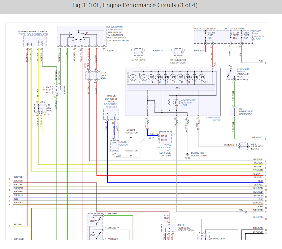

Yes, the sensor only has two wires the ground strap is to help keep noise out of the circuit. Here is a guide to help you run some tests with the engine and crankshaft wiring diagrams below:
