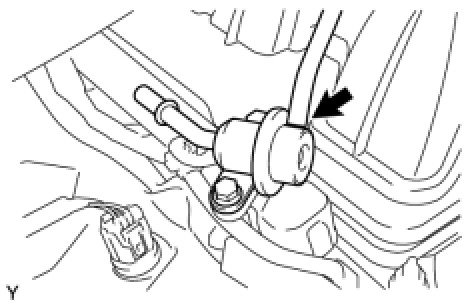

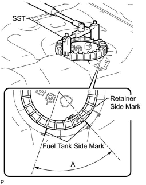

My vehicle will not start normally. I can get it to start if I put starter fluid in the intake. The security light goes off which seems to mean the key is good. I have spark. I have a new battery. Air filter and throttle body were clean.
When I turn the key to "on", I can hear the fuel pump priming but it doesn't cut off, it just keeps whirring away. I am trying to see if this is a fuel control module or fuel pump issue.
Thanks

Next, I suggest checking fuel pressure and the regulator. Here is a link that describes how it is done:
If you determine the regulator is bad, here are the directions for replacement. All attached pictures correlate with the following sets of directions.

FUEL PRESSURE REGULATOR: REMOVAL
1. DISCHARGE FUEL SYSTEM PRESSURE See: Fuel Injector > Removal and Replacement > Removal
2. REMOVE V-BANK COVER See: Intake Manifold > Removal and Replacement > Removal
3. REMOVE AIR CLEANER HOSE ASSEMBLY See: Intake Manifold > Removal and Replacement > Removal
4. REMOVE NO. 2 FUEL TUBE SUB-ASSEMBLY See: Fuel Injector > Removal and Replacement > Removal

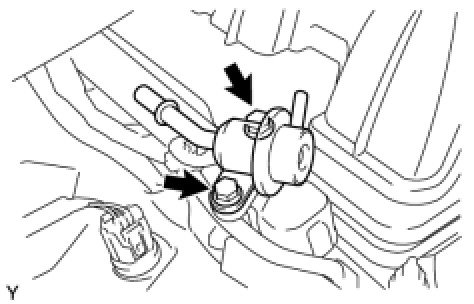

5. REMOVE FUEL PRESSURE REGULATOR ASSEMBLY
(a)Disconnect the vacuum sensing hose from the fuel pressure regulator.
(b)Remove the 2 bolts, and pull out the fuel pressure regulator.
(c)Remove the O-ring from the pressure regulator.

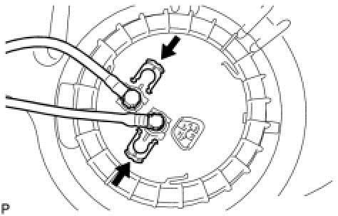

If you determine the pump is bad, here are the directions for replacement.
REMOVAL
3UR-FE FUEL: FUEL PUMP: REMOVAL
1. REMOVE FUEL TANK ASSEMBLY
(a)Remove the fuel tank assembly See: Fuel Tank > Removal and Replacement > Removal.

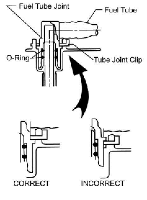

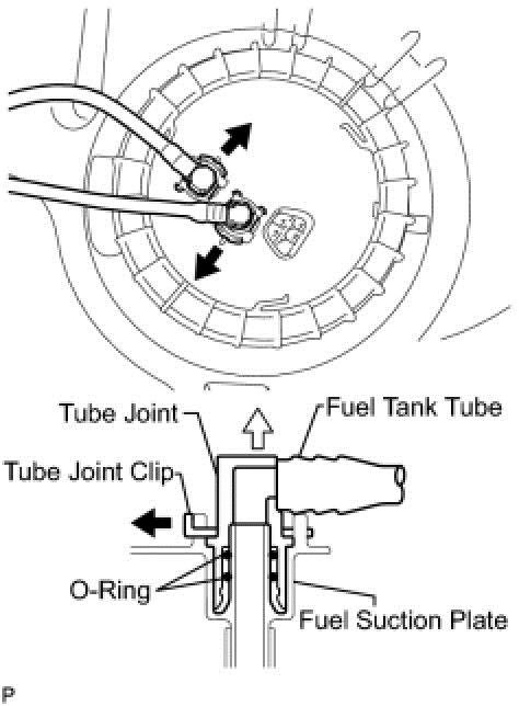

2. REMOVE FUEL SUCTION WITH PUMP AND GAUGE TUBE ASSEMBLY
(a)Remove the 2 tube joint clips and pull out the 2 fuel tank tubes.
NOTICE:
* Remove any dirt and foreign matter on the fuel tube joint before performing this work.
* Do not allow any scratches or foreign matter on the parts when disconnecting them, as the fuel tube joint contains the O-rings that seal the plug.
* Perform this work by hand. Do not use any tools.
* Do not forcibly bend, twist or turn the nylon tube.
* Protect the disconnected part by covering it with a plastic bag and tape after disconnecting the fuel tubes.

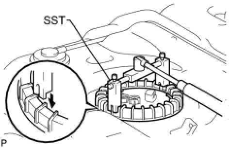

(b)Using SST, loosen the retainer.
SST : 09808-14020
HINT
Fit the tips of SST onto the ribs of the retainer.
NOTICE:
* When the retainer is loosened, be careful as the fuel suction with pump and gauge tube assembly will spring upward from the force of the spring.
* Clean the fuel suction with pump and gauge tube assembly before this operation.
(c)Remove the retainer.
(d)Remove the fuel suction with pump and gauge tube assembly from the fuel tank.
NOTICE:
Be careful not to bend the arm of the fuel sender gauge.
(e)Remove the gasket from the fuel tank.

3UR-FE FUEL: FUEL PUMP: INSTALLATION

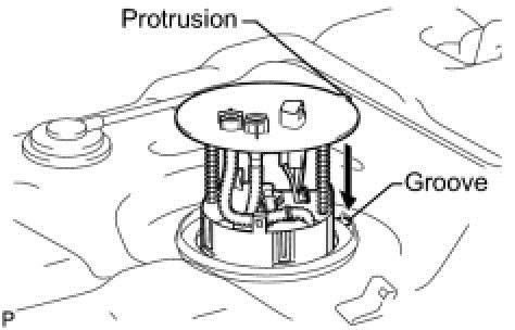

1. INSTALL FUEL SUCTION WITH PUMP AND GAUGE TUBE ASSEMBLY
(a)Apply a light coat of gasoline or grease to a new gasket, and install it to the fuel tank.
(b)Align the protrusion of the fuel suction with pump and gauge tube assembly with the groove of the fuel tank.
(c)Install the fuel suction with pump and gauge tube assembly into the fuel tank.
NOTICE:
Be careful not to bend the arm of the fuel suction with pump and gauge tube assembly.
(d)Put the retainer on the fuel tank. While holding the fuel suction with pump and gauge tube assembly, tighten the retainer one complete turn by hand.
(e)Using SST, tighten the retainer until the mark on the retainer is within range A on the fuel tank, as shown in the illustration.
SST : 09808-14020
HINT
(f)Install the 2 fuel tank tubes with the 2 tube joint clips.
NOTICE:
* Check that there are no scratches or foreign objects on the connecting parts.
* Check that the fuel tube joints are inserted securely.
* Check that the tube joint clips are on the collars of the fuel tube joints.
* After installing the tube joint clips, check that the fuel tube joints have not been pulled off.

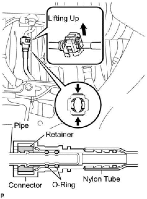

REMOVAL
3UR-FE FUEL: FUEL TANK: REMOVAL
See: Fuel Delivery and Air Induction > Technician Safety Information
2. REMOVE FUEL TANK CAP

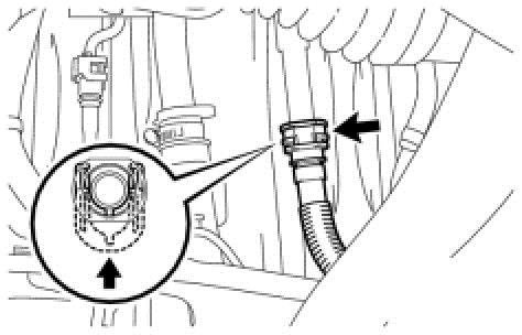

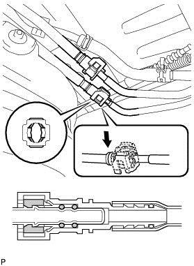

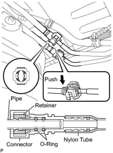

3. DISCONNECT FUEL TANK MAIN TUBE SUB-ASSEMBLY
(a)Detach the lock claw by lifting up the cover, as shown in the illustration.
(b)Pinch and pull the main tube connector to disconnect the fuel tank main tube sub-assembly connector from the pipe.
NOTICE:
* Check for foreign matter in the pipe and around the connector. Clean if necessary. Foreign matter may damage the O-ring or cause leaks in the seal between the pipe and connector.
* Do not use any tools to separate the pipe and connector.
* Do not forcefully bend or twist the nylon tube.
* Check for foreign matter on the pipe seal surface. Clean if necessary.
* Put the pipe and connector ends in plastic bags to prevent damage and foreign matter contamination.
* If the pipe and connector are stuck together, pinch the connector between your fingers and turn it carefully to disconnect it.

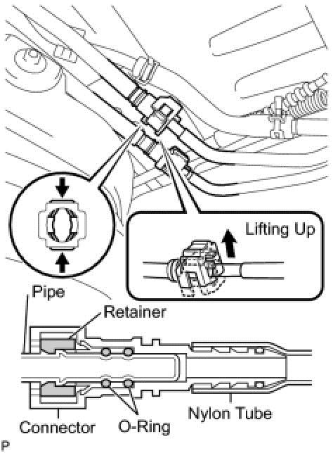

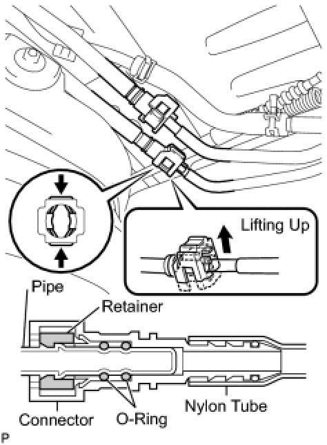

4. DISCONNECT FUEL TANK RETURN TUBE
(b)Pinch and pull the return tube connector to disconnect the fuel tank return tube connector from the pipe.
NOTICE:

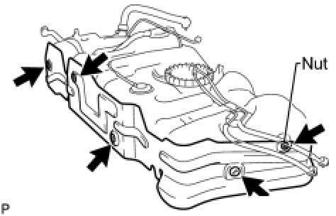

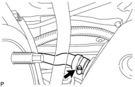

5. REMOVE FUEL TANK ASSEMBLY

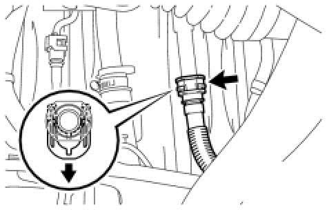

(a)Disconnect the fuel tank to filler pipe hose from the fuel tank assembly.
(b)Pull up the retainer and disconnect the vent line hose.
(c)Detach the lock claw by lifting up the cover, as shown in the illustration.
(d)Disconnect the fuel tank breather tube from the fuel tank inlet pipe sub-assembly.

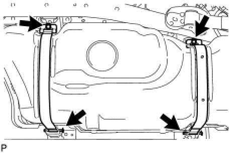

(e)Set a mission jack underneath the fuel tank assembly.
(f)Remove the 2 bolts, 2 clips, 2 pins and 2 fuel tank bands.
(g)Slowly lower the mission jack slightly.
NOTICE:
Be careful not to cut the wirings.
(h)Disconnect the wire harness clamp from the fuel tank assembly.

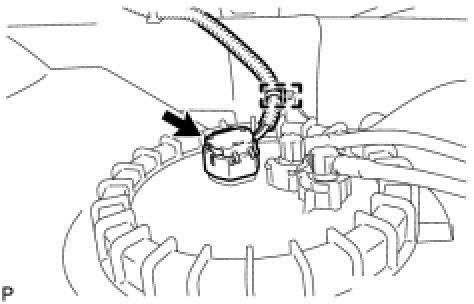

(i)Disconnect the fuel pump connector and lower the mission jack.
NOTICE:
* Before this procedure, check the connector for dirt, mud or other contamination.
* Do not use any tools in this procedure.

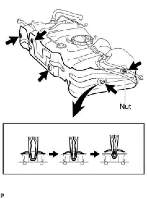

6. REMOVE NO. 1 FUEL TANK HEAT INSULATOR
(a)Remove the nut from the heat insulator.
(b)Using needle-nose pliers, remove the 4 clips shown in the illustration and then remove the No. 1 fuel tank heat insulator.

2. INSTALL NO. 1 FUEL TANK HEAT INSULATOR
(a)Install the No. 1 fuel tank heat insulator with the 4 clips and nut.
Torque : 6.0 Nm (61 kgf-cm, 53 in-lbf)

(d)Install the 2 fuel tank bands with the 2 pins and 2 clips.
(e)Connect the 2 fuel tank bands with the 2 bolts.
Torque : 40 Nm (408 kgf-cm, 30 ft-lbf)

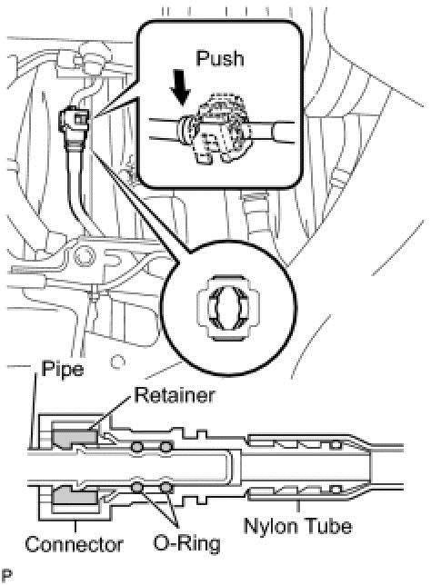

4. CONNECT FUEL TANK RETURN TUBE
(a)Connect the fuel tank return tube.
HINT
Push the parts together firmly until a "click" sound is heard.
NOTICE:
* Before installing the tube connectors to the pipes, check if there is any damage or foreign matter in the connectors.
* After the connection, check if the connectors and pipes are securely connected by trying to pull them apart.
(b)Attach the lock claws to the connector by pushing down on the cover, as shown in the illustration.
5. CONNECT FUEL TANK MAIN TUBE SUB-ASSEMBLY
(a)Connect the fuel tank main tube.
HINT
NOTICE:
