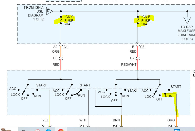

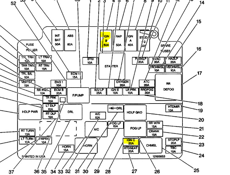

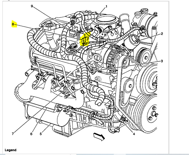

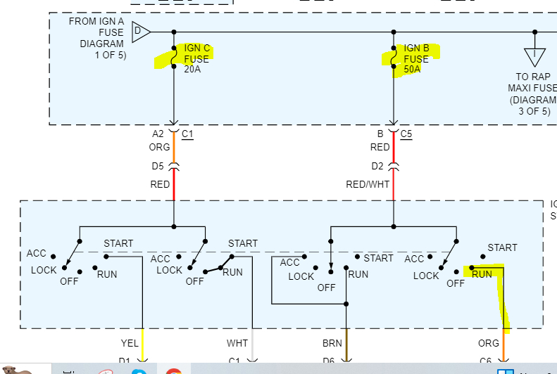

The first things I need you to check are ignition fuses B and C. Both fuses are located in the under-hood fuse box. Once the vehicle starts, the key is released and power travels through the IGN B fuse. (See pic 1 below)
When you check these fuses, make sure there is power to and from them as well.
Let me know what you find.
See pics below. Pic shows fuse locations.

Both fuses have power to and from.

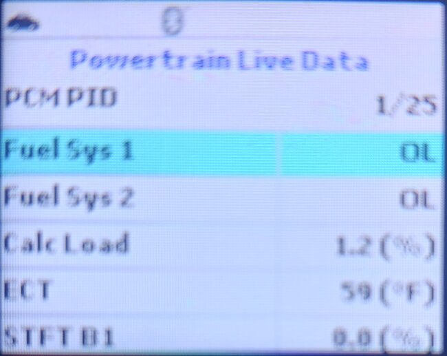

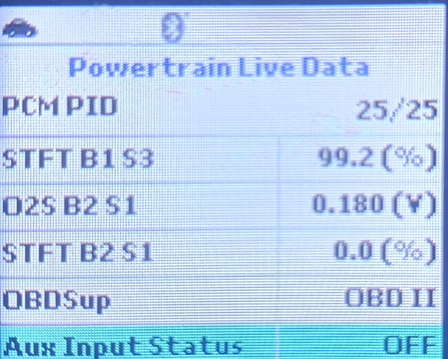

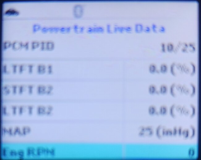

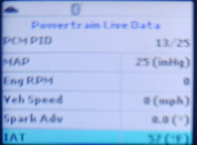

Hi Joe, no the ignition control module was not changed when I did the work. I've never had to change that in the past doing the work that I've done on other cars. But who knows maybe I missed something along the way. LOL I have ran a scan on it and it was throwing a code for the MAF sensor. I cleaned the MAF sensor and reinstalled it and it has not thrown the same code again. I do have screenshots of the live data info it threw up though. Would you like me to screenshot that to you? Also, it has been suggested that maybe changing out the crankshaft position sensor in the camshaft position sensor might be an issue. What is your opinion on this?

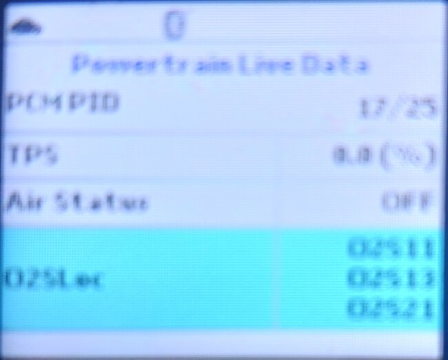

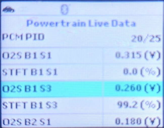

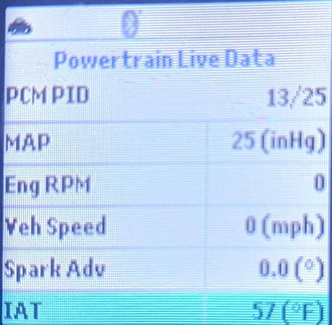

Sorry I wanted to run a new live data scan. These images are kind of blurry so if you have a hard time reading then please let me know.
Jun 5, 2023 at 7:28 PM
  • 110,244 POSTS
Things appear normal for an engine not running. However, we still have the 99% on the downstream sensor. I can't think of anything that would cause the 99% other than the PCM.

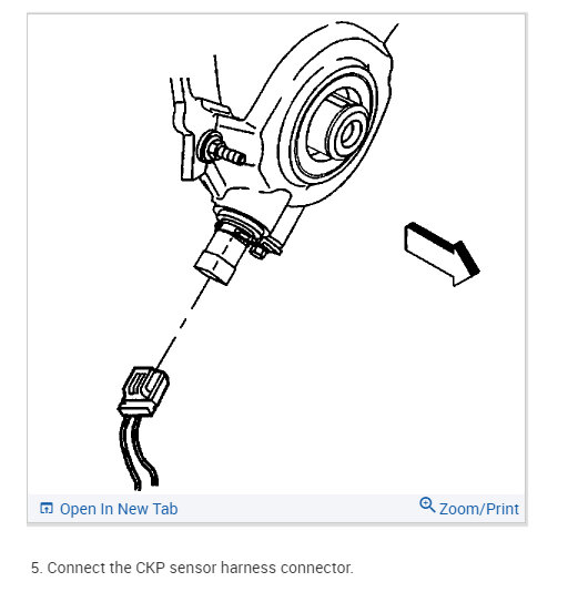

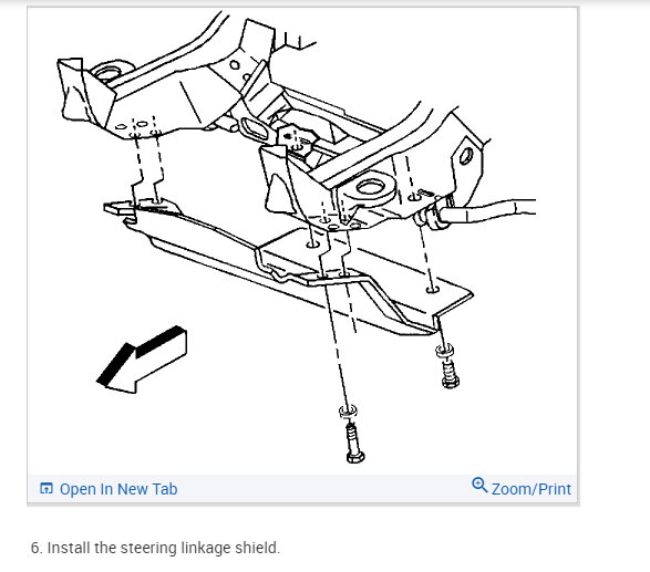

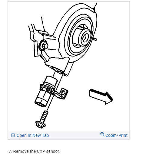

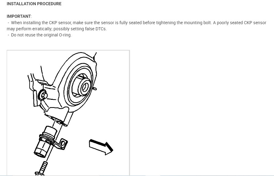

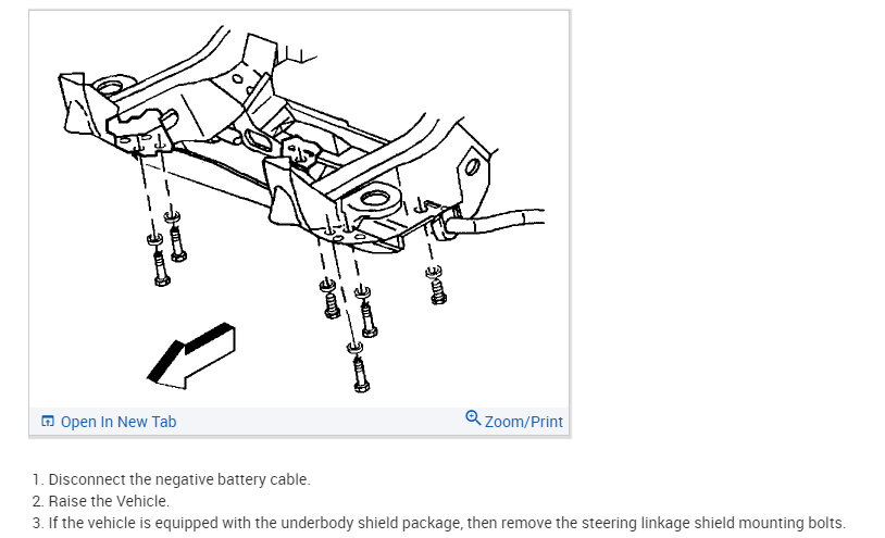

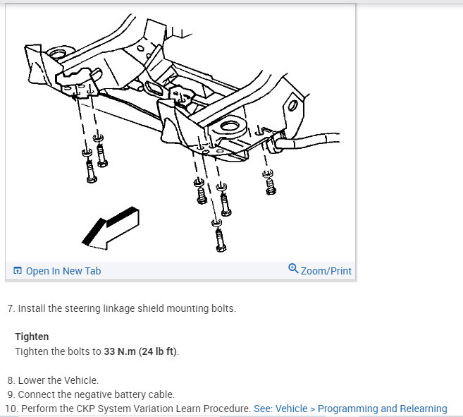

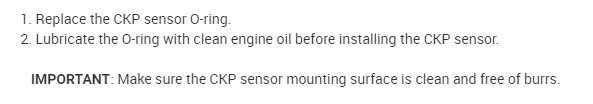

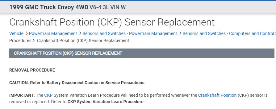

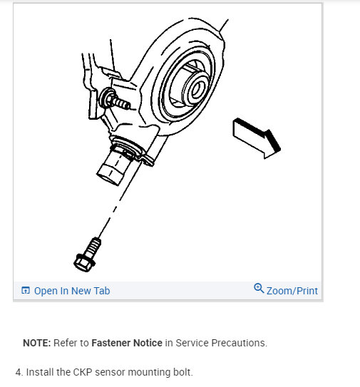

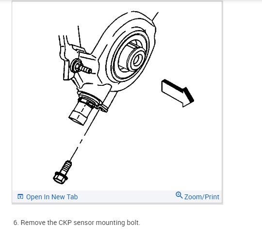

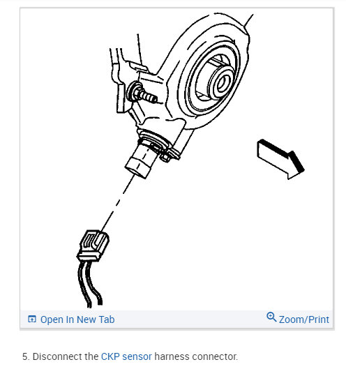

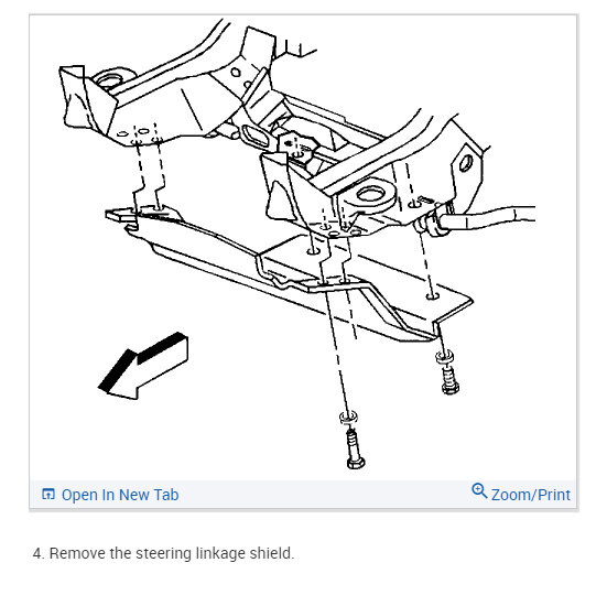

At this point, it may be a good idea to replace the crankshaft position sensor. I attached the directions below specific to this vehicle. Note that it says you need to perform a variation relearn after replacing it, but that will not prevent it from starting and running.
