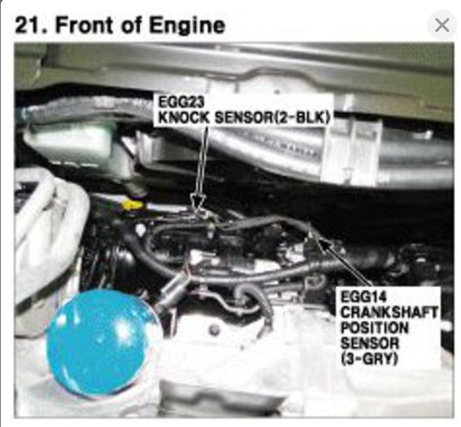

Water pump failed, bearings shot. Broke the serpentine belt. Had the vehicle towed home. Replaced the water pump and serpentine belt. Added coolant and would not start. Battery drained flat. Checked battery all is good just drained. Charged battery and car still will not start. It turns over but that's it. Had no other issues prior to this.

Clearly just doing the water pump would not cause this so we need to inspect around the engine and make sure there is not something left unplugged. Next thing is to find out if we have no spark or fuel causing the no start. Clearly the starting circuit is okay as it cranks but we need to find out which we don't have.
Check the crank sensor and make sure that is plugged in as well. That would be the leading sensor causing this.
To find out if you have no spark or fuel is to pull a plug ad hold it against the block then crank the engine. Then use starter fluid in the intake to see if starts with that.
Lastly, we need to check for the security light and make sure that turns off when you turn the key.
Let's start with this and go from there. Thanks
