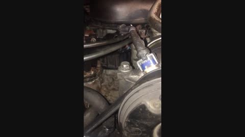

Just finished replacing the air manifold gasket and now the truck won’t start. I don’t know if it’s the the cables or if it wasn’t properly done or if it needs to be primed before starting again. the video shows how it sounds after I had finished.

I'm assuming that you mean the intake manifold gasket. Even if this gasket was still leaking your vehicle should start. It would run very badly with a high or more than likely a surging or "searching" idle, but it would start. Can you please double check that you have not left a component such as the idle air control[IAC] valve, Camshaft Position Sensor[CMP] or Crankshaft Position Sensor[CKP], Manifold Absolute Pressure[MAP] sensor unplugged or have wires that somehow got pinched for us. Please get back to us with what you find out, and we can go from there if needed.

I have messed with the distributor could that be it and if so how do I set the timing?

I figured it out! It was the wire that leads to the distributor I hadn’t plugged it in. thanks so much.
