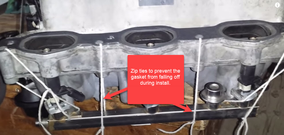

I'm sure you have done it, but the first thing that I do is check all of the connectors because this engine as well as most modern engines, will have several electrical connectors that can easily be either forgotten or not fully engaged. Also the intake gaskets can fall off during install (see picture), some technicians will tie strap the intake gasket to the intake before installation, or use spray tack before attaching the gasket to the intake.

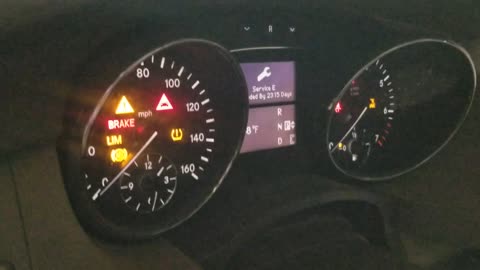

I used 3m spray tac to hold the gaskets. I agree it should be a plug, I have gone over them multiple times. I got it to run for about a second. It's not throwing any codes either. I would be looking at timing, but it ran before I did the work. The car had very little power, that's why I was repairing the manifold. But it did start every time with no problem.Have a listen in the attachment.

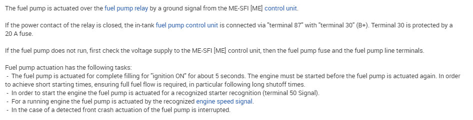

I have 52 Psi at the rail, With a fully charged battery it turned over enough to stop the auto start and ran on it's own for about 1 second. Tried starting fluid and was worse. Could have been because the battery was drained down a little. Only thing that is weird to me is there is no fuel pressure until you turn the key to start. Still no codes. No way I missed a plug. Only thing I can think to do is remove the manifold again.Timing makes sense but it ran before I did the work.

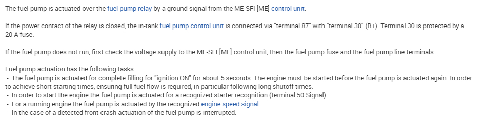

I've attached an operation description of the fuel pump circuit so you can get a clear understanding on how the circuit works. I agree that the next logical step would be to remove the intake, at least that's what I would do.
