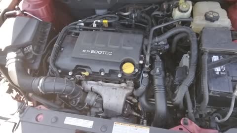

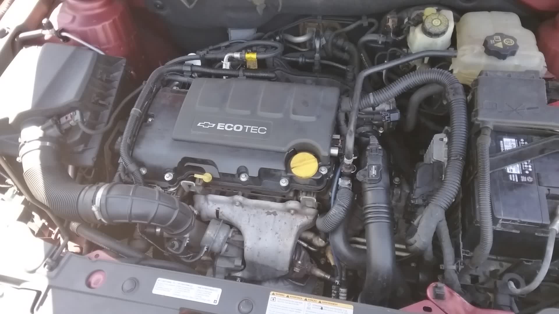

Hey there, the wife drove the car and it overheated. We found out the water outlet was bad. After replacing it now the motor turns over but won't start? It doesn't sound like it's firing.

Can you make a short video of the engine cranking over so I can hear it? You may have lost compression and I can tell by a video. In the meantime, let's do a compression test if you don't what to send a video.

Hello Ken, I took a video for you. Also, it's getting gas. I checked the bleeder valve. It seems like it's electrical. Not getting fire. I appreciate your help and look forward to your reply. Attached is the video.

Yep, there is no need to check the fuses or relays, that engine is no good. Thanks for the video, it helps. You will need a used/rebuilt engine, sorry about that.
