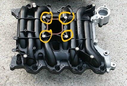

Hey Joe, I tightened intake with a regular 3/8 socket wrench because I don't have a torque wrench, but I did take the throttle body off today and noticed that the 4 screw points on the intake where the throttle body screws to the intake are coming out of the intake can this be fixed or do i need a new intake all together? If you want or need pictures of what I described just let me know. Thanks.

Is it possible to get a few pictures? Do you mean the screws have gone through the manifold?

No, I don't think the screws went through the manifold, I circled the points that are starting to come out of the manifold.

It's really hard to tell in the pics, but they still appear to be okay. Even if one or two of them had a slight leak, it should have still run.
The only thing I can say is to reinstall it, make sure the gap is no longer present, and see what happens.
If it doesn't start after reinstalling it, we need to go in a different direction.
