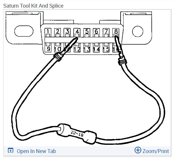

I tried to add a new remote and followed the steps for programming. Now neither remote work and the lights on the dash illuminate but the car will not crank.

To program the Remote Keyless Entry (RKE) module with a new transmitter, use the following instructions:
1. Have all the transmitters that will be programmed to the Saturn present, even if only one is new. Put your key in the ignition, and keep it in the OFF position.
2. Locate the Data Link Connector (DLC). It is fastened to bottom of the left side of the trim panel under the steering column.
. Use a jumper wire to provide a path from the remote keyless entry System program circuit (cavity 8) to ground (cavity 4).
Use an available Saturn lead kit and splice. to create a jumper wire as shown.
Grounding the program circuit causes the horn chirp. Count the number of horn chirps. The number of chirps wilt correspond to the mode the RKE module is in.

Thank you for your response. My son traced the problem to a blown fuse (on the body circuit) and was able to get the remote programmed and the car started.
