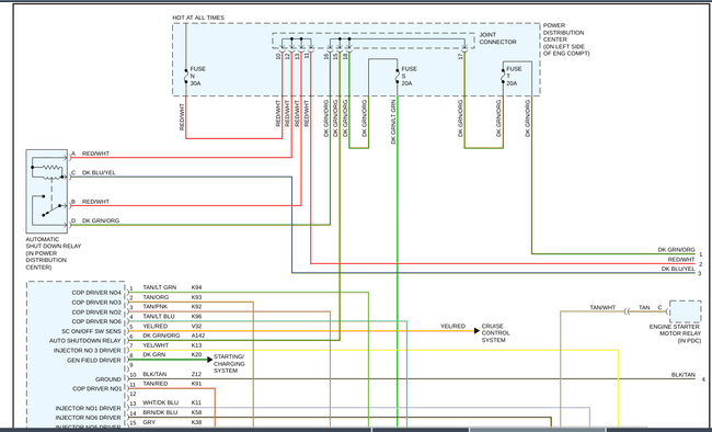

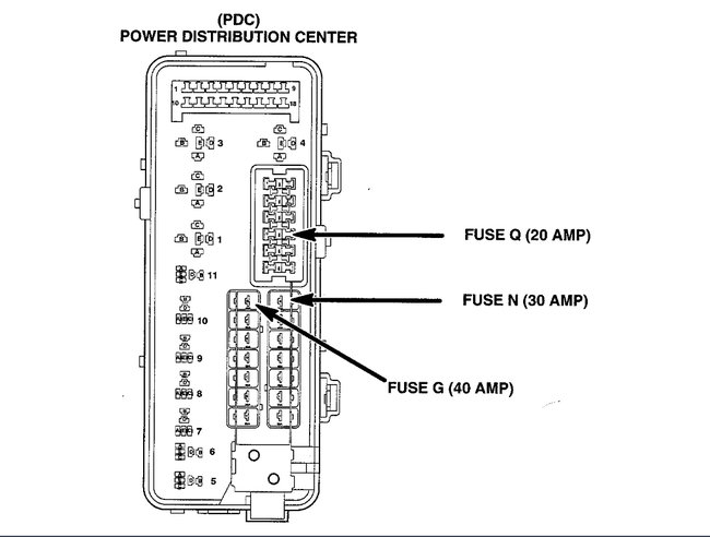

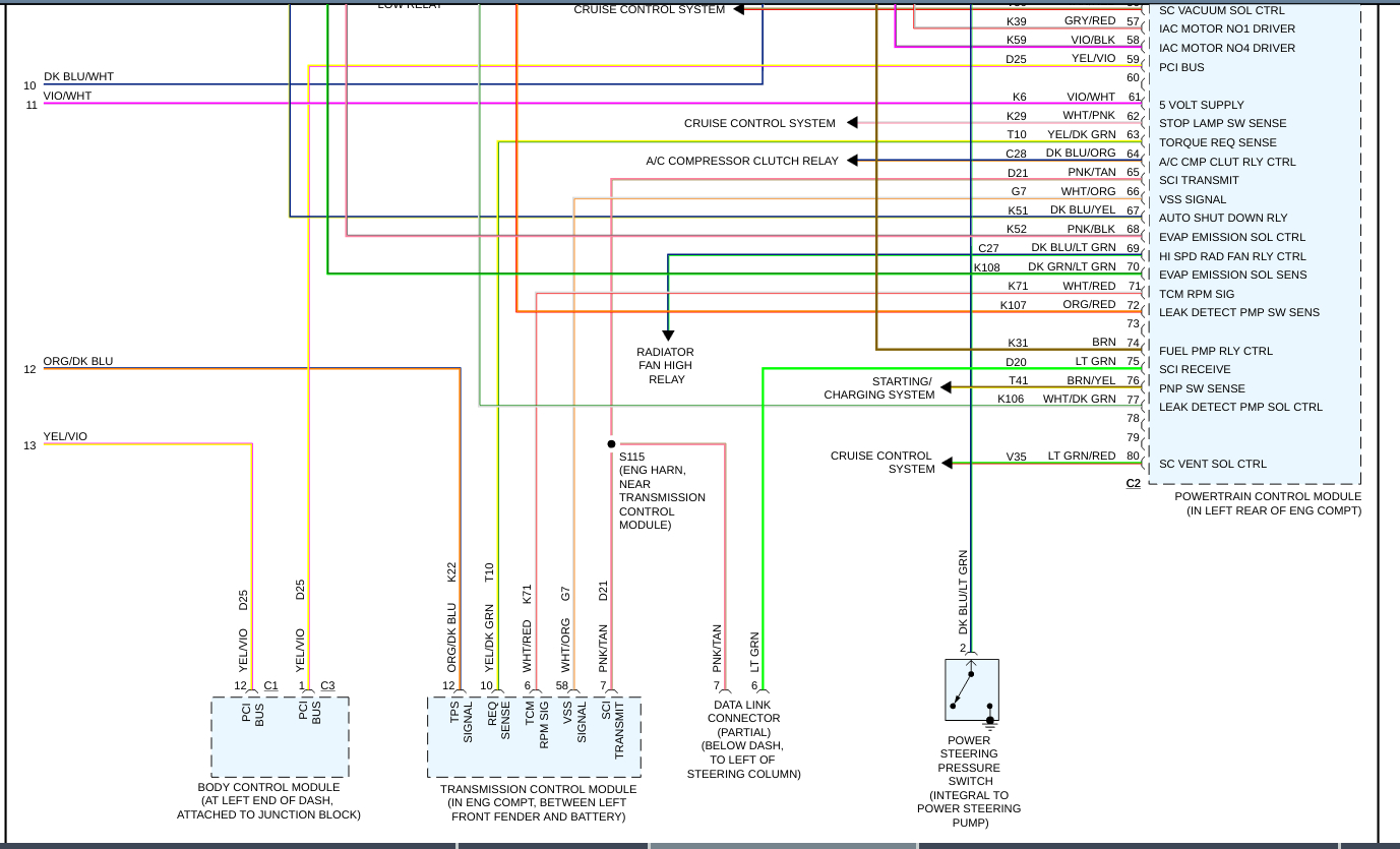

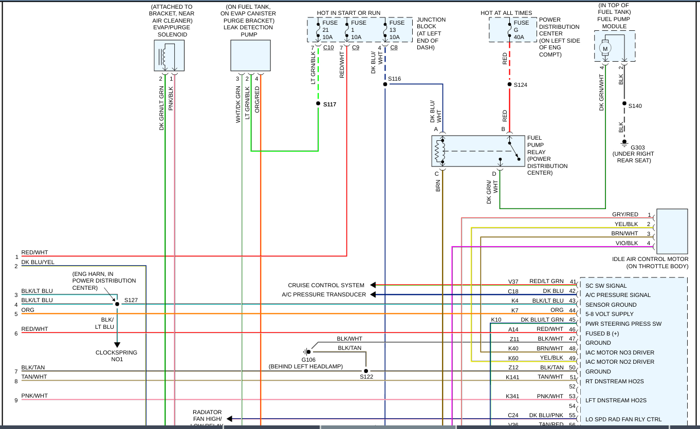

The car will crank but will not start after I changed the spark plugs. It ran good beforehand. All I did was remove coils to very top the spark plugs. Replaced plugs, put coils back on, and plugged them in. Now it won't start at all. I have changed spark plugs in hundreds of vehicles and never had this problem. Someone, please help.
Dec 4, 2019 at 6:12 AM
SCGRANTURISMO
  • 4,897 POSTS

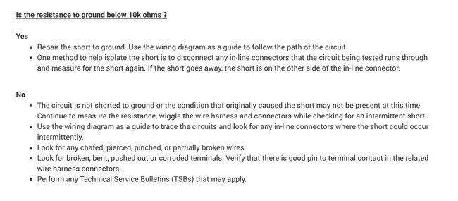

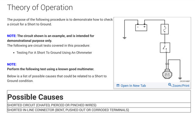

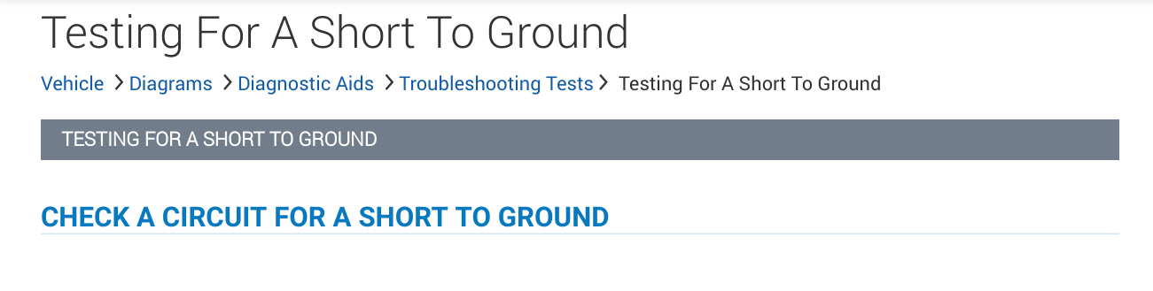

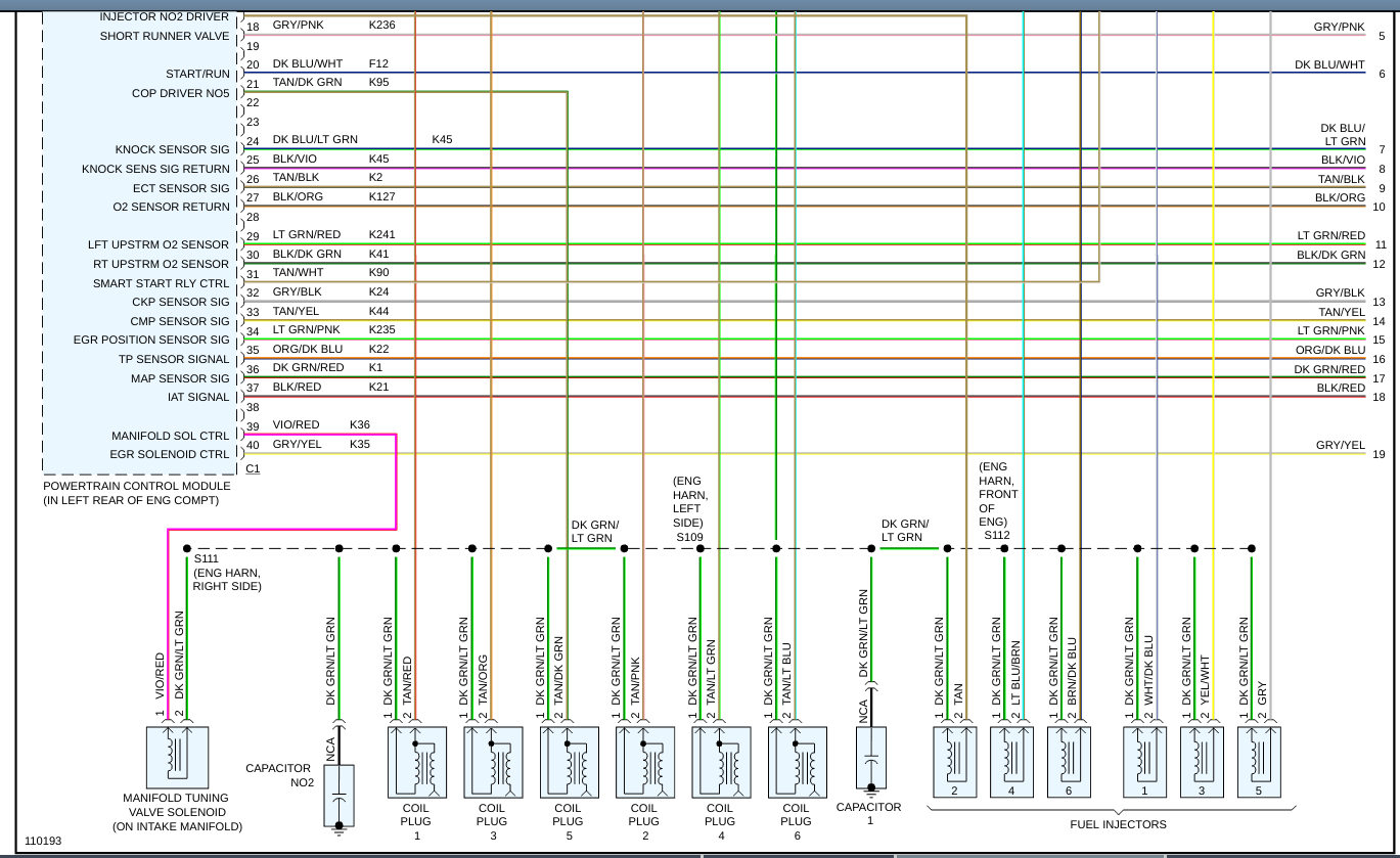

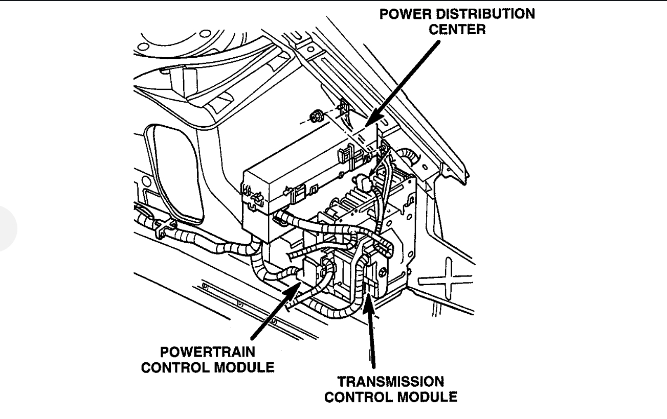

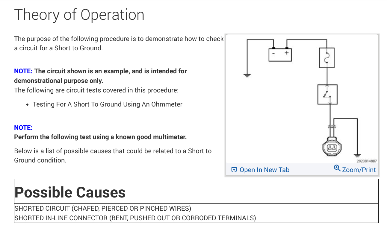

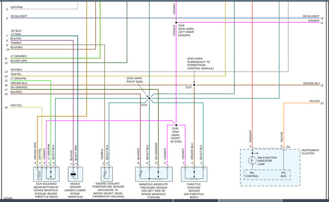

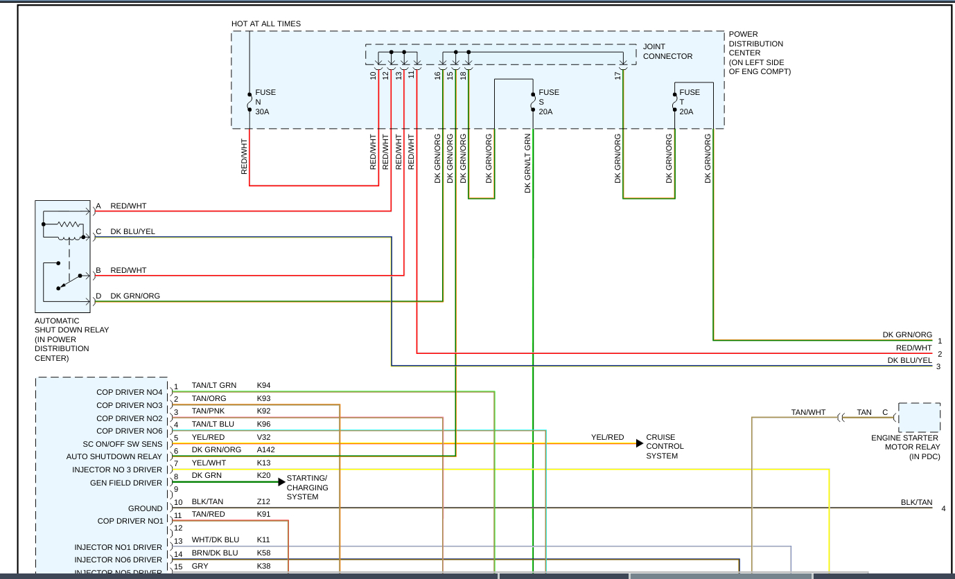

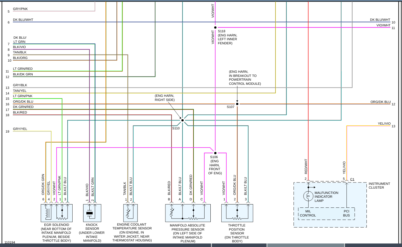

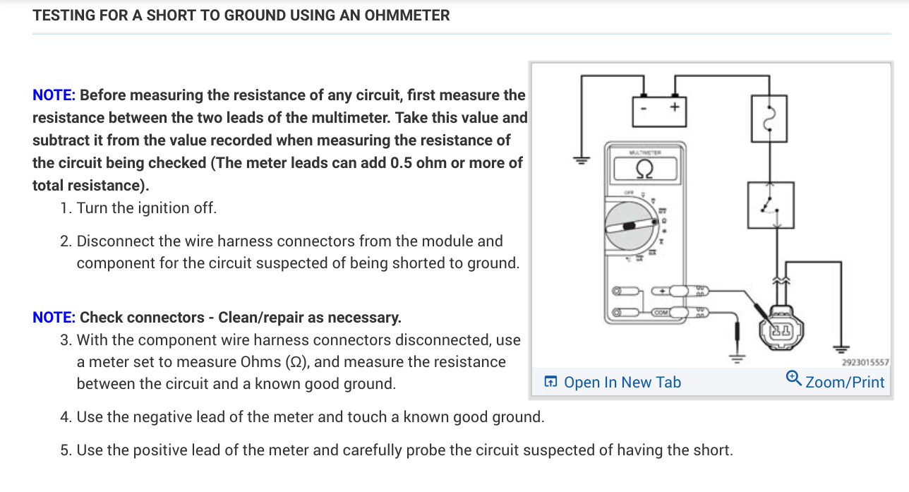

This could be a couple of different things here. First off could you please check Fuse N in the Power Distribution Center PDC], or the Under hood Fuse Box in your vehicle. In the diagrams down below I have included a diagram with the location of the PDC, a diagram with the location of Fuse N, and finally the wiring diagrams for your vehicle's Engine Management circuits and a guide for how to find short to grounds in an automotive electrical circuit. Please go through these guides and get back to us with the status of Fuse N, and we will go from there.
Thanks,
Alex
2CarPros
Dec 4, 2019 at 5:13 PM
RUSS1961
  • 7 POSTS
Thank you for all the information. I checked fuse N, and it is good.
Dec 5, 2019 at 5:41 AM
RUSS1961
  • 7 POSTS
Any idea about what I can check next? All the fuses seem to be good.

Hello again,
Sorry for taking so long to get back to you. Okay, so fuse N is good, so next can you please check the Auto Shut Down [ASD] relay for us. It is located in PDC. Here is a link below explaining how to test a relay, if needed:
Please check the relay and get back to us with how everything turns out.
Thanks,
Alex
2CarPros
Dec 7, 2019 at 11:14 AM
RUSS1961
  • 7 POSTS
I just checked the auto shutdown relay with the help if my neighbor and it does click.

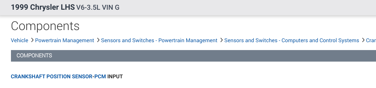

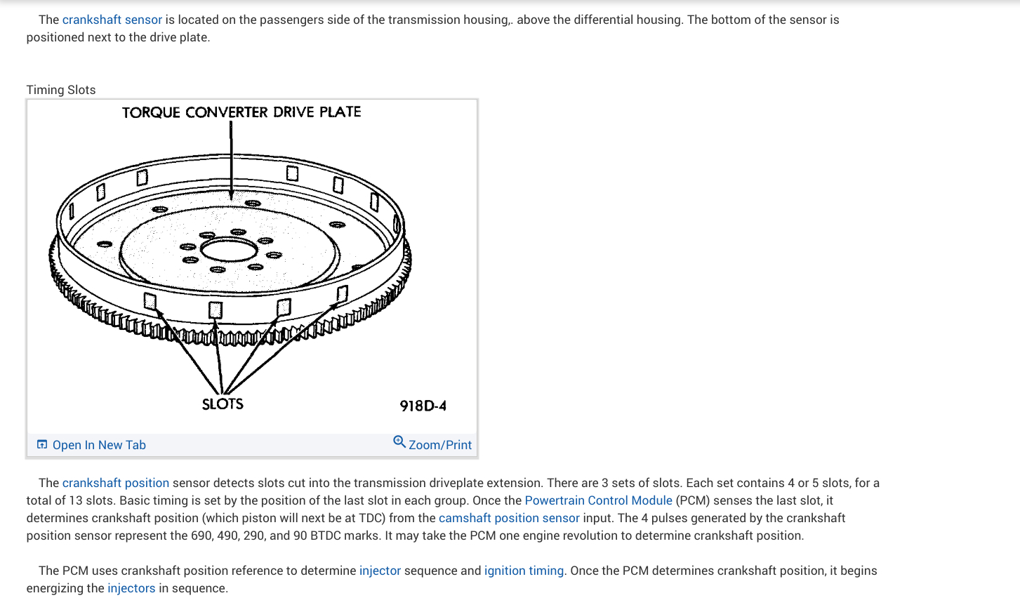

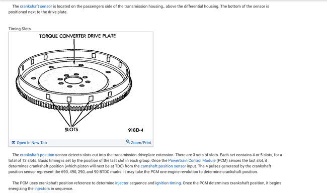

Hello again,

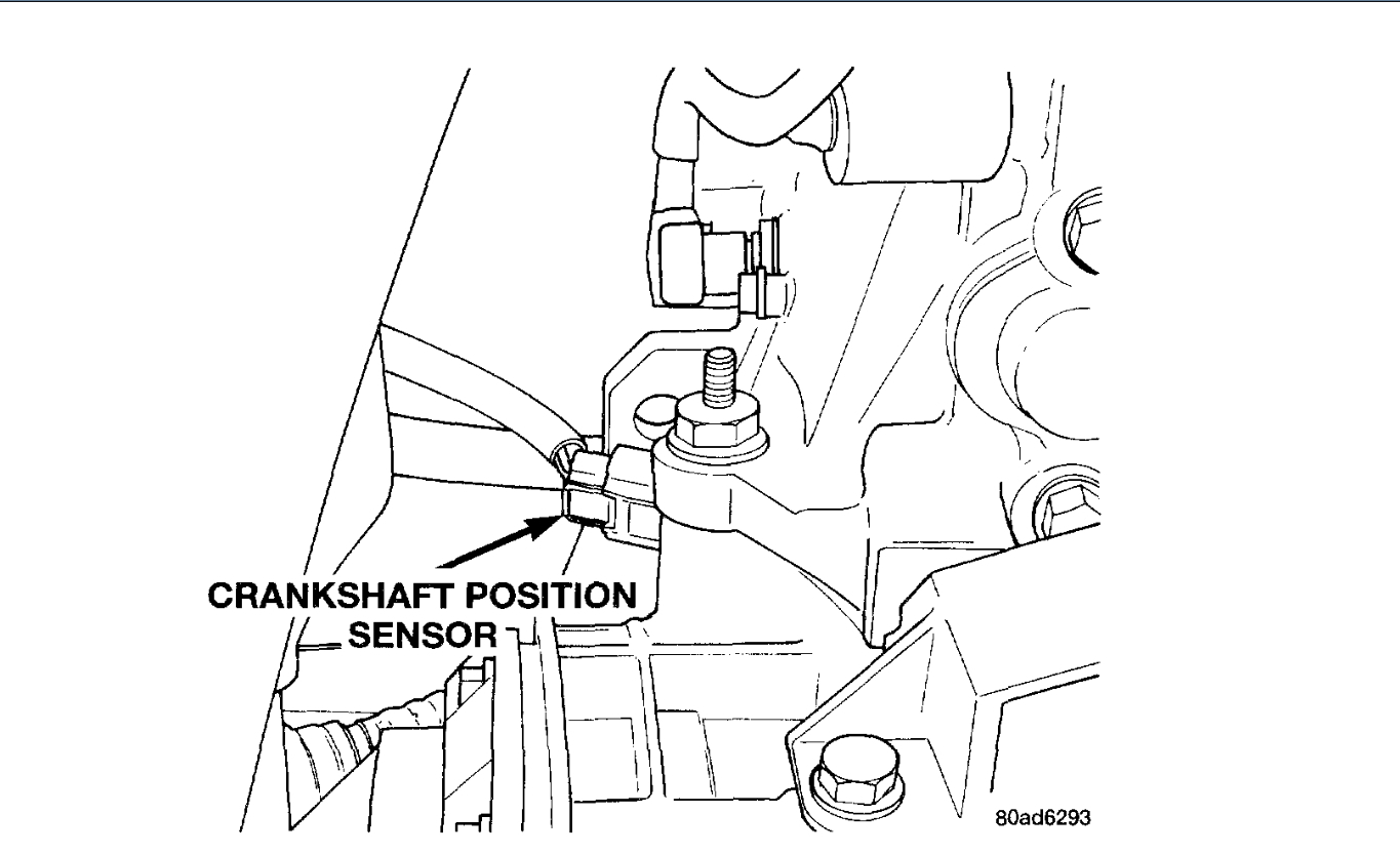

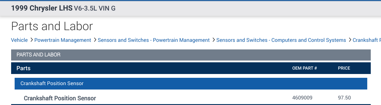

Okay, so the next thing that we want to check is the Crankshaft Position Sensor [CKP]. In the diagrams down below I have included a description along with a diagram of the CKP location of your vehicle. Here is a link explaining how to remove and install a CKP in a vehicle:
Please go through these guides and get back to us with what you are able to find out.
Thanks,
Alex
2CarPros
Dec 8, 2019 at 6:21 AM
RUSS1961
  • 7 POSTS
Sorry it took me so long. I checked the crankshaft position sensor the way it said on that link you supplied for me and it seems to be working correctly. Also, I just wanted to add, before I changed the spark plugs the alarm would always sound whenever I would disconnect and reconnect the battery, but now it doesn't. Does that mean anything?

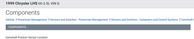

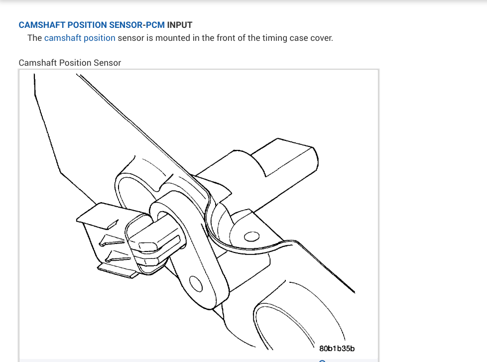

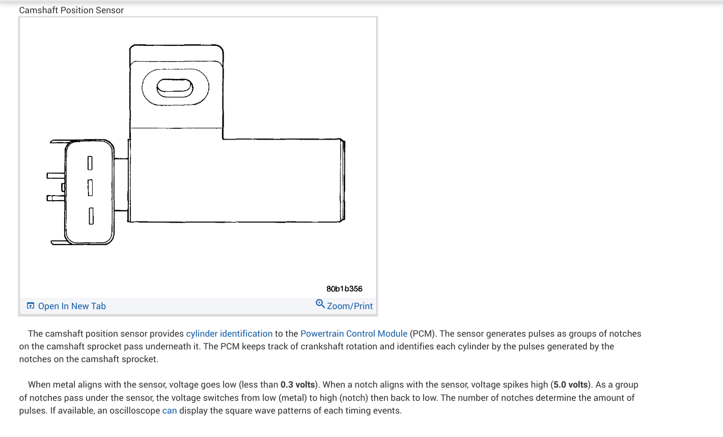

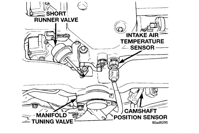

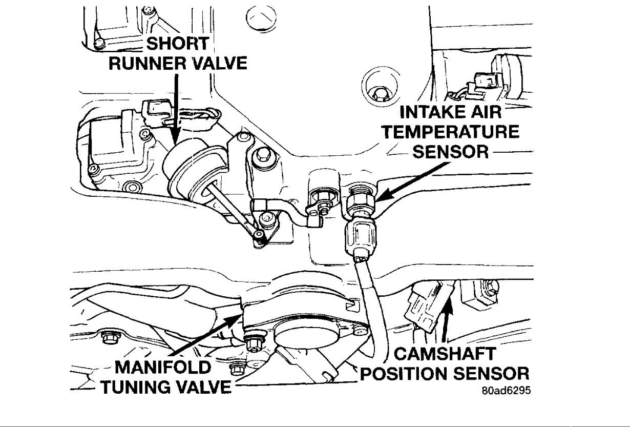

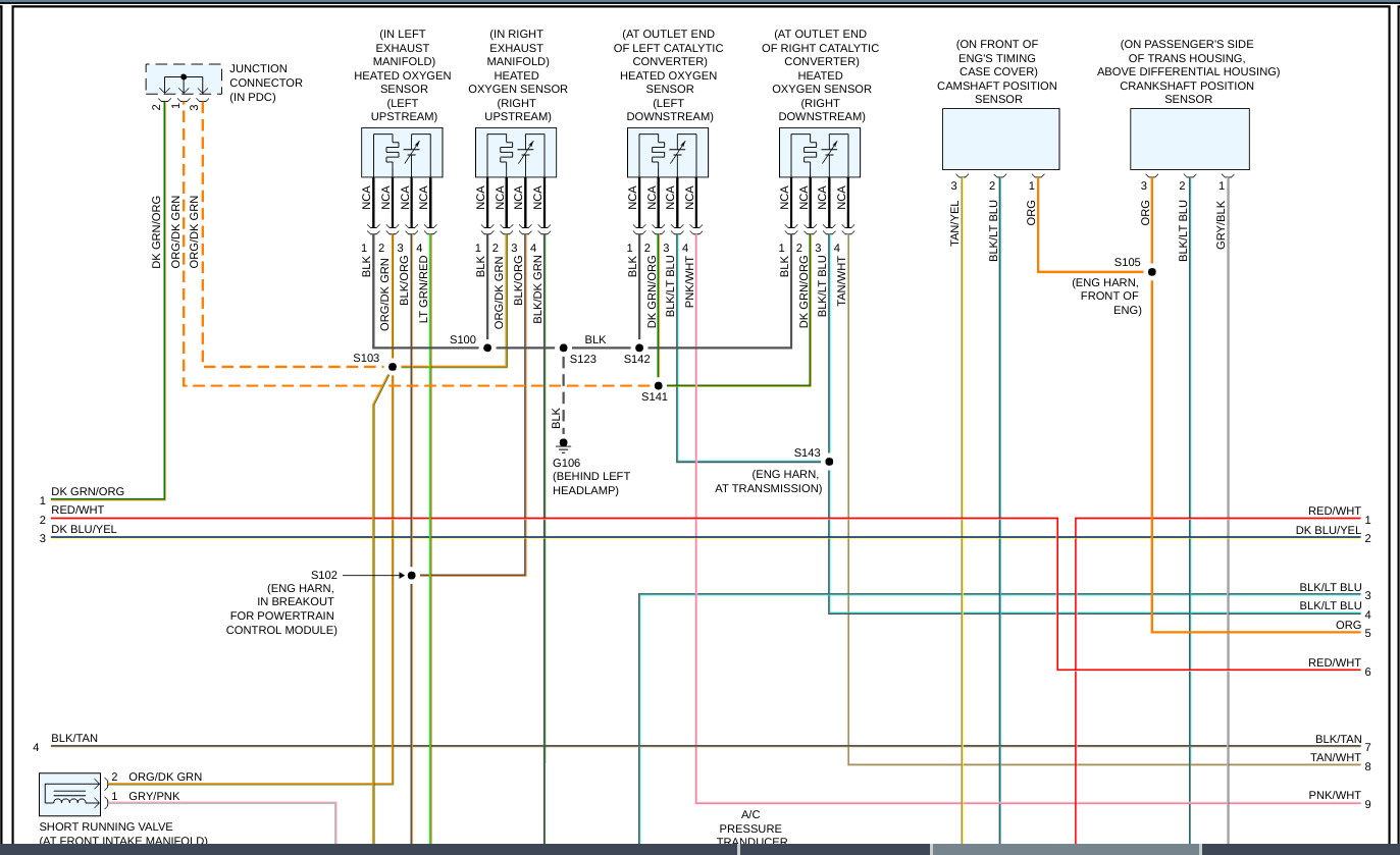

Hello again,

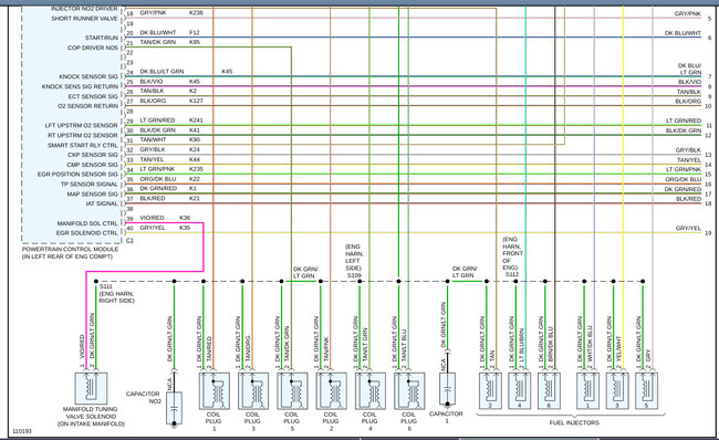

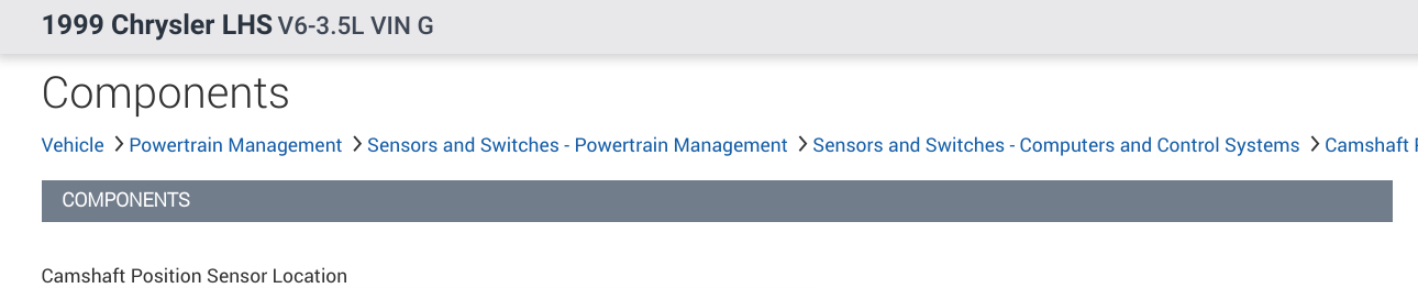

Okay, it's fully charged. So, next let's check the Camshaft Position Sensor[CMP]. In the diagrams down below I have included a guide explaining the CMP operation, complete with diagrams showing it's location. Please inspect the electrical connector and wires for damage and replace the CMP. Get back to us with how everything turns out, please.
