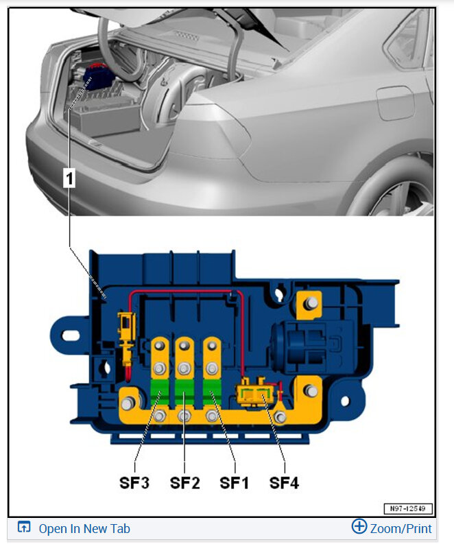

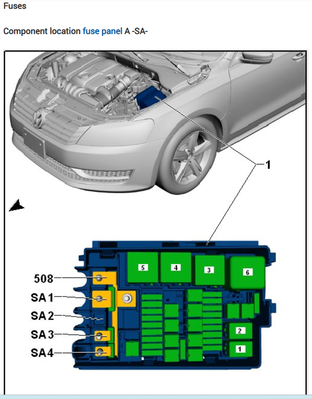

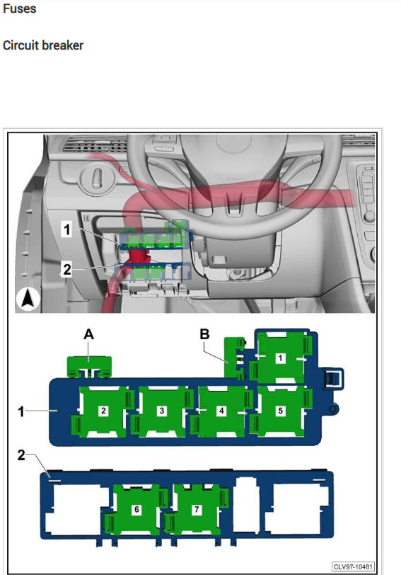

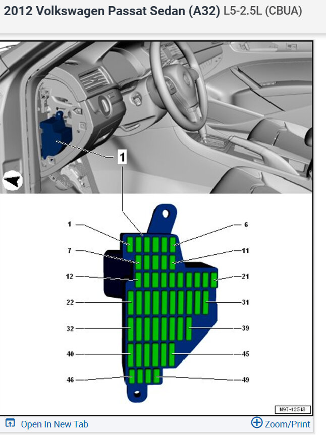

Yes, that can be, but usually the wires don't burn, it pops fuses and blows out modules, I would turn the systems on and then recheck the fuses, this guide will help:
Also, did the scan give you any code numbers? If so what are they? Check out the images (below). Please let us know what happens.

I checked all fuses and relays in the engine compartment and fuses on the left side of the driver's seat. I replaced a few fuses in the engine compartment, including the multifuse. These tasks were done before I tried the scanner. I will check all fuses again to see if they are still ok. I did not see the fuses and relays that you show above in the trunk and under the steering column. I will look for them again.

Dear Ken, I was able to partially access the electrical panel nearest the steering wheel. The two components I could get to without removing the entire dash are a 506 (part 561907413) and 507 (part 7N0951253). They were the parts closest to the floorboard. The 507 has a circuit diagram on it, but the 506 does not. I'd like to test the 506, because I think it may be bad. The terminals on the 506 have a cloudy white surface, unlike the shiny terminals of the other relays. Also, I can't find a parts dealer with the 506 relay in stock. Any advice? Thanks!
