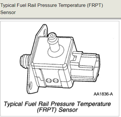

Hello, I hope someone can help me on here. I have the car listed above (TDCI), the battery has been on its way out for a while now and we have had to jump start it a few times. So I changed the battery today but it still will not start. It is turning over now, I think it is a fuel issue, or I need to reset something.
Can anyone help?
Thanks, Chris

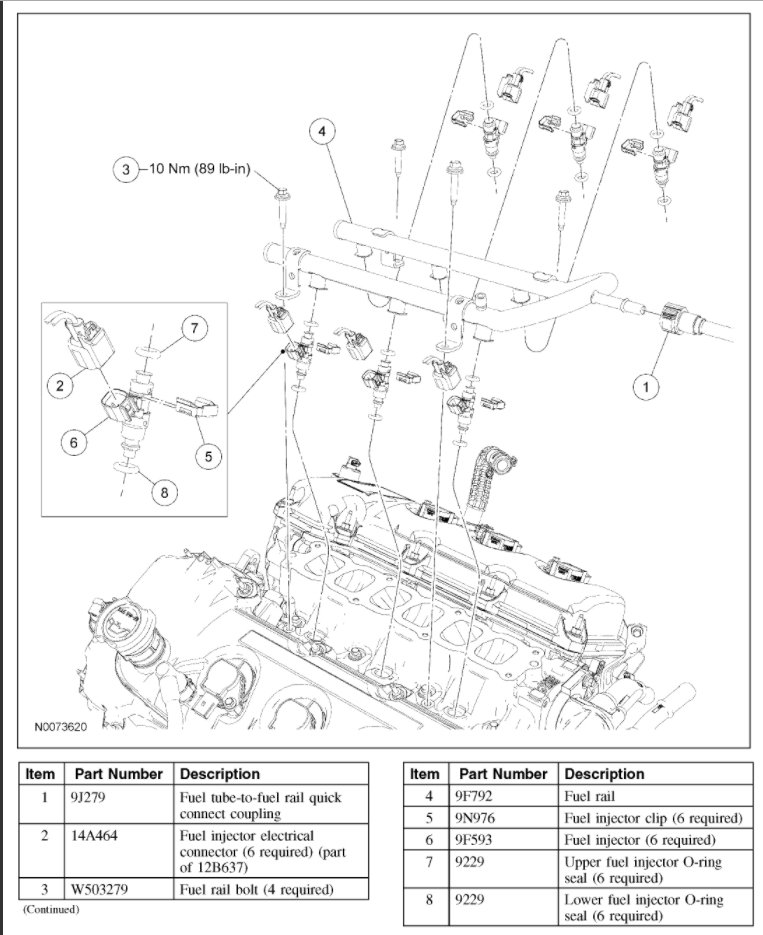

Ya, yes the old fuel pressure circuit high code. Sounds like you need a new fuel pressure sensor. Here is a diagram to help you see how to do the job.
The sensor location should be up by the fuel rail.
