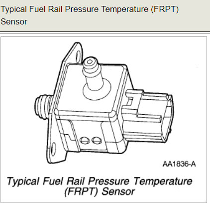

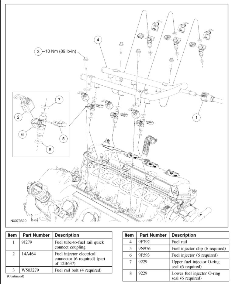

I did have eleven fault codes come up when I plugged my obd2 scanner in. I cleared the faults on the ECU hoping this would fix it but it has not. There is only one fault code left when I checked again 'P0193'.
Feb 20, 2018 at 4:09 AM
  • 55,423 POSTS
Ya, yes the old fuel pressure circuit high code. Sounds like you need a new fuel pressure sensor. Here is a diagram to help you see how to do the job.
The sensor location should be up by the fuel rail.
