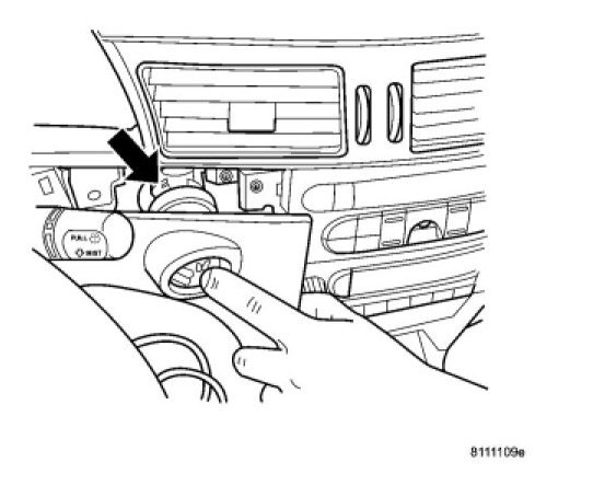

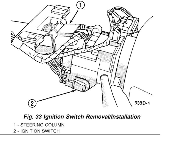

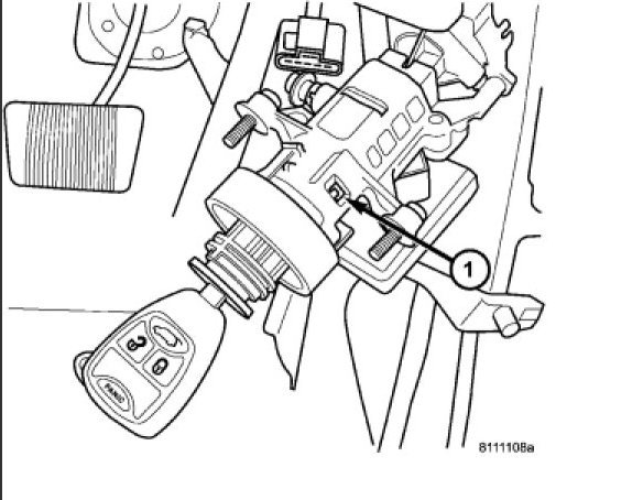

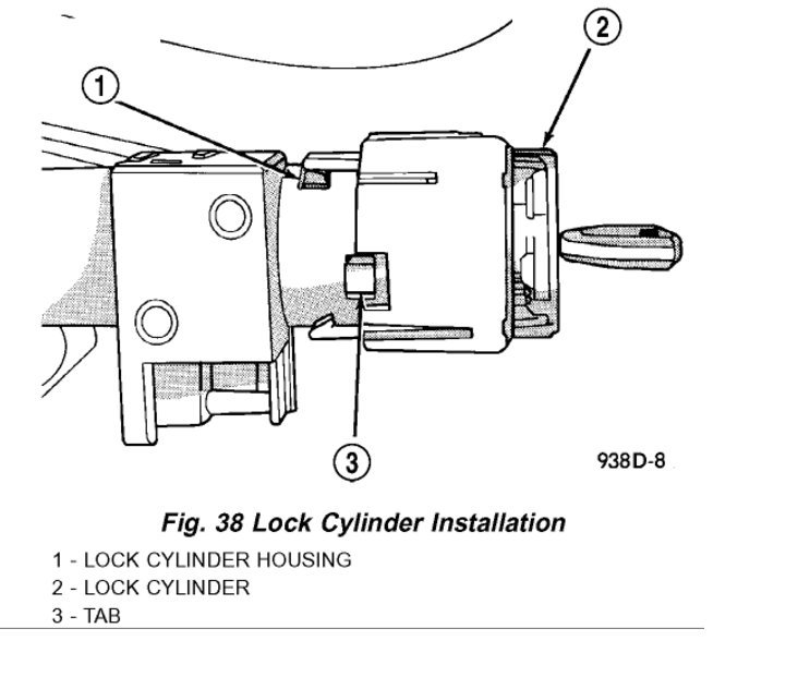

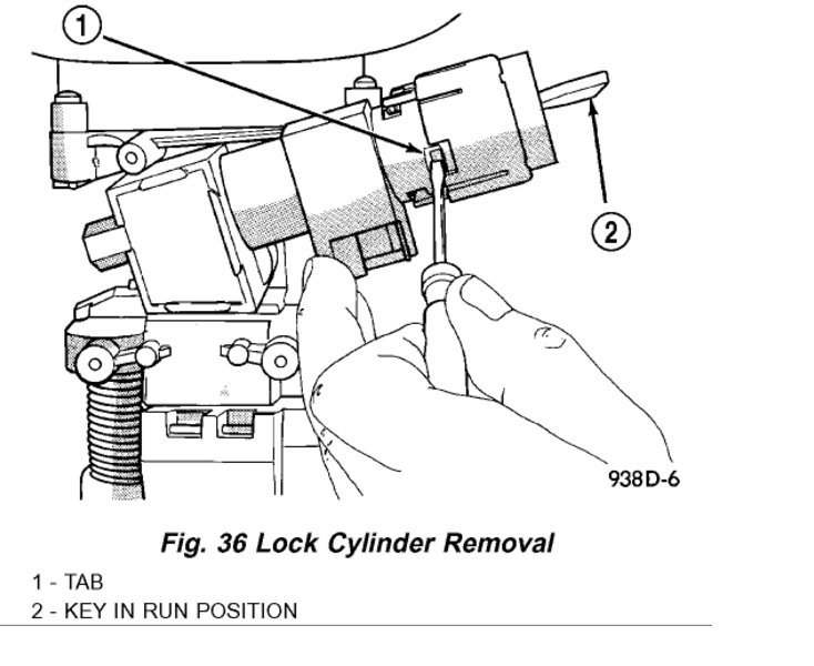

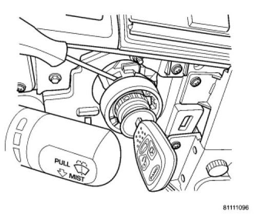

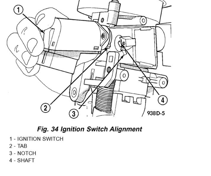

My key lately i have been having to turn it real hard to get started the actual ignition part feels a little loose. All power comes on but ounce key goes to start position nothing.
Jul 19, 2017 at 11:51 PM
  • 55,797 POSTS
It does sounds like you have an ignition switch that has gone out. Here are some diagrams to help you get the problem fixed. You may need to have the key recoded to have the car start as well.
