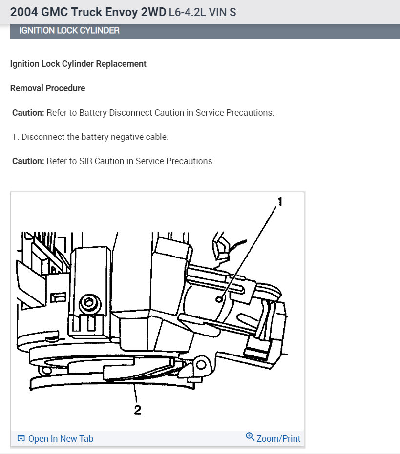

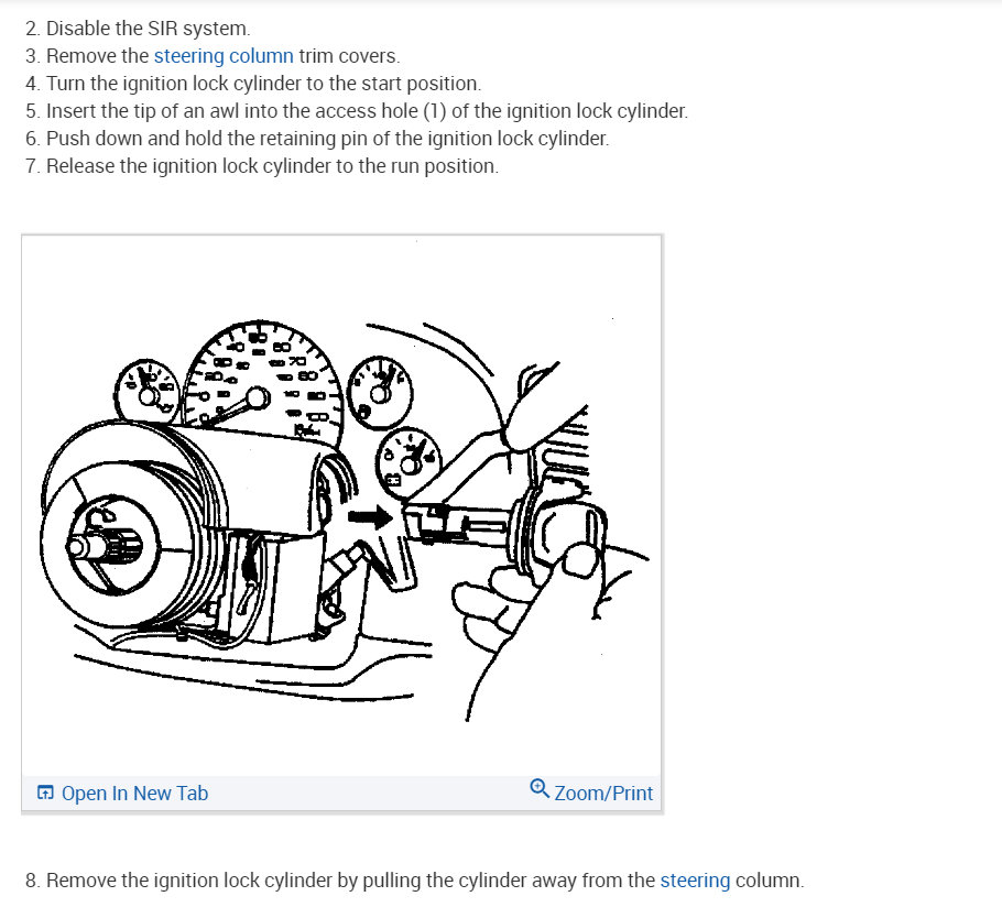

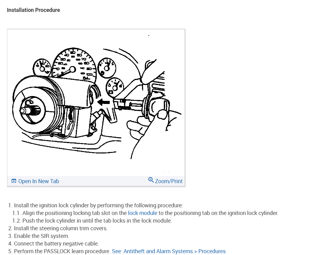

Is the security light flashing? If so the key is not programmed correctly to the car, here is how the job is done in the images below. I always purchased the parts from the dealer which can program the key before you install it. Have your VIN number ready.
Here is the reset procedure:
PROGRAMMING THEFT DETERRENT SYSTEM COMPONENTS
