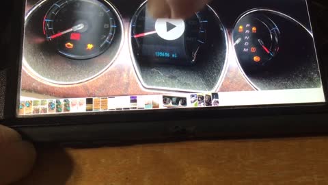

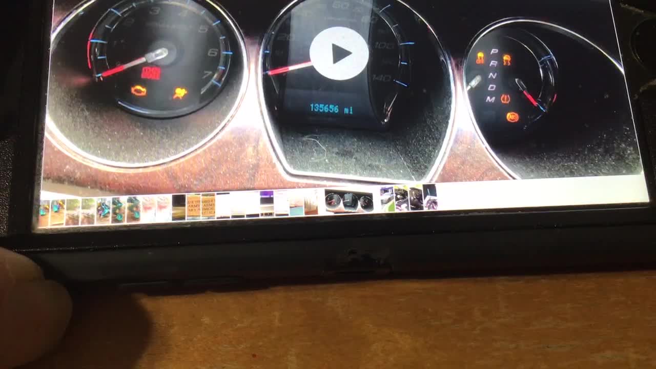

All the dash icon lights in my car come on when I’m driving. Then an alarm sounds, and the cycle starts over again. It doesn’t stop while I’m driving, but it won’t turn on after I turn it off for days at a time. It would start again in 15-30 minutes when it first started happening about a year ago. I have a video of what it is doing.

Can you please upload the video with your response? Also does the engine crank over or can you hear the engine cranking, but it doesn't run? These guides can get us started but the video would be best to help us fix the car for you:
or
Do the lights stay bright when you go the start the car? It could be a battery that is getting weak, please let us know.
May 16, 2022 at 3:14 AM
ROADKING1999
It doesn’t crank at all lights stay bright.
May 16, 2022 at 5:01 AM
  • 55,433 POSTS

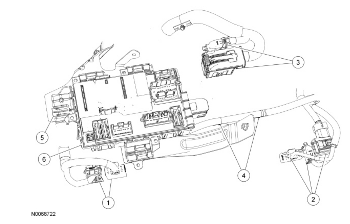

What is the light blinking on the left? I can't see it from the video, is it a security light? I have seen this problem before and it ended up being the smart junction box on the left kick panel, sometimes they get water in the box or the wiring connectors which will cause the issue as well, but to be sure we can run a CAN scan which is easy to do. Please watch this video and read the guide to show you how. I have also included how to change the SJB out in case it is the problem after the scan so you know what you might be in for.
Check the diagrams below
Removal
NOTICE: If the Smart Junction Box (SJB) is dropped, damage to the internal components may occur. A new SJB must be installed.
NOTICE: Electronic modules are sensitive to static electrical charges. If exposed to these charges, damage may result.
NOTE: Prior to the replacement of the module, it is necessary to upload the module configuration information to the scan tool. This information must be downloaded into the new module after installation. For additional information, refer to Module Configuration See: Information Bus > Testing and Inspection. In the event that As-Built data is required (the SJB does not communicate), all Remote Keyless Entry (RKE) devices must be programmed to the new SJB. A minimum of 2 devices are necessary to complete the configuration and turn off the flashing interior lights.
NOTE: The Tire Pressure Monitoring System (TPMS) functionality is integral to the SJB.
NOTE: The steps included in the SJB removal and installation procedure are critical to restoring the vehicle security and the TPMS to normal operation. A new SJB is delivered in a manufacturing mode with 8 pre-set DTCs related to the TPMS. To clear the DTCs, successful configuration of the SJB must occur, followed by successful TPMS sensor training, and a successful self-test, including clearing of the DTCs. The DTCs are as follows:

1. NOTE: This step is necessary only if the SJB is being replaced.
Upload the module configuration information from the SJB. For additional information, refer to Module Configuration See: Information Bus > Testing and Inspection.
2. Remove the steering column opening trim panel. For additional information, refer to Instrument Panel and Console See: Dashboard / Instrument Panel > Removal and Replacement > Instrument Panel - Exploded View.
3. Disconnect the SJB electrical connectors.
4. Remove the 2 harness pushpins from the SJB.
5. Using a suitable tool, lift the SJB release tab (away from the SJB bracket), slide the SJB (wiggling it to the left) and remove.
6. Disconnect the SJB B+ (battery lead, part of the 14290 harness) connector.
7. If necessary, remove the 3 nuts and the SJB bracket.
