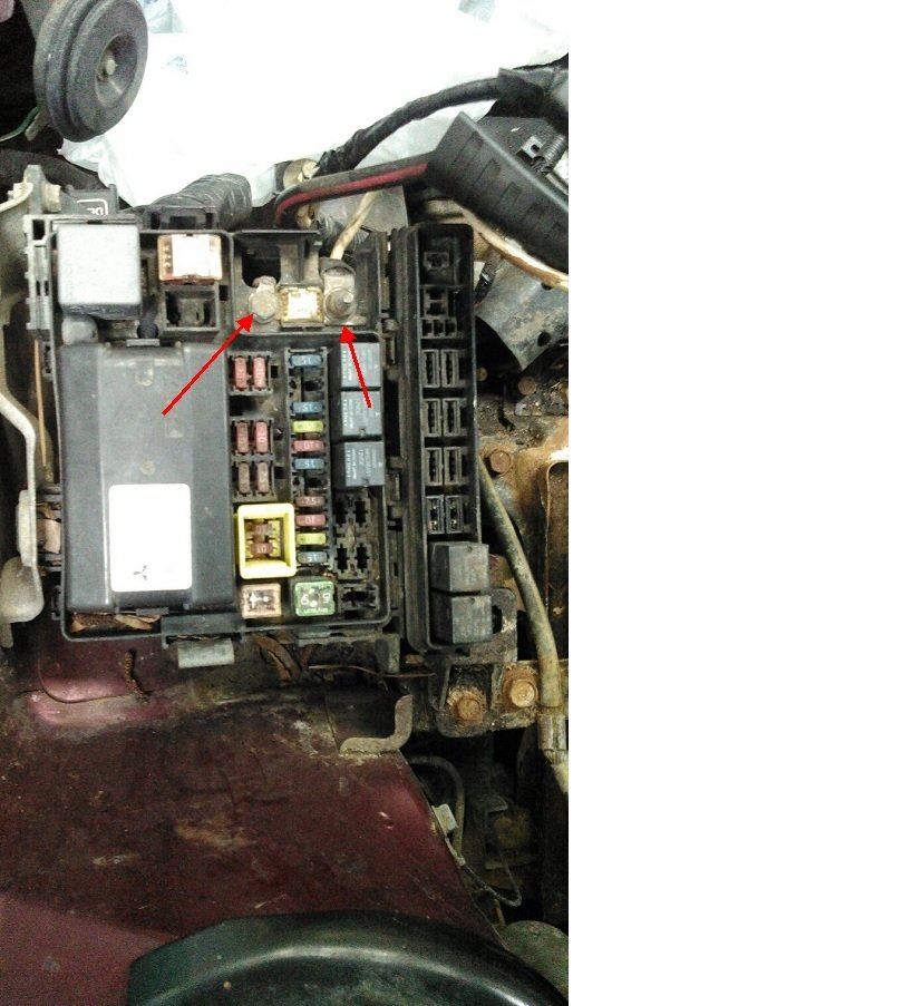

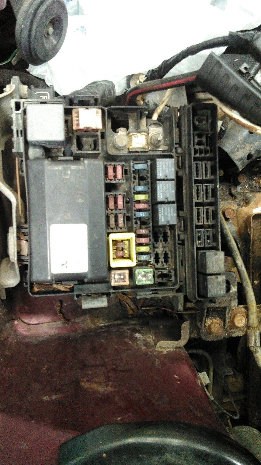

Drove this car home, got up next day would not start. replaced starter, thought might be starter relay. Cannot find fuse box that looks like mine. lights work, battery okay, sometimes dash lights come on until i try to start car then go out. sorry about the first three images the fuse box is the last one.

Here is the clue:
"sometimes dash lights come on until I try to start car then go out"
If you mean the dash goes dead, that is not a starter system problem. Follow the smaller positive battery wire to the under-hood fuse box and be sure that connection is clean and tight.

I am playing with and learning this miserable Windows 10, and I finally found MS Paint so I can save pictures in a jpeg format. Here is the results of my practicing. Check out my nifty red arrows!
