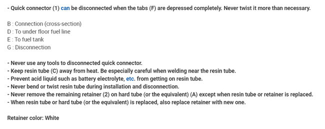

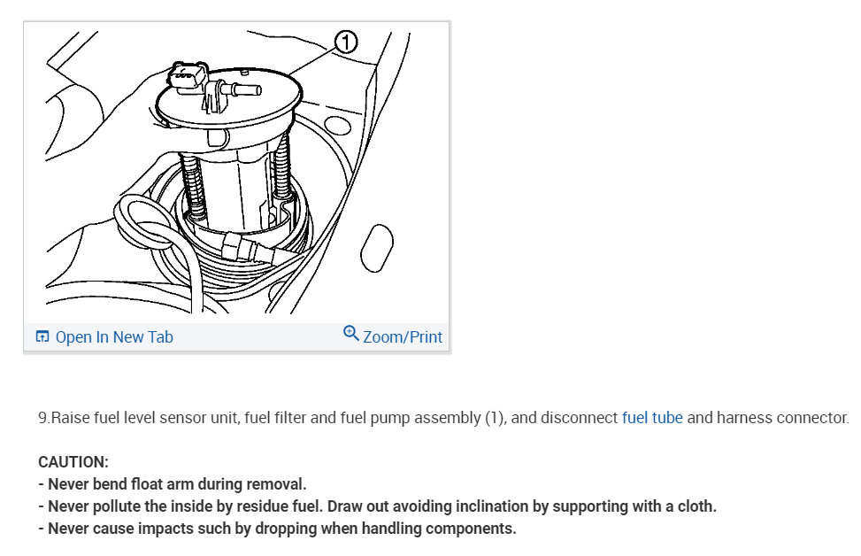

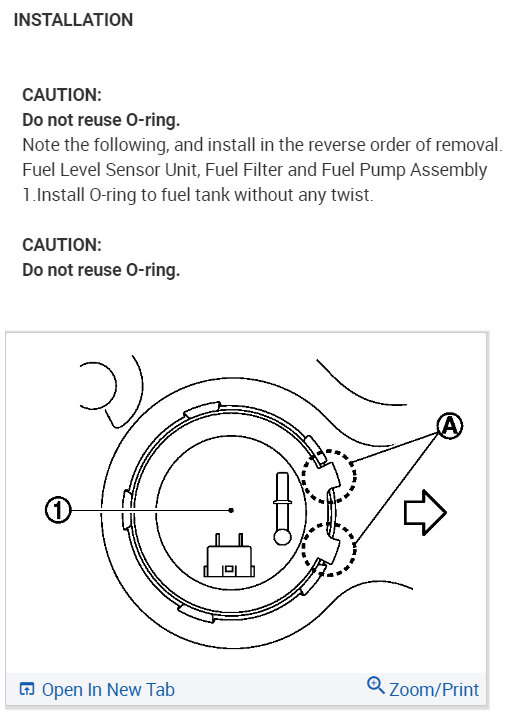

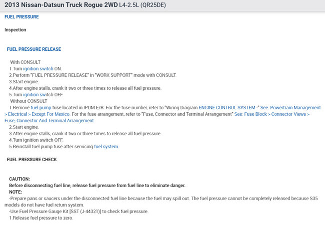

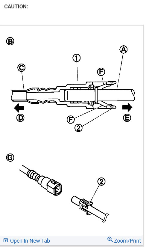

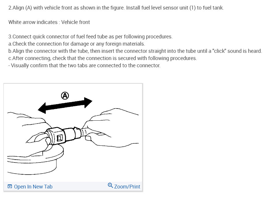

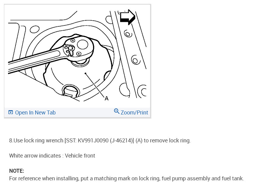

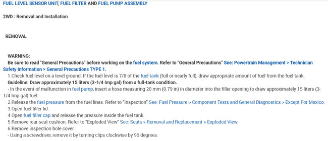

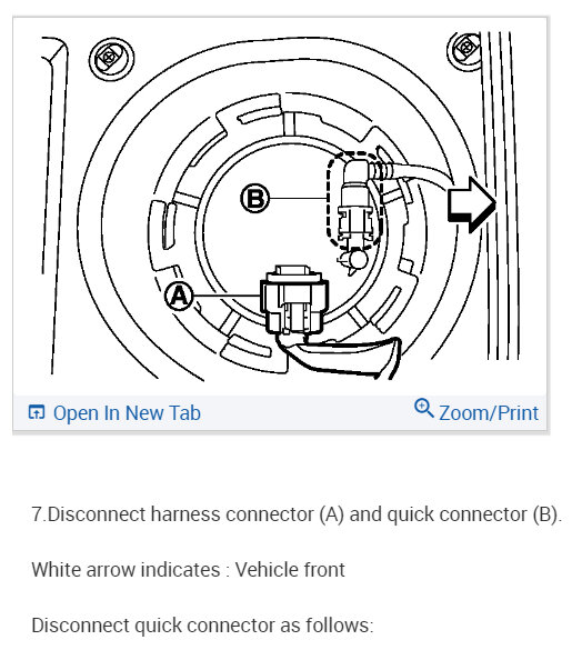

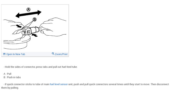

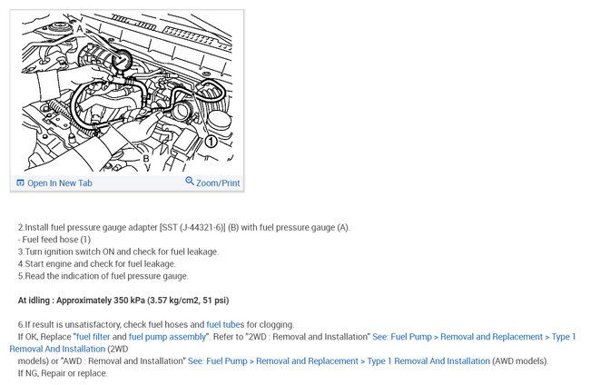

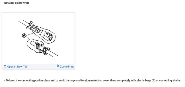

This is typical when the fuel pump heat soaks it will not build pressure as it should. To be sure when it won't start, we can do a fuel pressure test which you can rent a gauge from the auto parts store for free or cheap. Here is a guide to help walk you through the steps and instructions on how to test your vehicle in the images below.
At idling: .................... Approximately 350 kPa (3.57 kg/cm2, 51 psi)
Also, I have included how to change the fuel pump out as well. Check out the images (below). Please let us know what you find.
