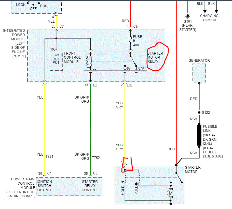

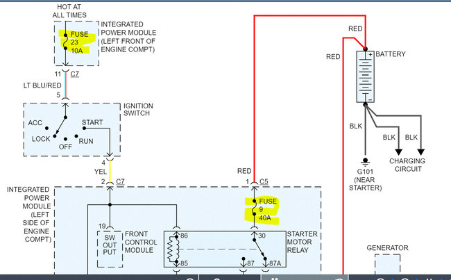

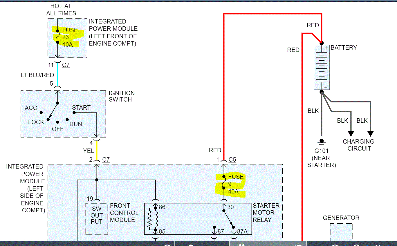

Reconfirm the fuse didn't blow again. There are two fuses in question. Pic 1 below shows the two I need checked. In addition to checking the fuse, make sure there is power to the socket.
Next is the starter relay. If there is another in the box that has the same part number, switch them and see if that makes a difference. (I will provide a relay test in case there isn't another one with the same number).
Last, if the fuses are good, the relay is good, the battery is good, and all connections are clean and tight, check for power to the yellow/grey wire going to the starter solenoid (the smaller wire). It should have 12v when the key is in the start position.

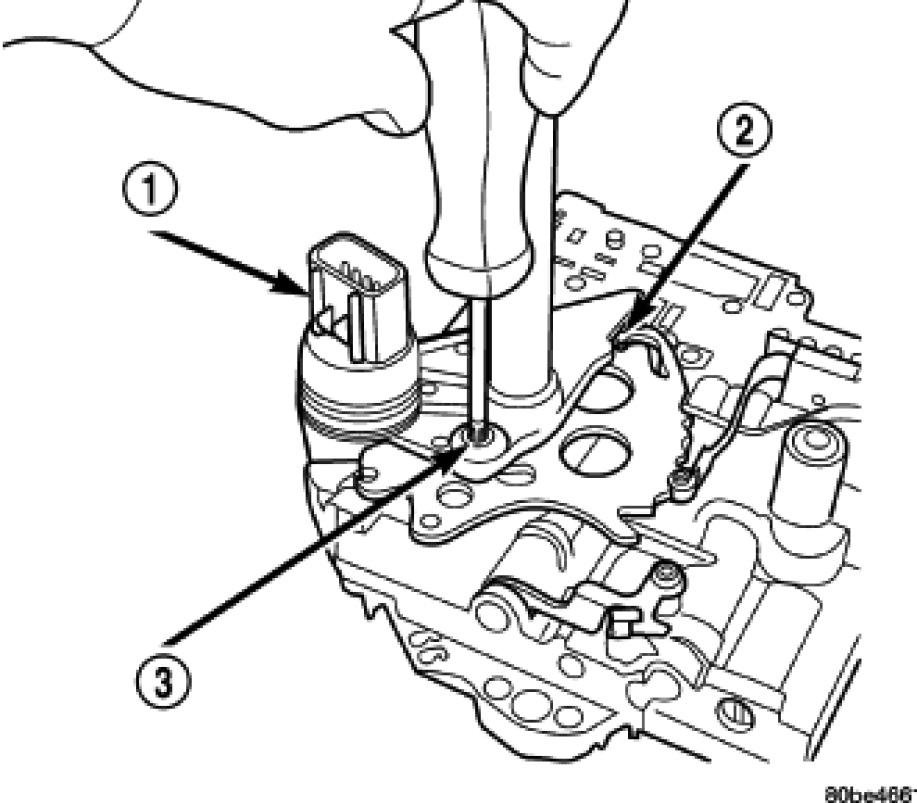

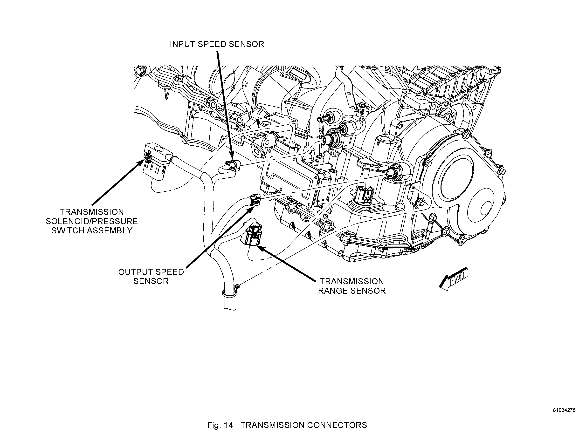

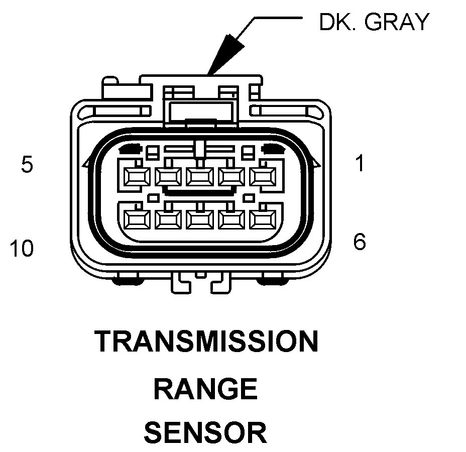

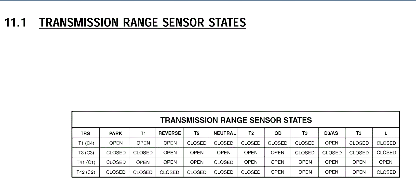

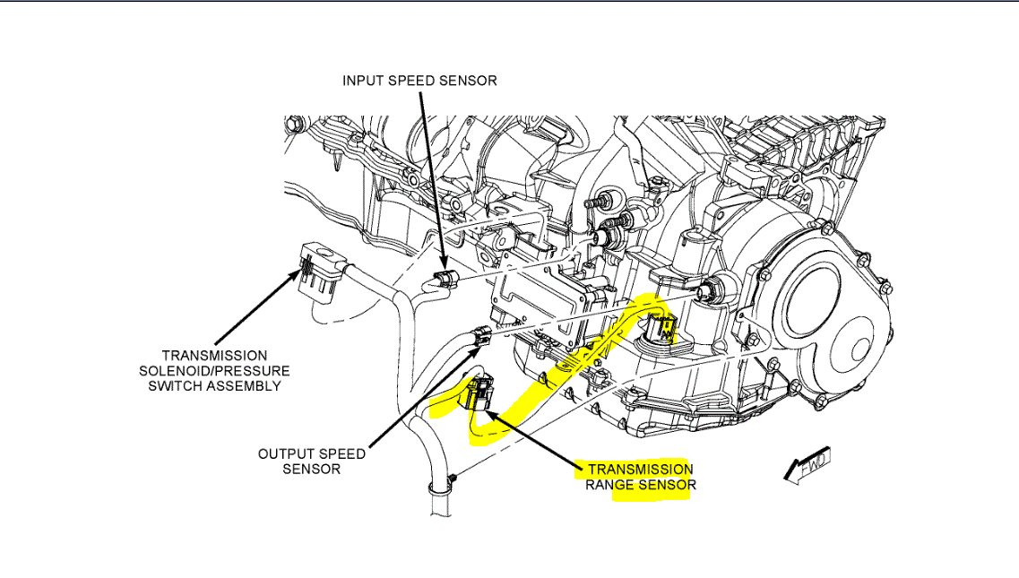

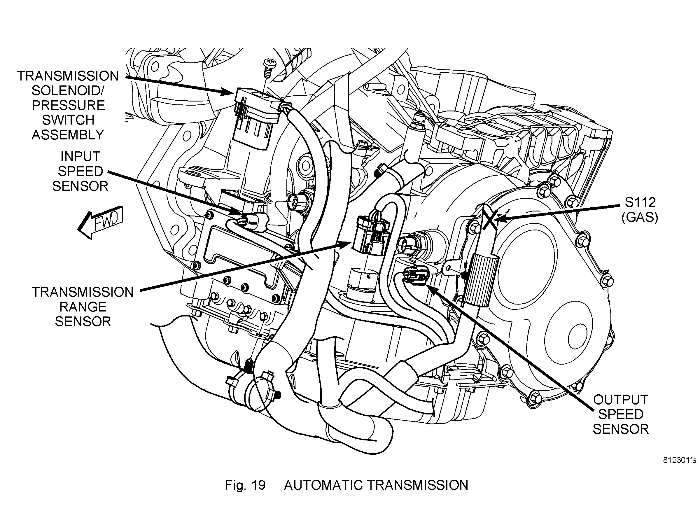

Yes, that indicates to me there is a problem with what is called the transmission range sensor. The range sensor tells the computer what gear to select for the transmission. It also works like the old neutral safety switches. (Pics 2, 3, and 4 show different angles of location and pin connector)
If you look at pic 1, it shows the location on the transmission. Make sure it is tight and not damaged or corroded. Now, to check it requires a scanner with the ability to read transmission codes. Not any scanner will do it. If you look at the last pic, it indicates the
state based on gear. (See pic 5)
If you determine it needs replaced, the valve body in the transmission needs removed to access it. Here are the directions for removal and replacement.

pic 6
Figure 1 Remove Transmission Range Sensor
pic 7
1. Remove valve body assembly from transaxle.
2. Remove Transmission Range Sensor retaining screw (3) (Figure 1) and remove sensor (1) from valve body.
3. Remove TRS (1) from manual shaft.

Hi Brian. I hope all is well. As far as the van, check to see if there is power to the smaller wire on the starter when the key is in the start position. You will need a helper. Here is a link that will help. There is a chance you got a bad starter.

That is most likely the starter relay. Normally, you wouldn't be heard when the starter engages.
Since you do hear that, we need to see if power is making it to the smaller wire on the starter when the key is in the start position. Brian, if there is power to it, remove the starter and have it bench tested at a parts store. If you do have power to that wire and the big wire has 12v, the starter is bad.
