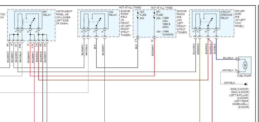

Turns over but doesn't run, I don't have a manual so I'm not sure which relay maybe for the pump. (Looked online but the fuse box and relay box are different than what I have seen). But anyway. I pulled the plug off the pump and checked the current the ground seems to be good (white wire). And supposedly check the power wire (blue) when the key is turned on, but my test light will not come on, so I'm thinking it could be the relay, but I don't know which one it is. I did move the like relays around in the relay box but no positive outcome.

The easiest thing to do is this. To confirm it is a fuel related issue, see if it starts for a couple of seconds using starting fluid. If it does and then stalls, we know it's a fuel problem.

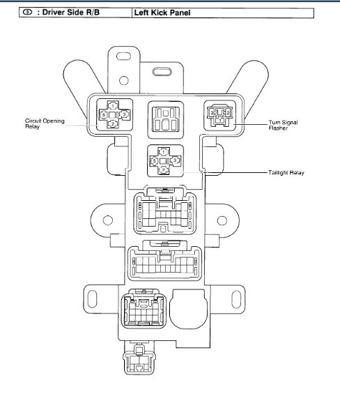

As far as your question is concerned, you are looking for the circuit opening relay. It won't be listed as a fuel pump relay. The circuit opening relay is what sends power to the fuel pump and is located in the relay box behind the left kick panel.
For this relay to actuate, it requires power from the EFI relay. Anything to make it a little more confusing. LOL
I attached a few pics below. The first shows the wiring for the circuit opening relay. The second shows the relay location.
