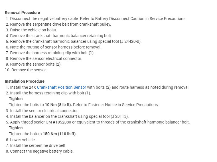

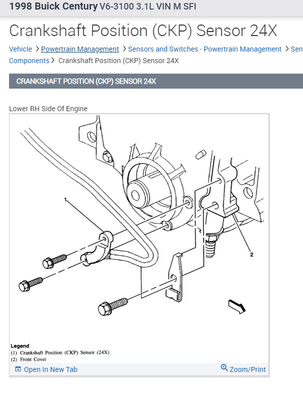

Is the check engine light illuminated?
If it is, then it will be a good idea to scan and retrieve the code(s), as it can help with the diagnostics.
One of the possibilities is having a faulty crankshaft position sensor. A failed crank sensor will allow the engine to crank over but not start.
Take a look at these helpful guides:
Let me know of any questions.
