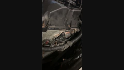

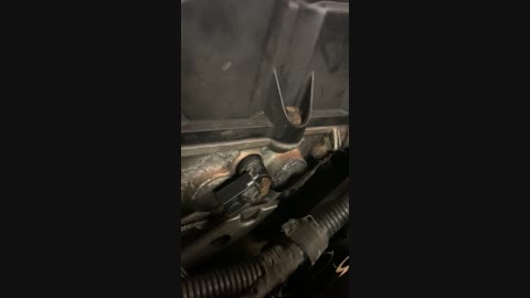

I have the car listed above 2.7 with EGR. I redid the timing, water pump, and oil pump got back together and I only get fire on cylinders two and three. But if I unplug the cam sensor I get fire on all cylinders. I was told I need to take in to shop so they can plug their scanner into it to home in the cam. Does that sound right or are they just trying to get money? Let me know if that’s right or if you may know what to do to fix. Thanks

The codes I have are:
P0113-Intake air temp sensor high voltage
P0340-No Kim signal at PCM
P0353-Ignition coil #3 primary circuit
I am also going to send you videos of what is going on.

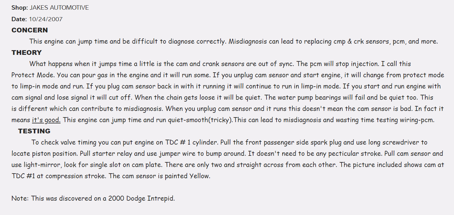

Can you please double check the timing for me and make sure we are not a tooth off. I came across this tip in what we use to pull our information from and it sounds like what you have going on to a "T". I have included it in the diagrams below. Please go through it, double check your timing, and get back to us with what you find out.

I got the car running we had the wrong camshaft timing gear we had the one in it from the 2004 the one is different in the 2001. Thank again for all the work you did to try to help. So if you ever have someone come to you with this issue again have them make sure they have the right camshaft timing gear.
