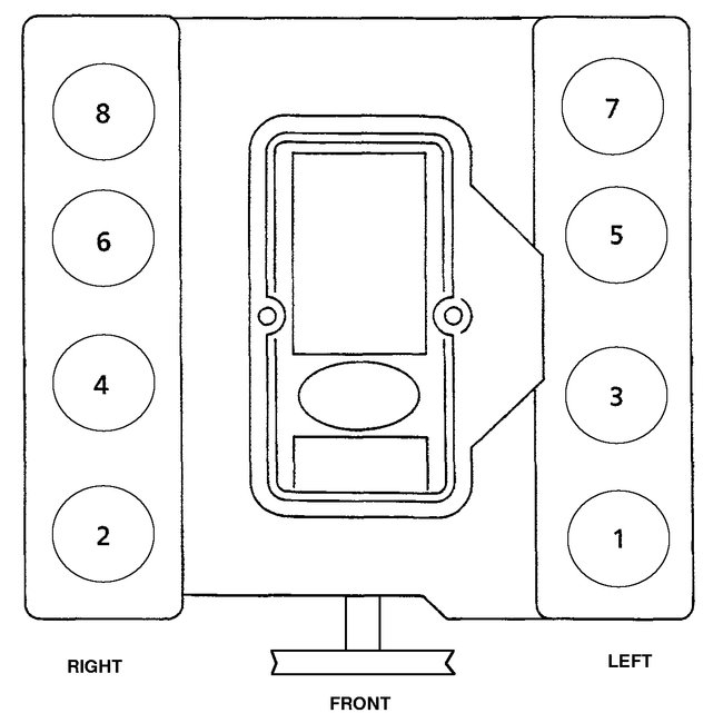

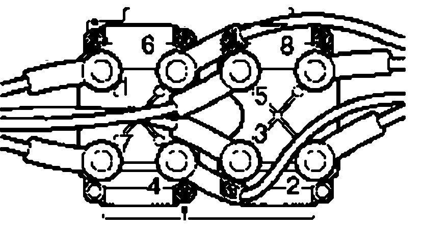

It Just quit. I replaced plugs and wires and it is getting fire to all plugs. I can hear fuel pump running.
Nov 28, 2018 at 1:24 PM
  • 110,194 POSTS
If you have spark and fuel, it should run. However, are you sure you installed the plug wires back in the correct order? I have attached two pictures. The first shows cylinder number and location. Picture 2 shows shows the plug wire orientation on the coils. The firing order is as follows:
Firing order .................... 1-8-4-3-6-5-7-2
No. 1 cylinder location - pulley end of left bank.
If you have the spark plug wires running to the wrong cylinders, it will not run.
