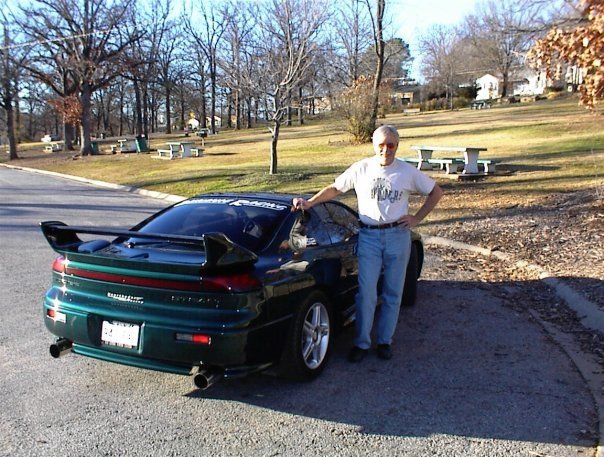

i bought it I think in the late 90's and first time I drove it I had to have it. It did 0-60 in under 4 seconds. I loved it and it looked awesome. Does not look like the photos anymore sad to say.

Randy, that is really a nice car. I nearly purchased one back in 2013. I always wanted one. Instead, I ended up with the 37th Viper ever made. It was scary fast, but didn't have the HP your car has.
