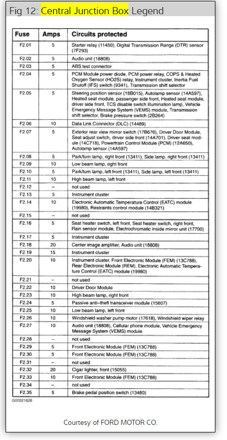

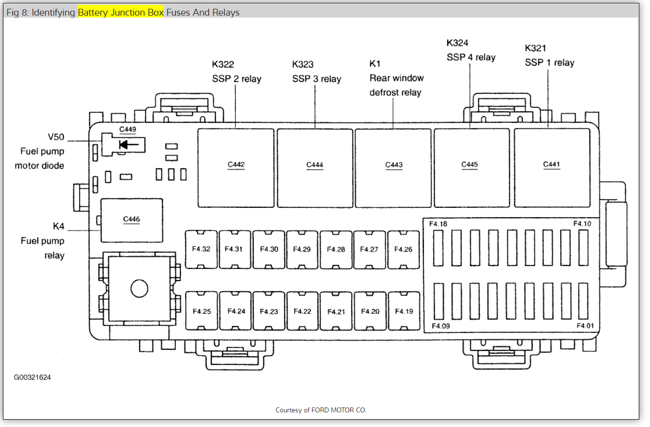

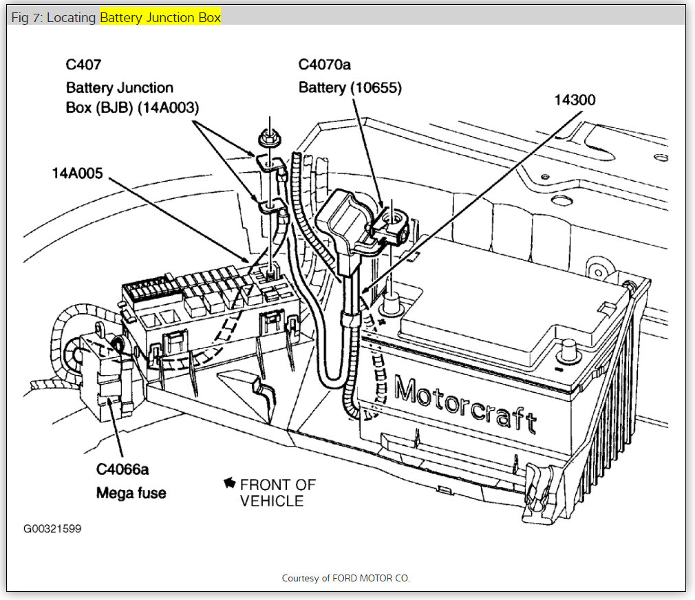

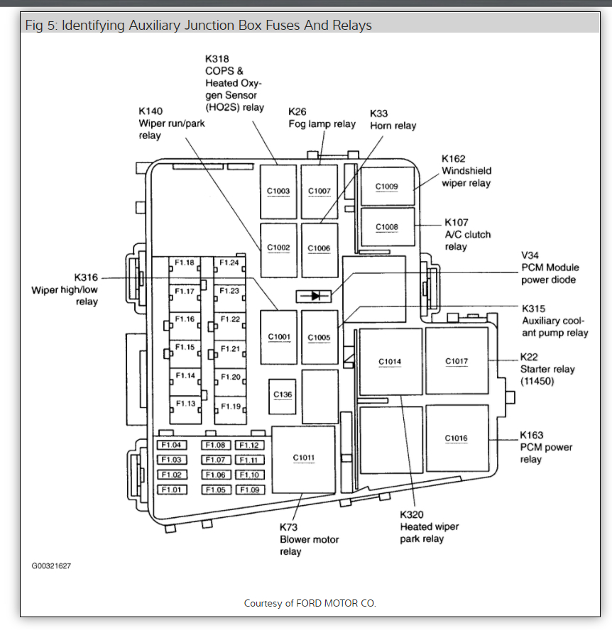

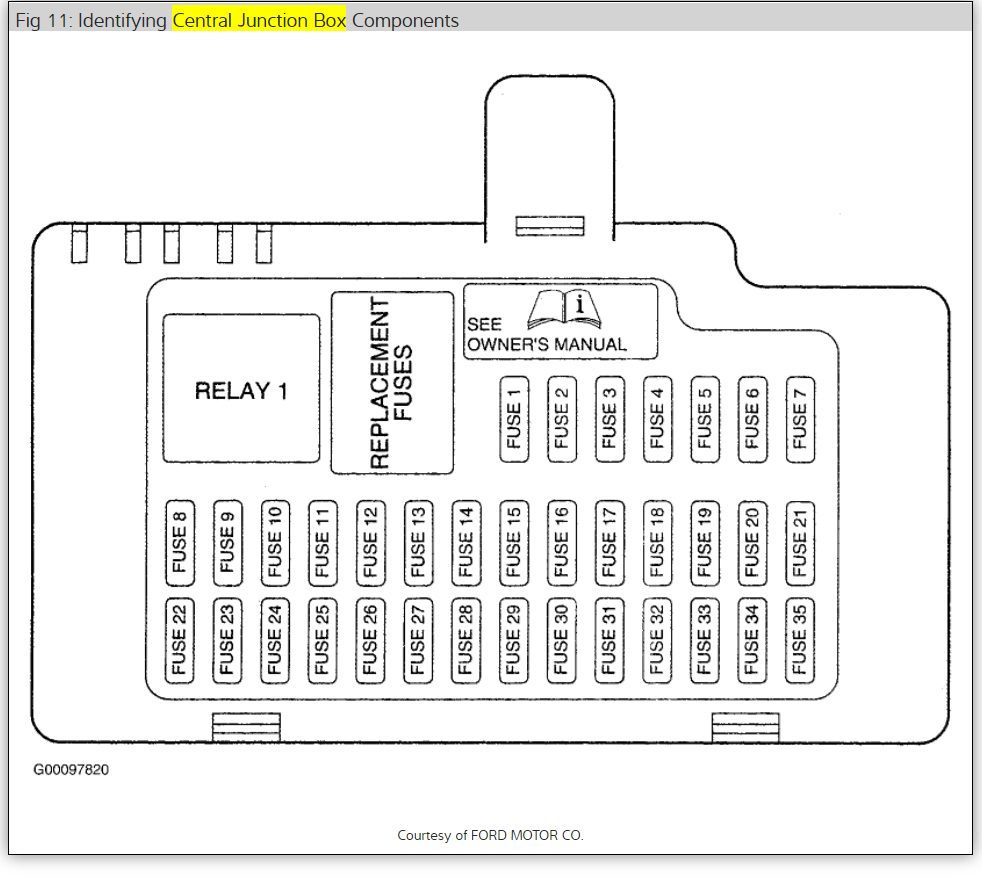

Just replaced my window regulator and now my car will not start. Horn will not honk anti theft is stuck and emergency brake is locked.

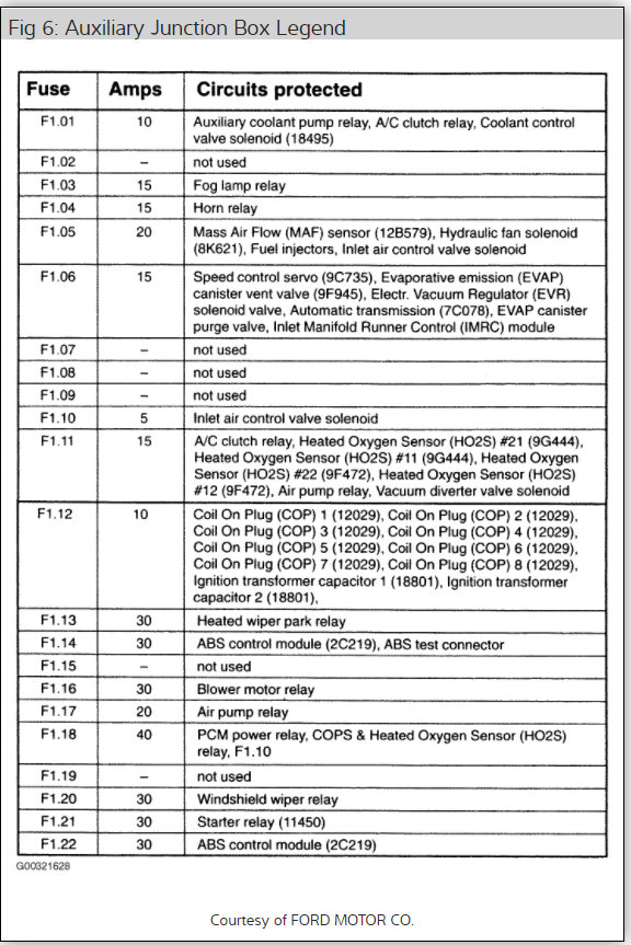

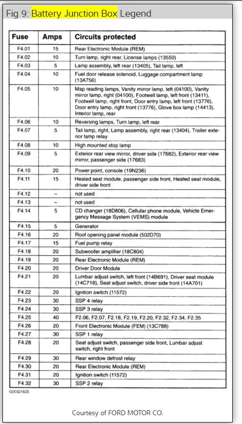

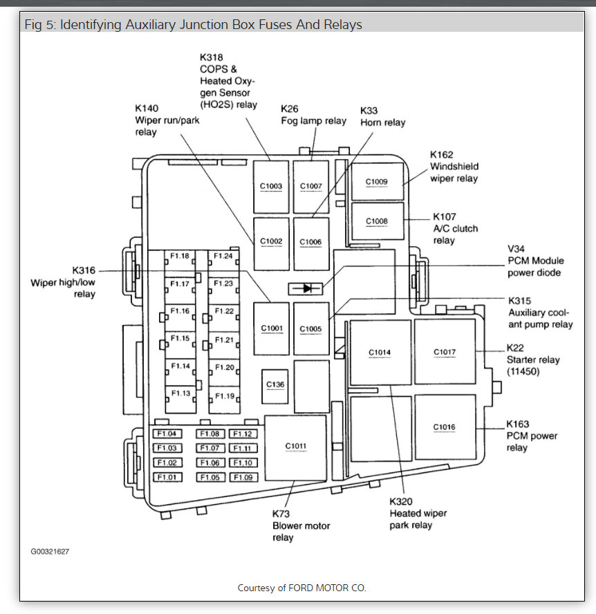

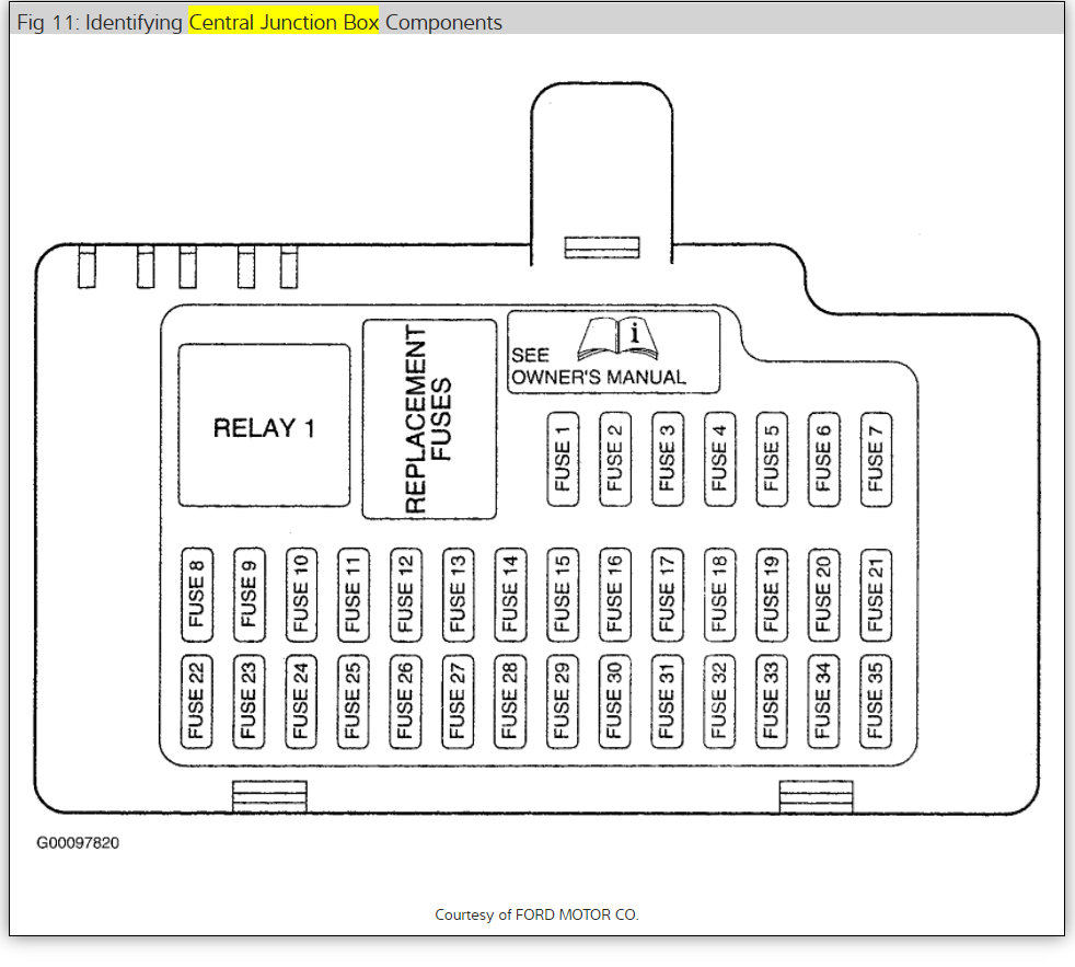

We initialized the window that is when these problems occurred. We believe it is a fuse. Any idea where we should start checking?
Jul 6, 2018 at 9:15 PM
  • 55,433 POSTS
With the key in the on position I would check all fuses. Here is a guide to show you how and the fuse panel locations and identifications:
Check out the diagrams (below). Please let us know what you find.
