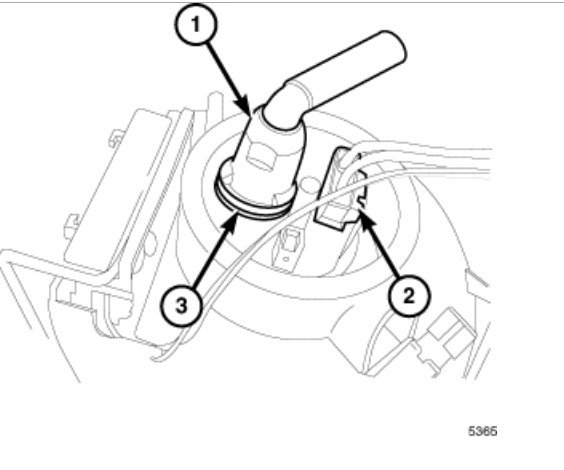

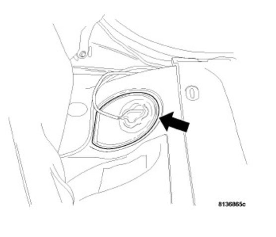

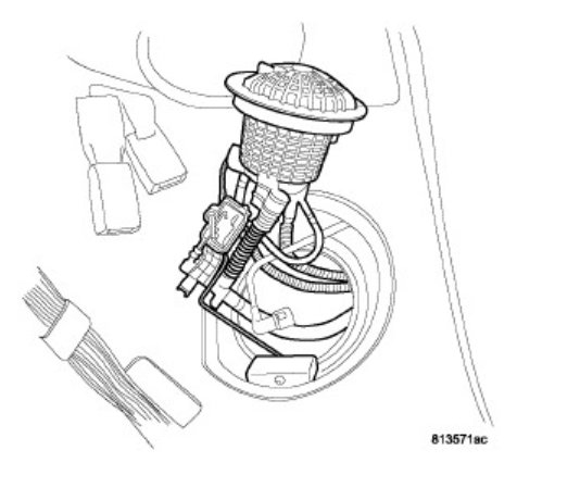

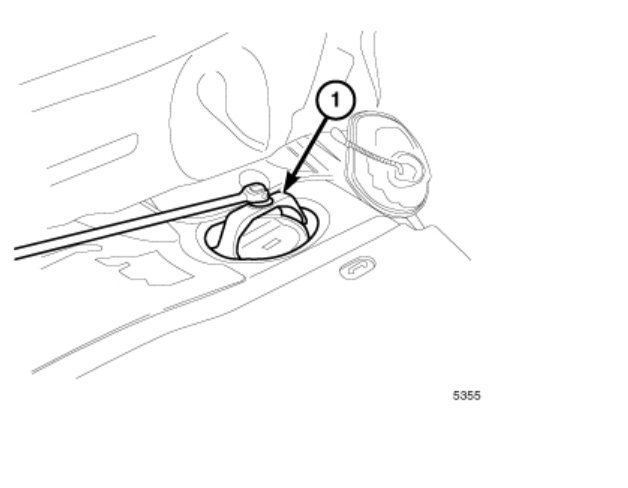

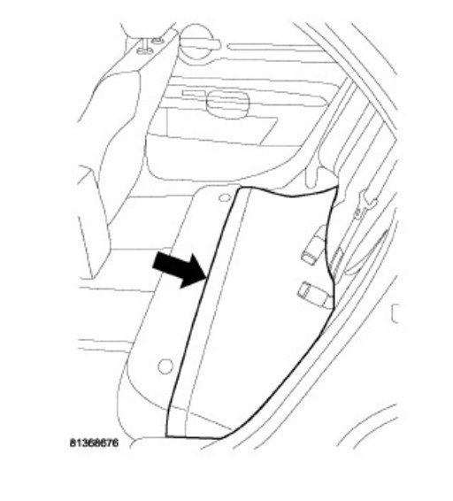

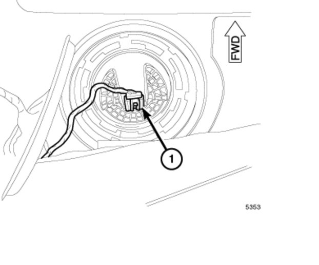

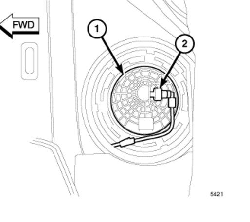

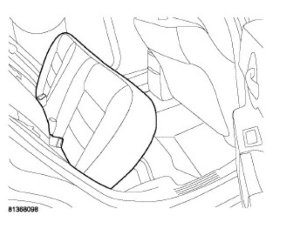

i just changed the fuel filter and my car still will not start.
Jul 10, 2017 at 1:32 PM
Experienced Mechanic
55,579 POSTS

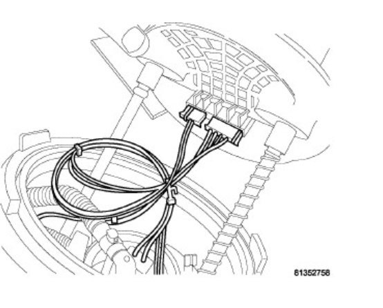

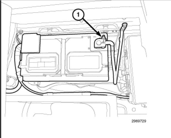

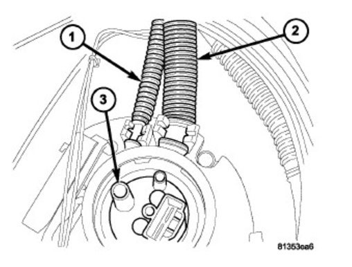

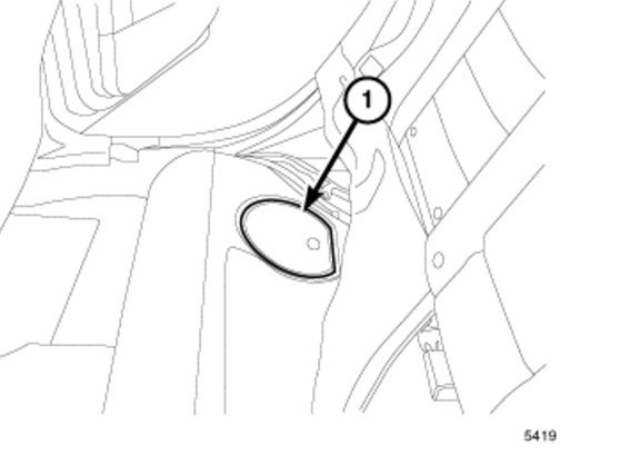

It sounds like the fuel pump when out. Here is a guide to help you get an idea on what you are in for when doing the job:
https://www.2carpros.com/articles/how-to-replace-an-electric-fuel-pump
Your is under the back seat though. Here are the diagrams (below) that will show you how to change it.
Here is an additional guide as well:
Images (Click to enlarge)
