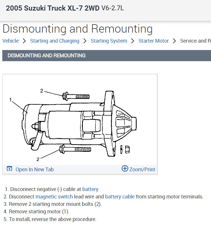

We will need more information from ou to help fix the problem. Do the headlight come on bright? Have you checked the fuses? If so, need need to check to see if the trigger wire to the starter is getting power when the key in in the crank position.
If you are getting power to the trigger wire the sater is problemble bad, here is how to remove it so you can have it tested at the auto parts store.

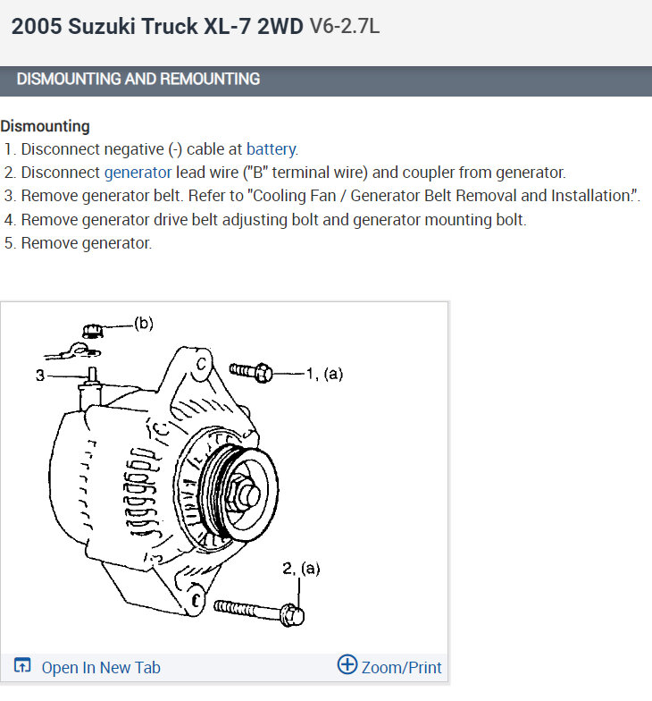

It sounds like the alternator is iot working, with the engine running please go over this guide to confirm the charging or not.
Here is how to replace it in case you need it. Check out the images (below). Let us know what you find.
