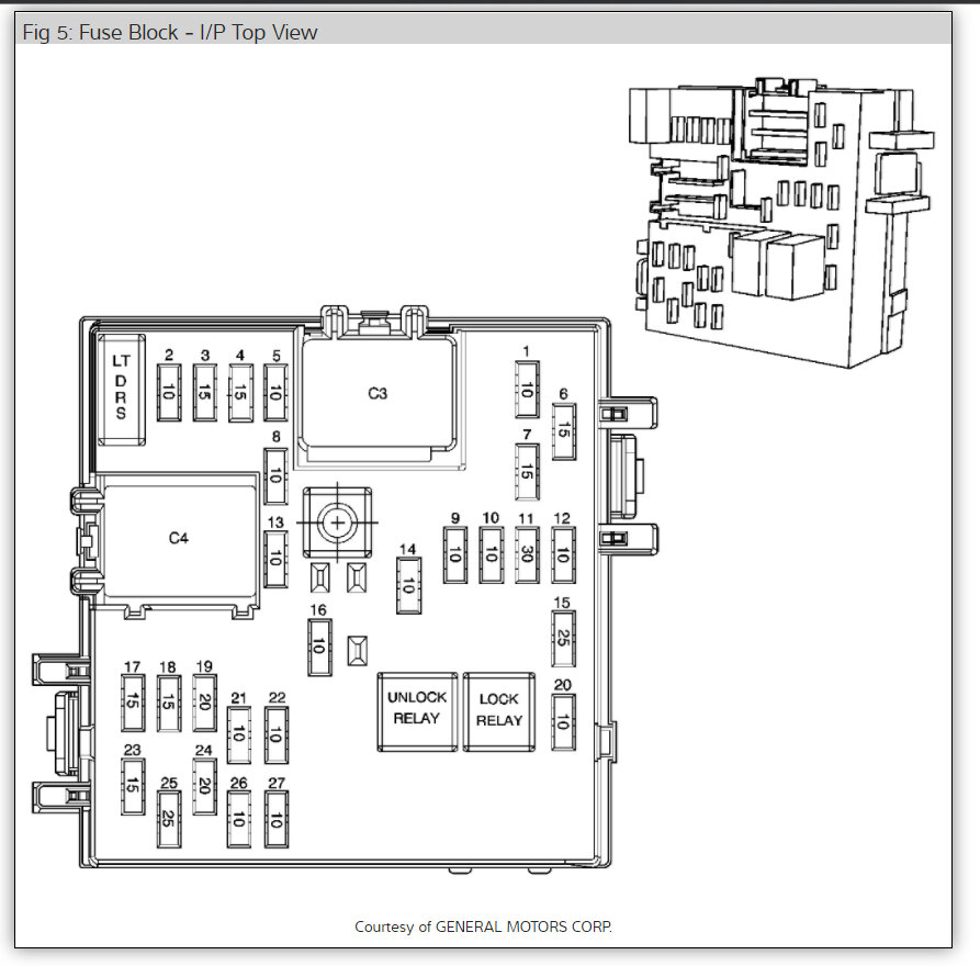

turn over the ignition and it doesn't start. When I turned it over all the gauges zeroed out until i let off the ignition. I have put a battery charger on to make sure that it isn't the battery. Replaced the starter nothing, ran a jump wire off the starter still won't start. Replaced everything for the ignition still nothing. Even done a little starting fluid in the air intake to try to get it to start. I can only get it to crank over when i use the jumper wirer from the starter.

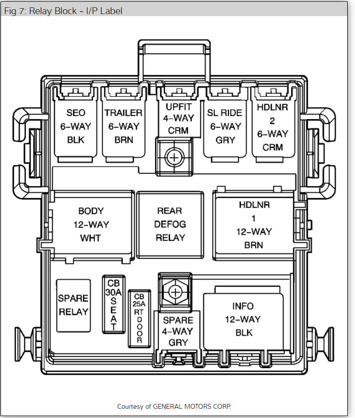

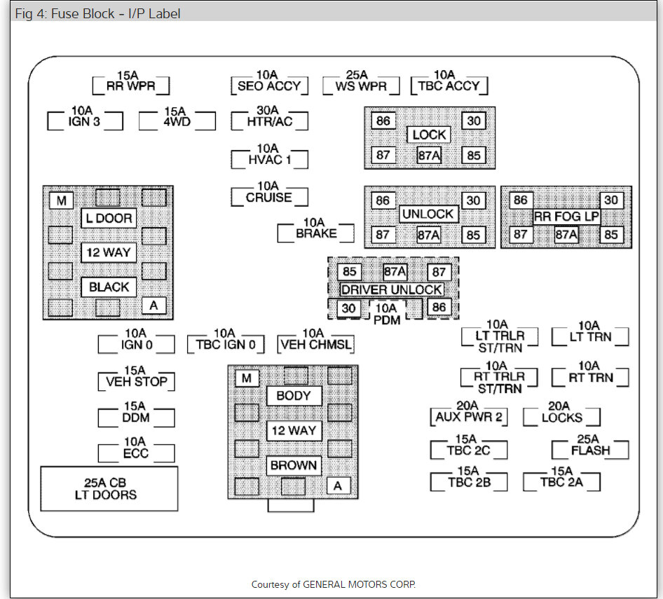

Here are the fuse locations to help. Check out the images (below). Please let us know what happens.

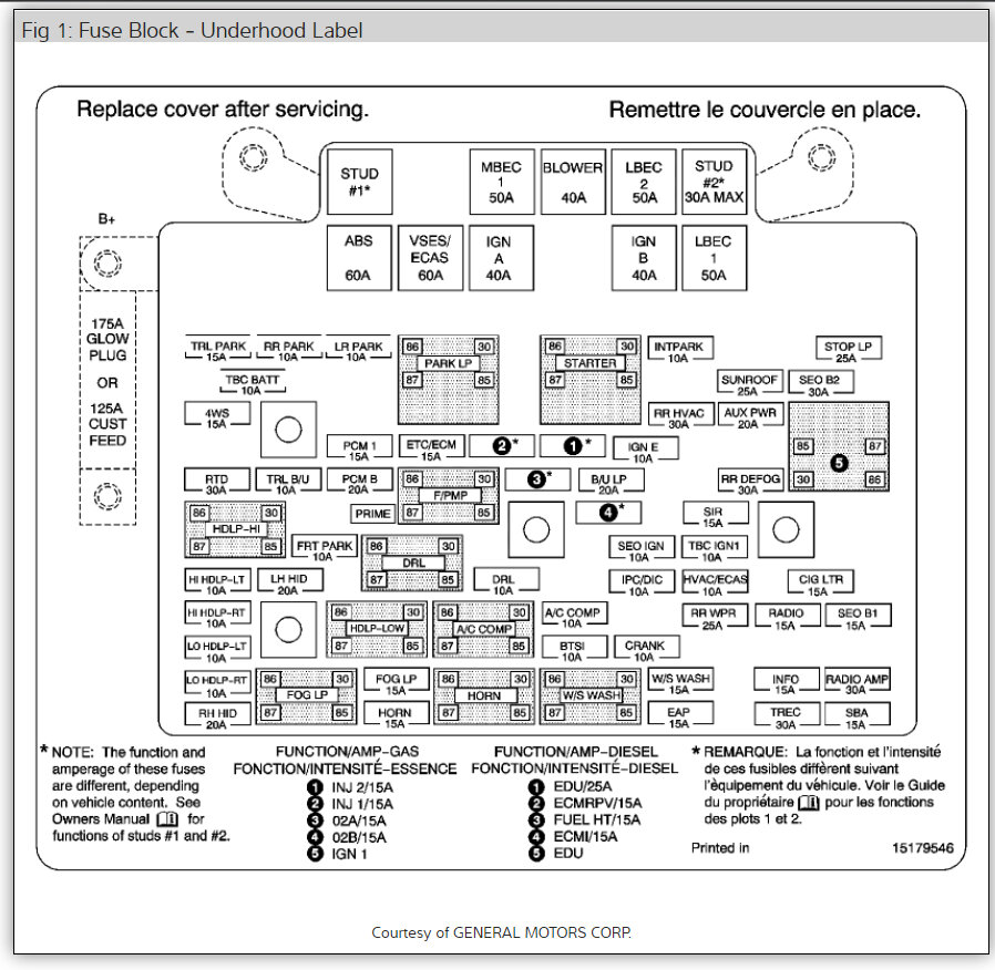

Okay, you could have a bad PCM but let's check for power at the CIG LTR fuse 15 amp under the hood. This is the fuse that powers the ALDL connector port. Please let me know.
