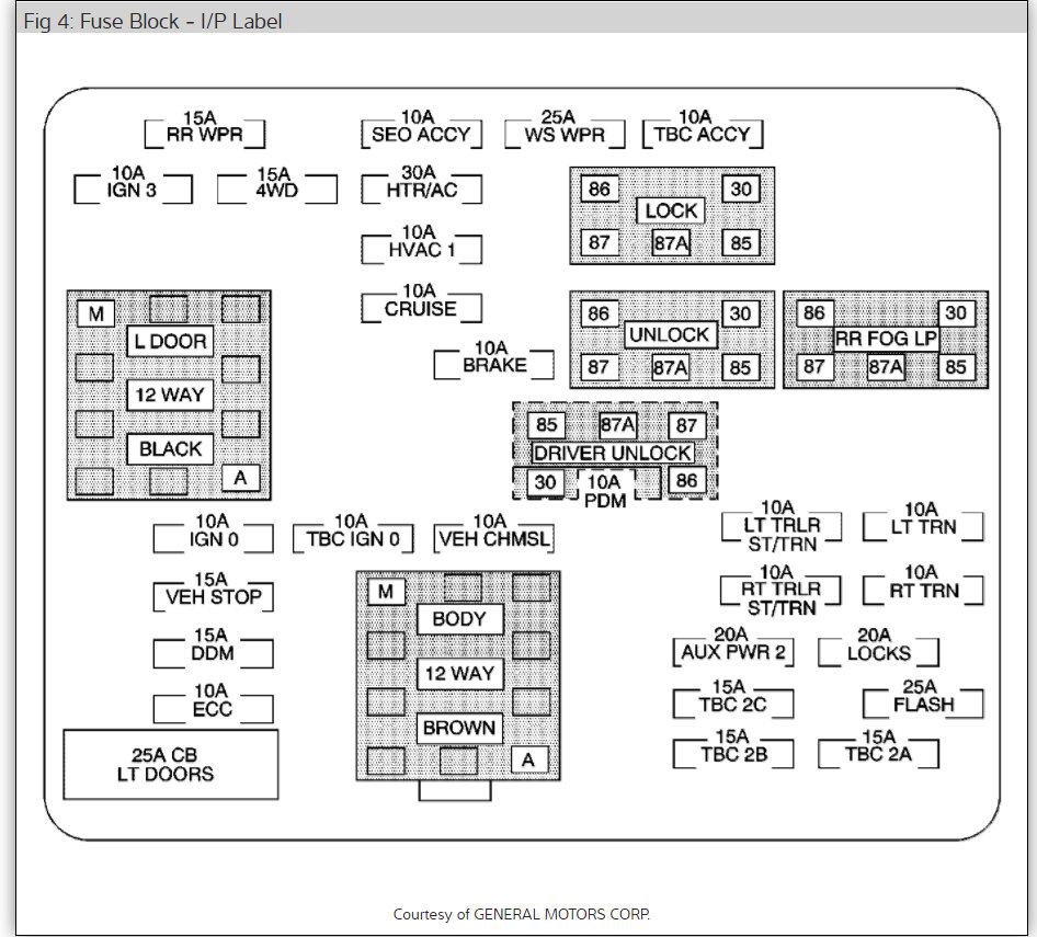

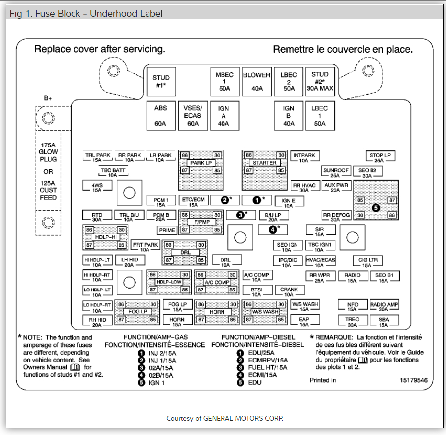

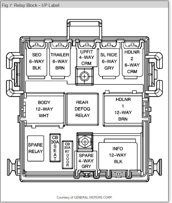

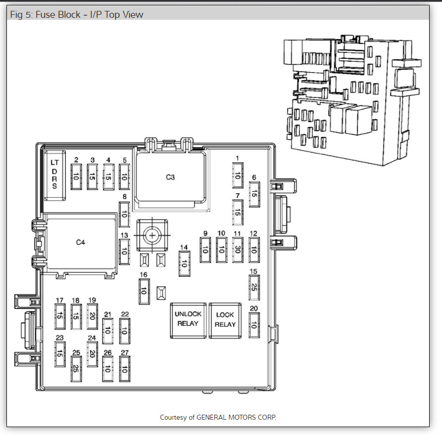

Can I ask if the security light is flashing? Also, we should run the codes, have you checked the fuses? Let's go over these guides to get us closer to fixing the problem:
https://www.2carpros.com/articles/how-to-reset-a-security-system
and
and
Here are the fuse locations to help. Check out the images (below). Please let us know what happens.

Okay, you could have a bad PCM but let's check for power at the CIG LTR fuse 15 amp under the hood. This is the fuse that powers the ALDL connector port. Please let me know.
