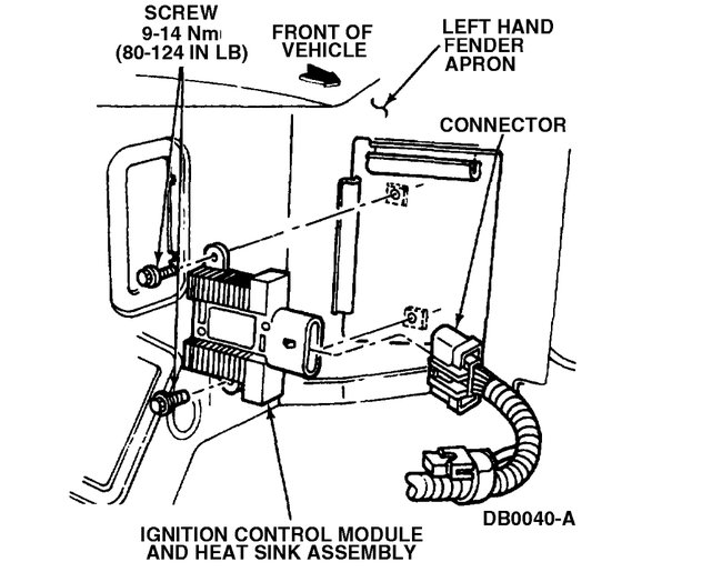

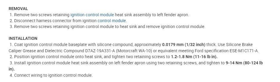

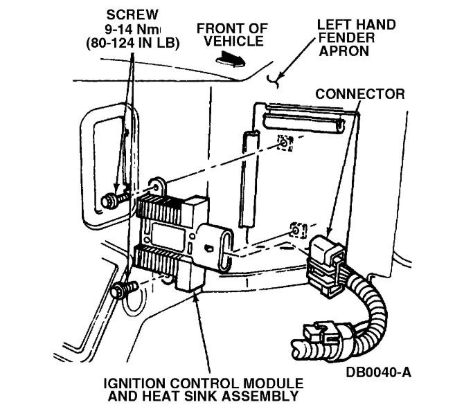

Have power to fuel pump and turns over, but no fire to plugs.
Feb 18, 2020 at 1:16 PM
SCGRANTURISMO
  • 4,897 POSTS

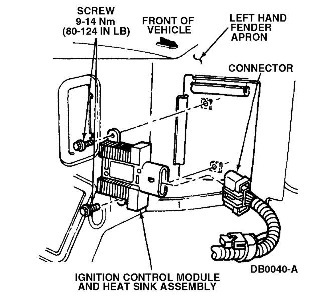

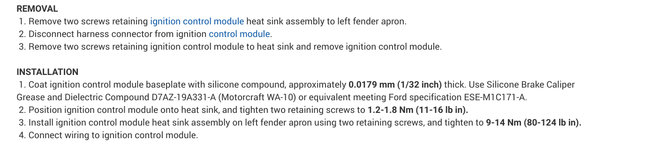

This could be a problem with your vehicle's ignition control module. In the diagrams down below I have included the instructions from the vehicle manufacturer for the removal and installation of the ignition control module for your vehicle. Please go through this guide and get back to us with how everything turns out.
