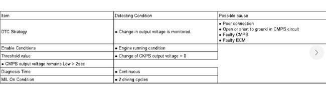

Code showing crank shaft sensor problem. Replaced it with a new one still will not start.

Po342 is code comes up camshaft sensor intermittent and then some times permanent.
Oct 29, 2018 at 7:23 AM
BERTYME
  • 5 POSTS
No sorry not camshaft it showing crankshaft. Sorry about that.
Oct 29, 2018 at 7:26 AM
Code 342 description and possibilities.

The Camshaft Position Sensor (CMPS) is a sensor that detects the compression TDC of the NO. 1 cylinder. The CMPS consists of a hall type sensor and a target on the end of the intake camshaft. When the target triggers the sensor, the sensor voltage is 5V. If not, the sensor voltage is 0V. These CMPS signal is sent to the ECM and the ECM uses the CMPS signal for synchronizing the firing of sequential fuel injectors.
Component Inspection
1. Check CMPS
(1)Connect CMPS and ECM connector.
(2)Engine "ON" & monitor the signal waveform of CMPS on scantool.
Specification : Check whether the waveform is synchronized with Crankshaft Position Sensor or not.
(3)Is the signal waveform normal?
YES
- Substitute with a known - good ECM and check for proper operation.
If the problem is corrected, replace ECM and go to "Verification of Vehicle Repair" procedure.
NO
- Substitute with a known - good CKPS and check for proper operation.
If the problem is corrected, replace CKPS and go to "Verification of Vehicle Repair" procedure.
Monitor Scantool Data
1. Connect scantool and Engine "ON"
2. Monitor "Signal waveform of CMPS with scantool.
3. Is the measured signal waveform of CMPS displayed correctly?
YES
- Fault is intermittent caused by poor contact in the sensor's and/or ECM's connector or was repaired and ECM memory was not cleared. Thoroughly check connectors for looseness, poor connection,bending, corrosion, contamination, deterioration, or damage. Repair or replace as necessary and go to "Verification vehicle Repair" procedure.
NO
- Go to "W/Harness Inspection" procedure.
