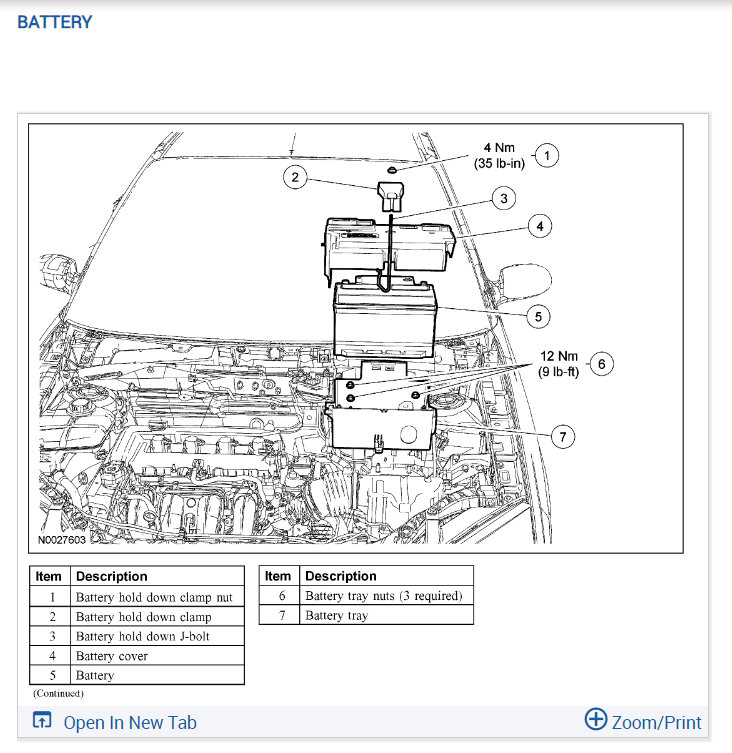

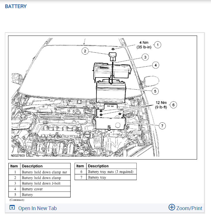

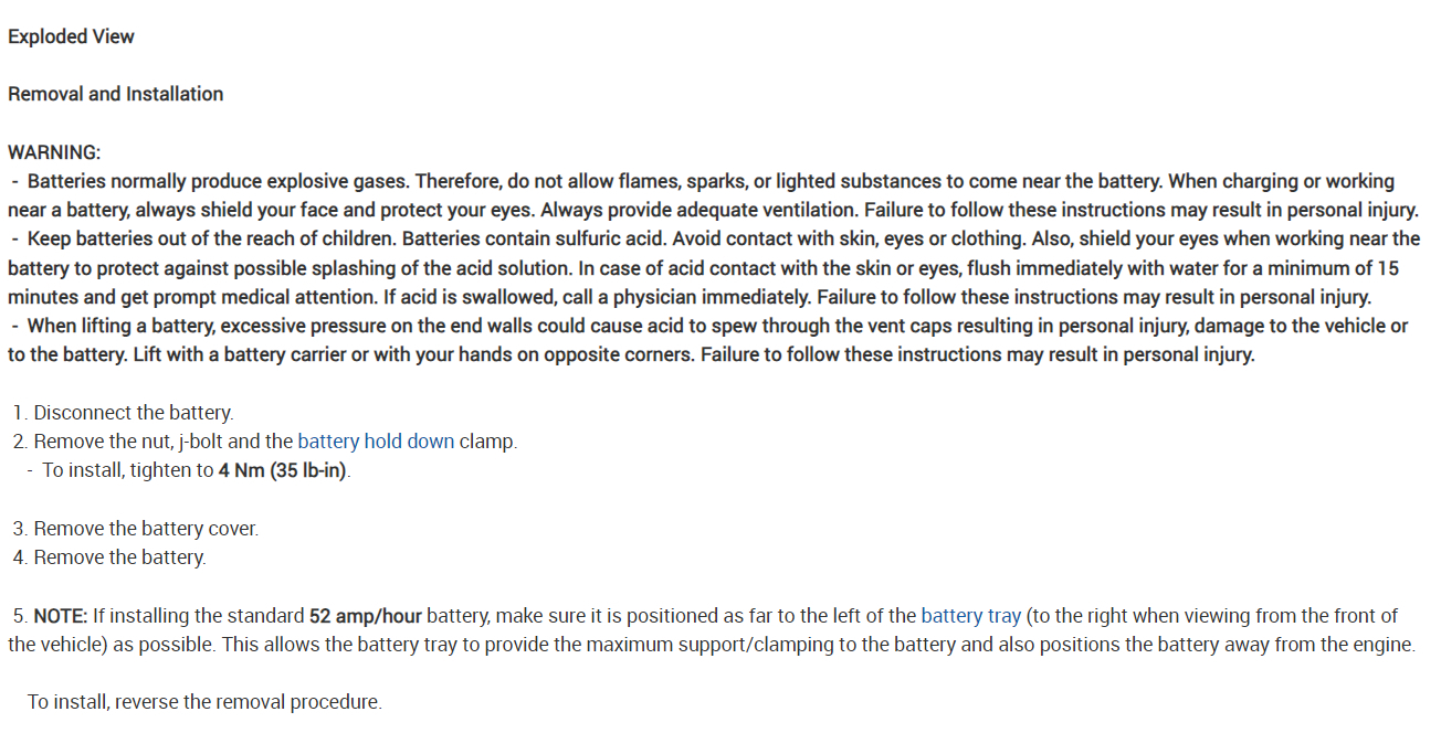

The most common cause of this problem is a bad battery. I would remove the battery and have it tested at the auto parts store. Here is how to remove the battery.
