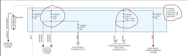

No power to the ignition.
Tried checking battery,fuses, put fast key in glove box as suggested.
Door locks have power. No dashboard lights, no ignition power, no radio power and no window power.

The first thing I need you to check are two fusible links. A fusible link looks like a regular wire, but it is designed to blow like a fuse. Take a look at picture 1. Check those links for continuity. Disconnect the battery first.
Let me know what you find.
