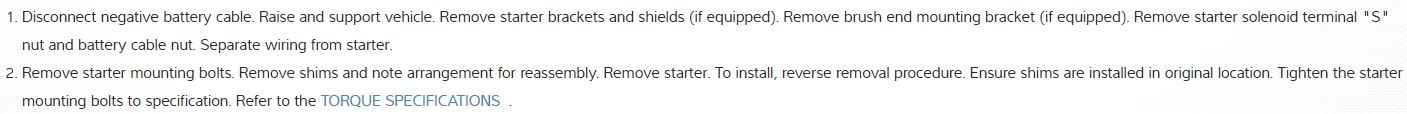

The condition you're describing is typically the result of a failing starter motor. Take a look at the article below with specifics on how to diagnose this condition. I've also attached the starter replacement procedure.
