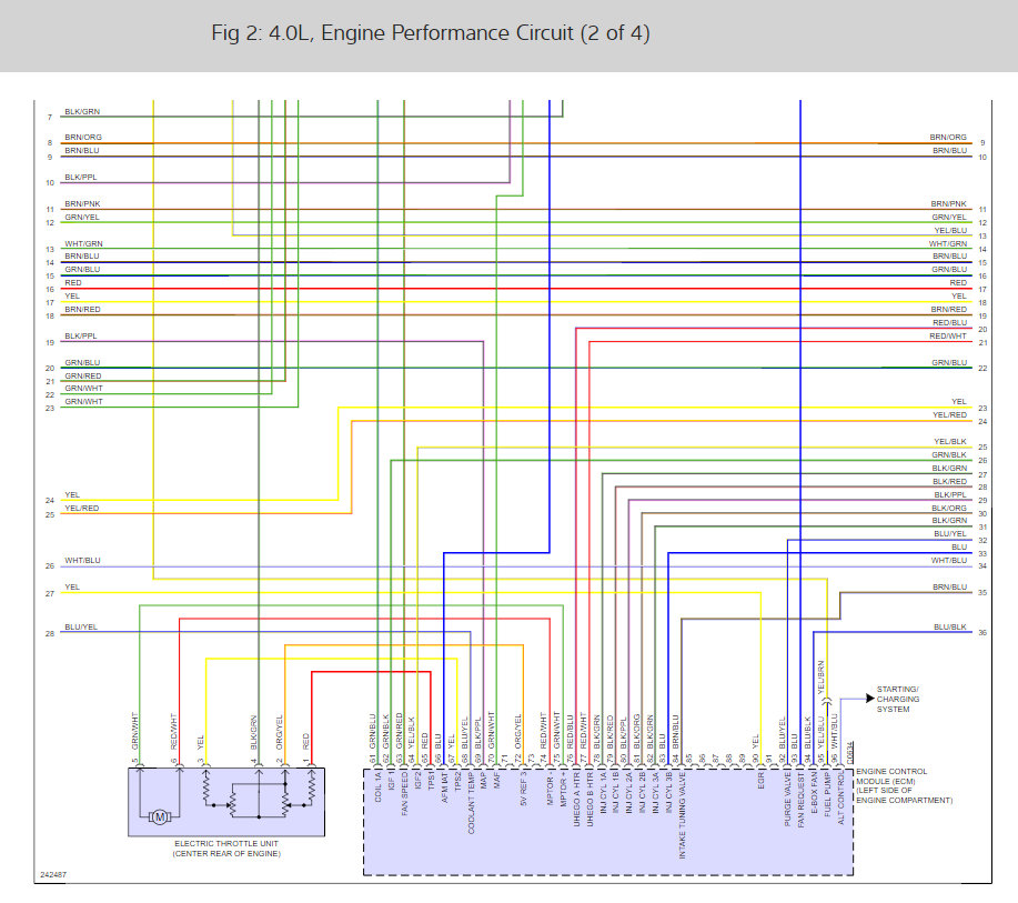

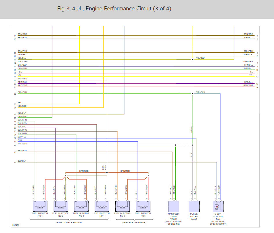

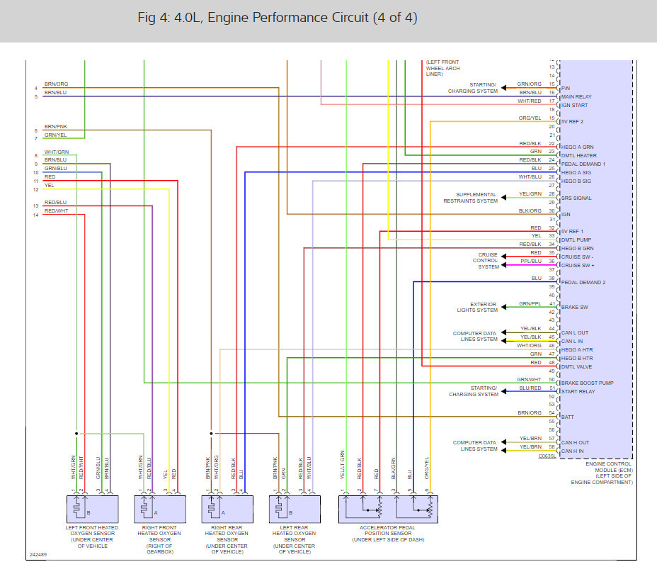

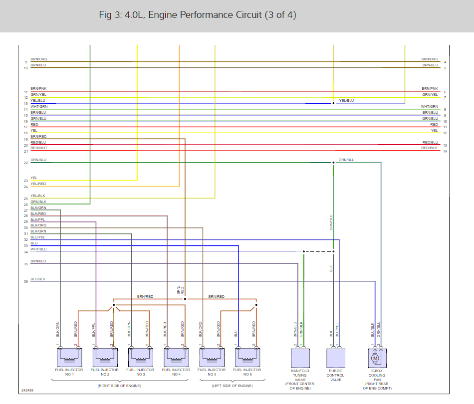

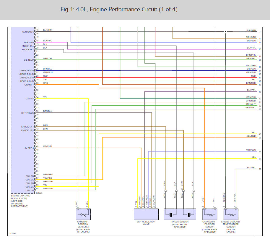

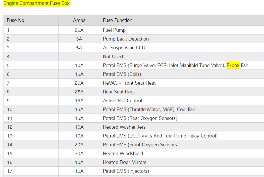

it has fire and turns over good. fuel good but no gas getting to cylinders.
Nov 26, 2017 at 3:09 PM
  • 55,710 POSTS

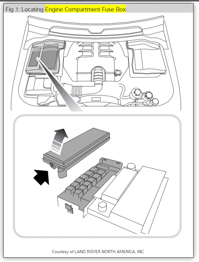

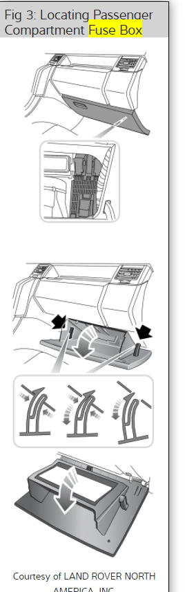

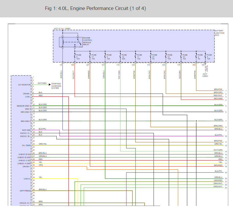

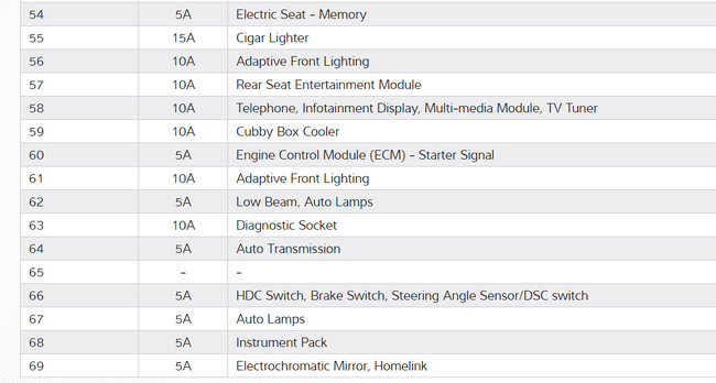

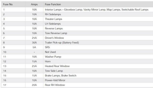

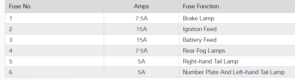

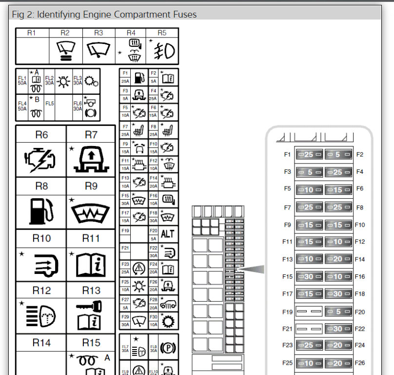

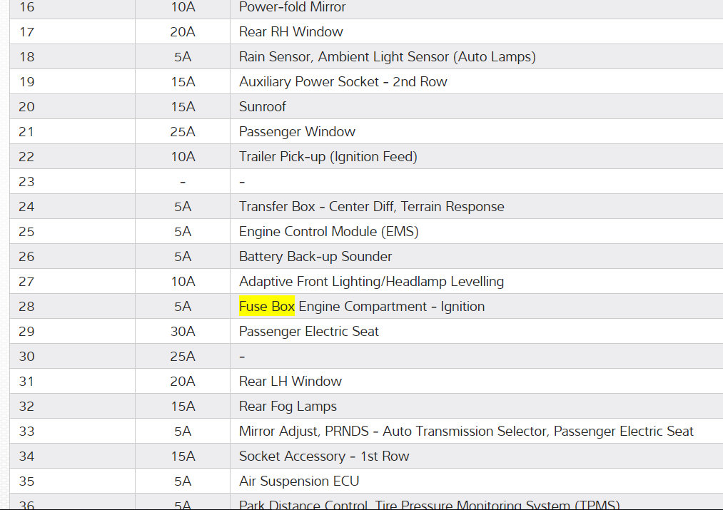

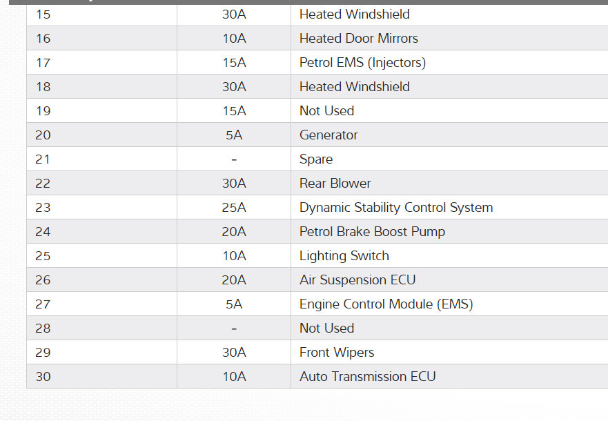

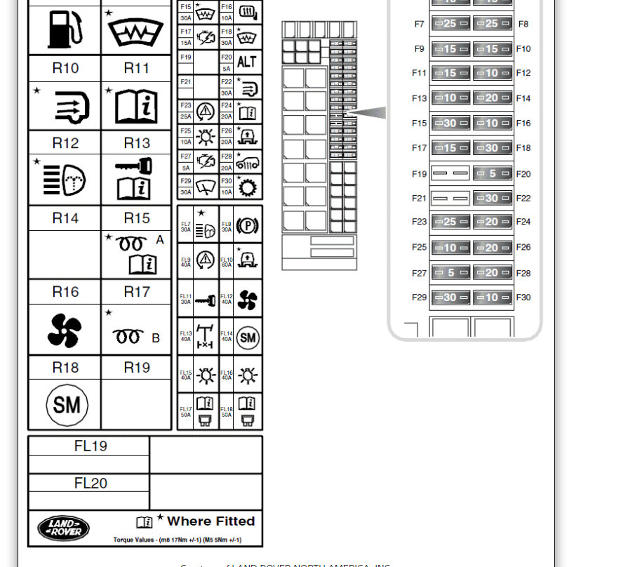

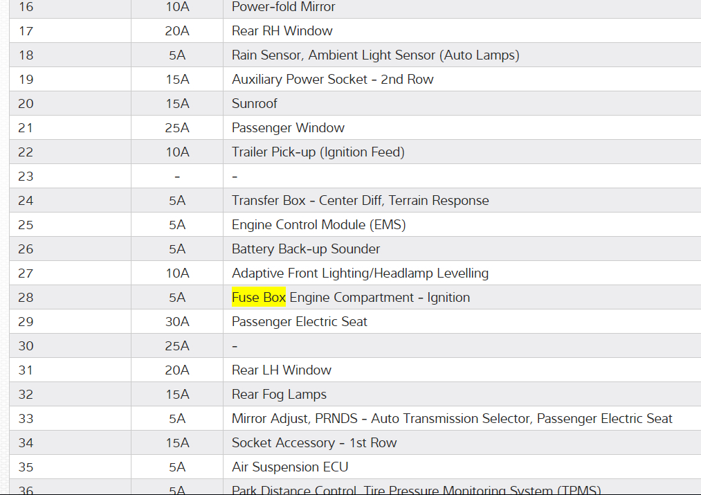

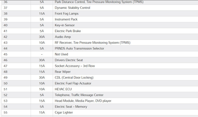

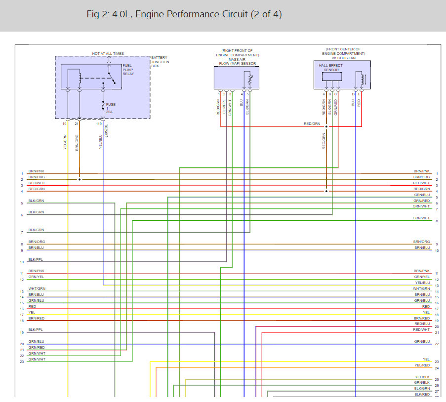

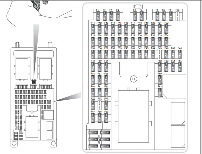

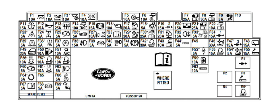

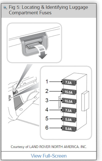

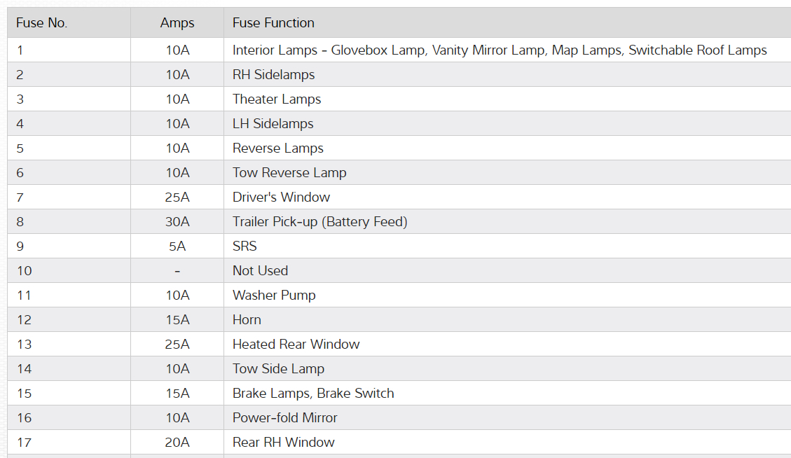

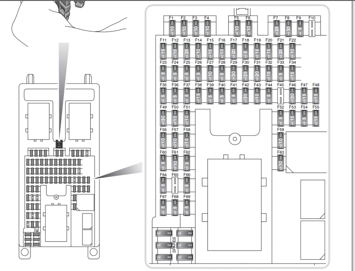

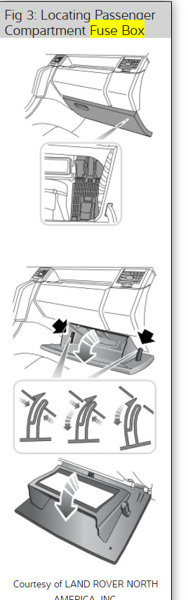

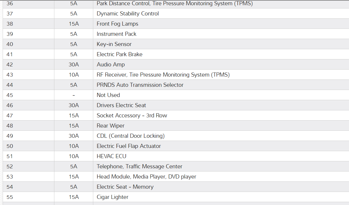

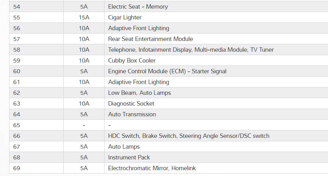

Fuel good did you take a pressure test or hear the fuel pump? If so then it sounds like you have a engine control module relay that is not working you should check the fuses as well. Here two guides to get us started.
and

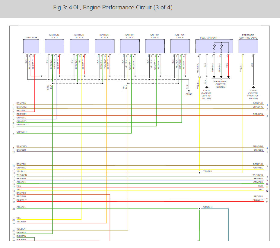

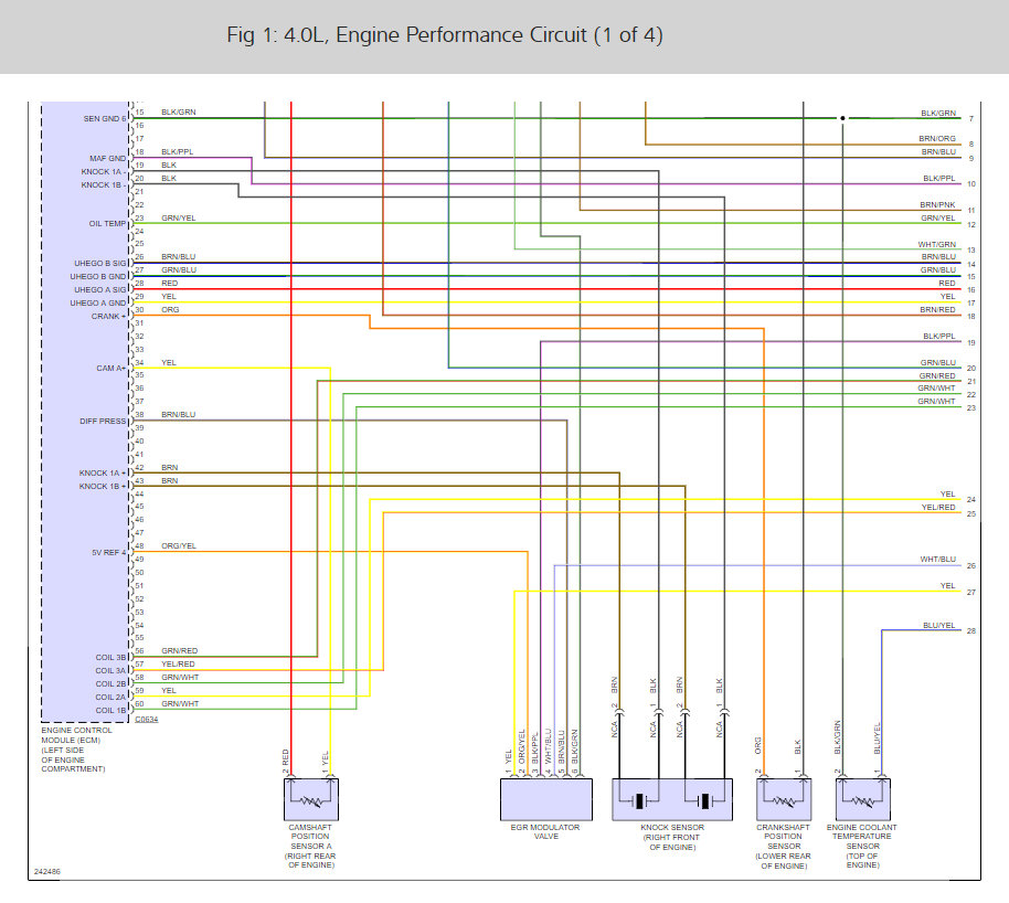

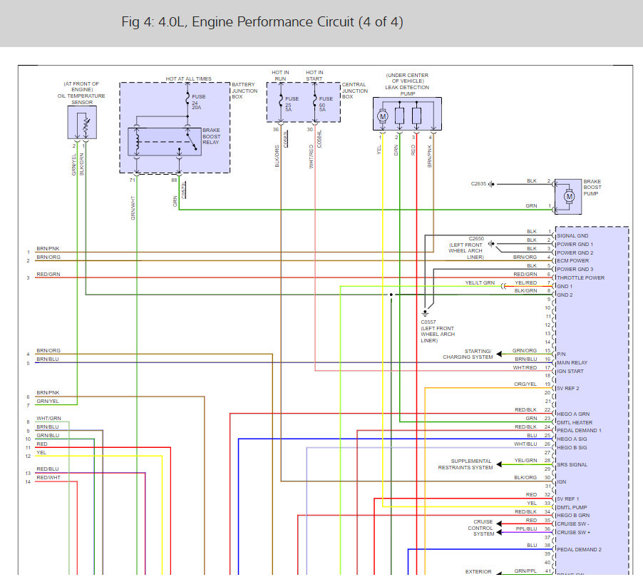

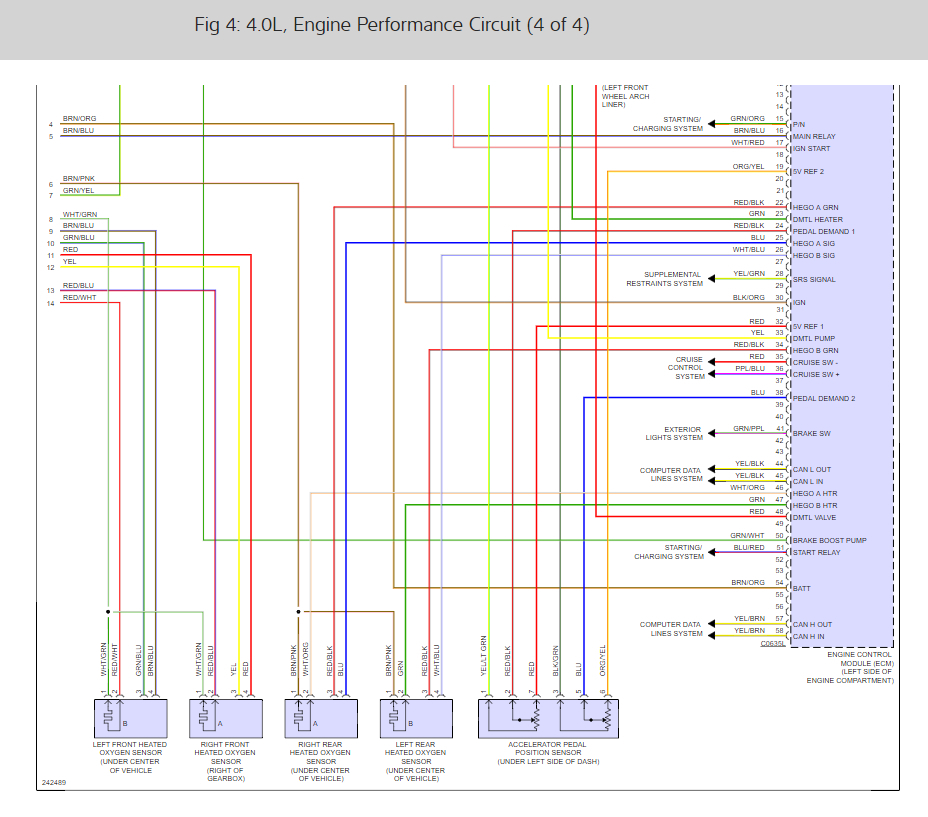

Here is the engine and fuel panel diagrams so we can see what's going on.
Please run this test and get back to us.
