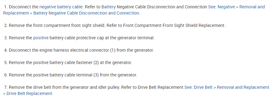

It sounds like you might have be having a few different possible issues. First, Is the check engine light on? If it is this means there is a fault code or codes stored in your cars computer and we need to know what they are. here is a tutorial showing how to retrieve fault codes from your vehicle:
This sounds like the starter is having problems or the battery needs to be load tested these guides can help us fix it.
and

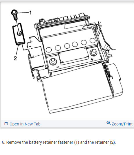

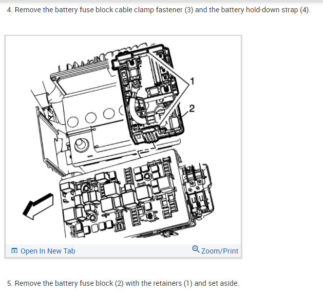

Both your battery and alternator can be tested for free at your local auto parts stores after removal.

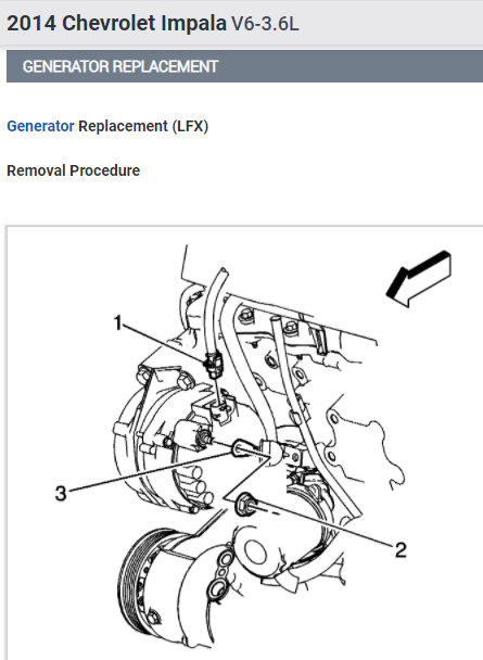

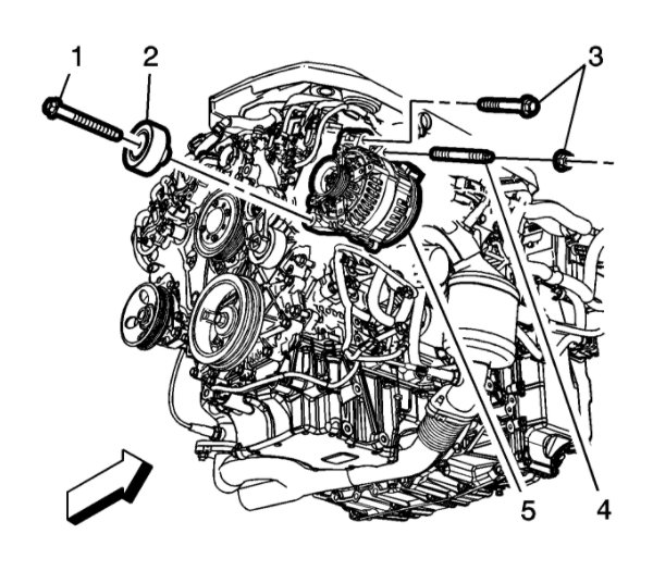

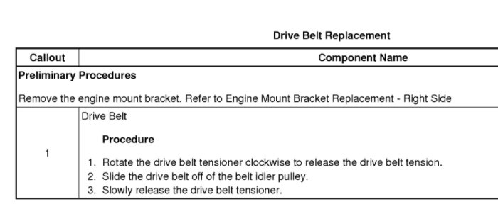

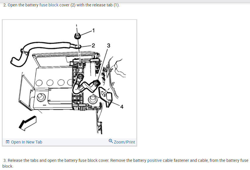

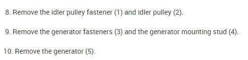

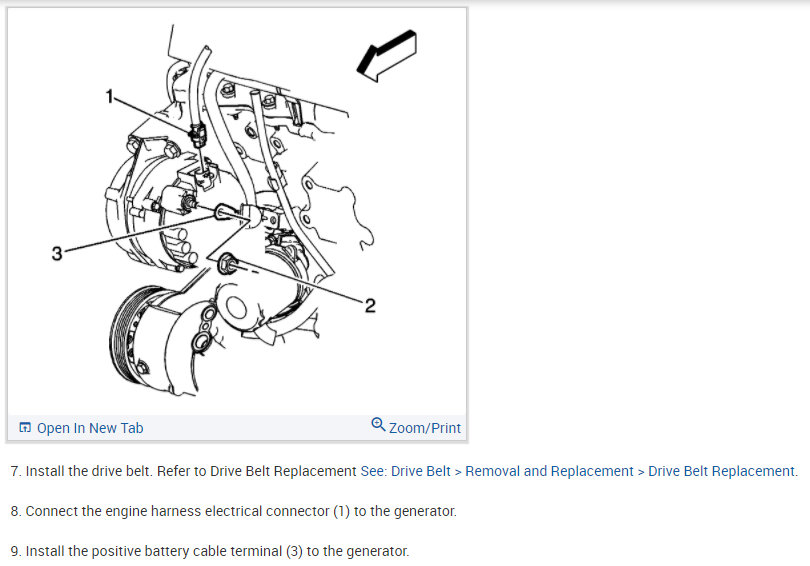

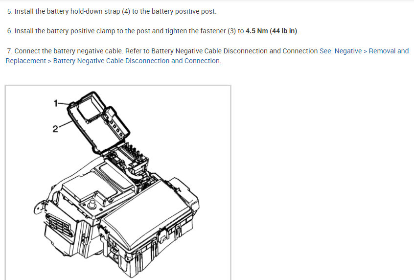

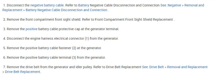

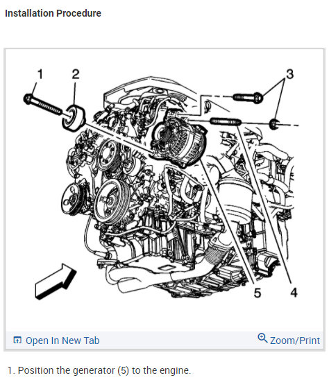

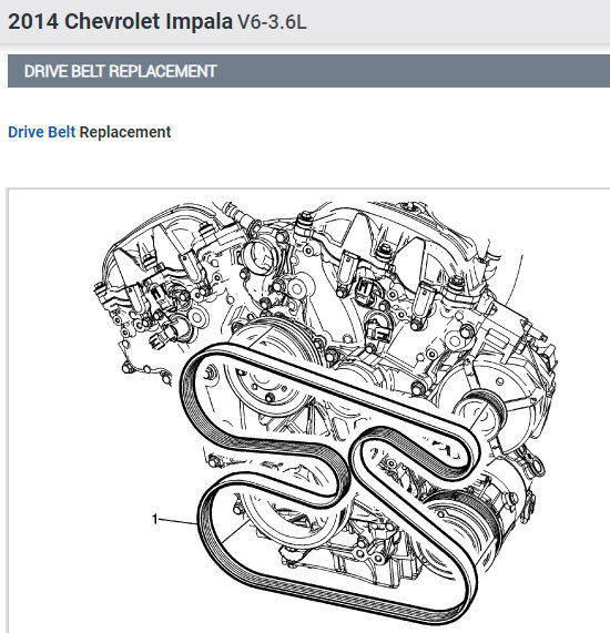

You will need to remove the serpentine belt to remove the alternator. Here is a tutorial showing how to remove and replace a serpentine belt:
I've attached picture steps below showing how to remove and replace the serpentine belt, battery, and alternator on your car. Get back to us after all this testing and we'll go from there. Hope this all helps and thanks for using 2CarPros.

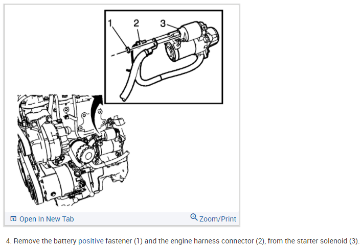

Be sure the oil filter is tight and not leaking to not cause engine damage when starting and running. It's also possible that you might be having an issue with the starter motor solenoid by just hearing a clicking sound. Be sure the battery is fully charged and tested as in my last post. Here are a few more tutorials for you to view regarding a starter motor and the starter motor solenoid:

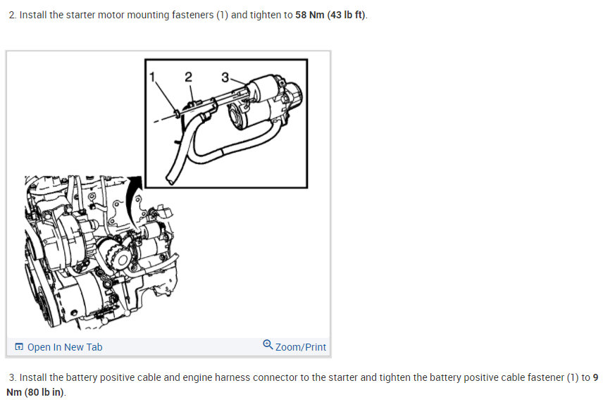

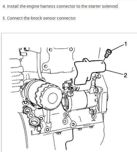

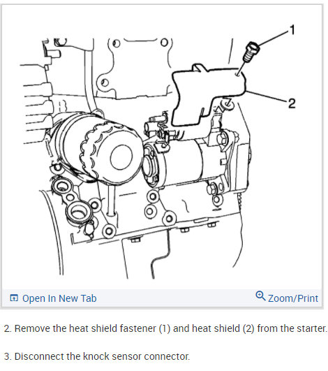

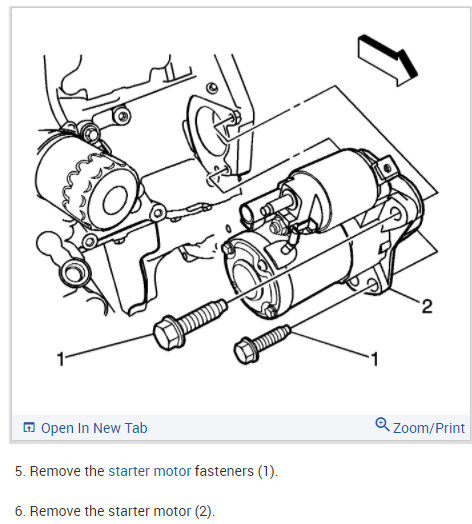

https://www.2carpros.com/articles/how-a-starter-and-solenoid-works

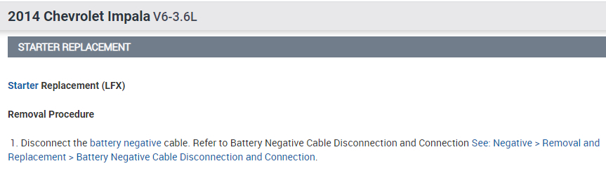

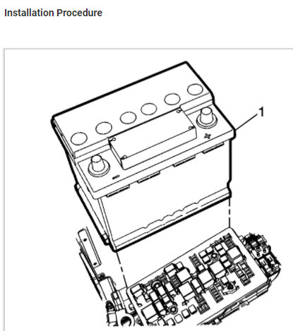

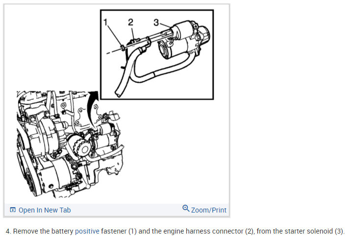

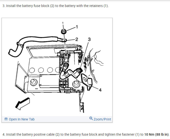

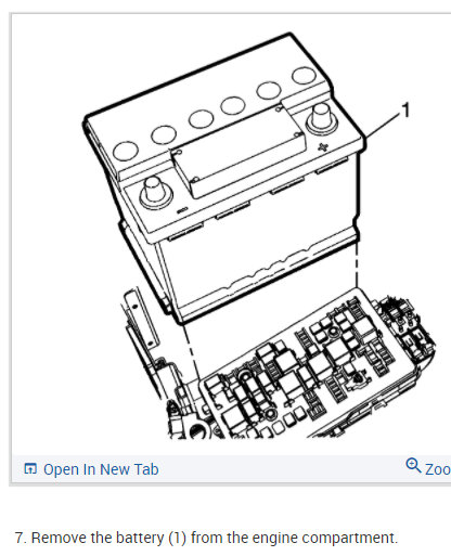

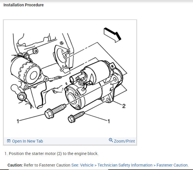

I've attached picture steps below on how to remove and replace your starter motor on your vehicle. Just like I stated in my last post you local auto parts stores will test a starter motor for free. Get back to us after performing these tests to see what you have found out regarding you battery, alternator, starter, and fuel pressure. Hope this helps and thanks again for using 2CarPros.

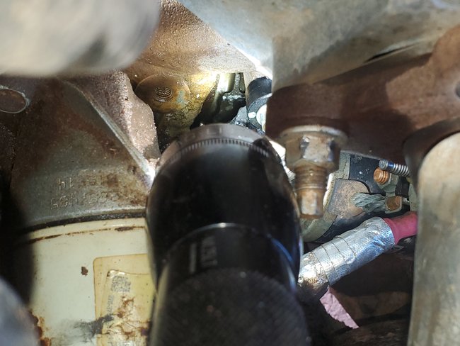

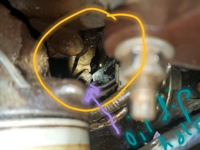

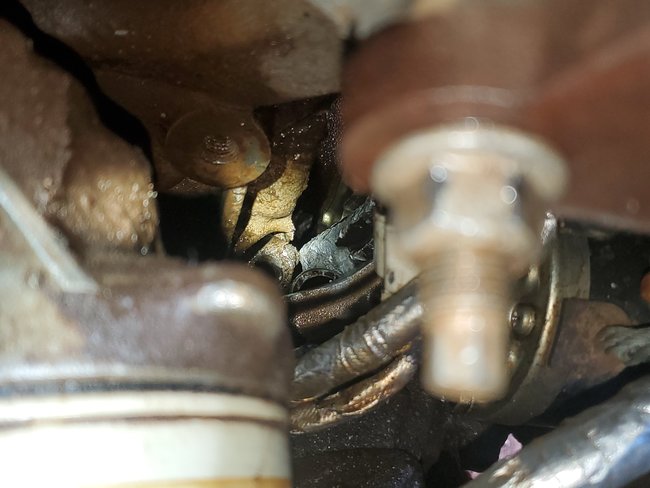

Hello, seems like my engine is cracked wide open.
Here is a picture of it right by where the oil dipstick connects.
Sunday, February 14th, 2021 AT 2:44 PM
DANNY L
  • 5,648 POSTS
Hello again.
That is not good. Can you you take a picture from higher above to see where this is located? Just use you cell phone again to upload a picture here. Hope this helps and thanks again for using 2CarPros.

The oil filter to the left and the starter to the right was going to take the positive wire off from the starter when I saw the crack.
Monday, February 15th, 2021 AT 6:02 AM
  • 110,055 POSTS
That looks like the engine block. It isn't something that can be repaired if I'm correct. The engine will need replaced. Let's see if Danny agrees.

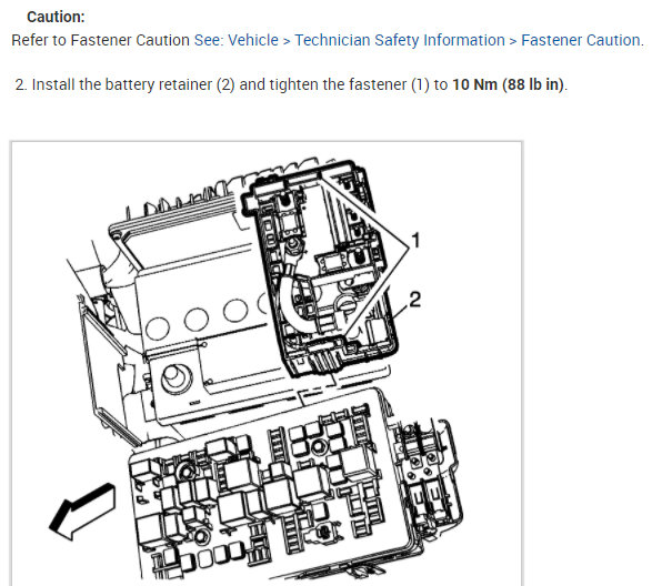

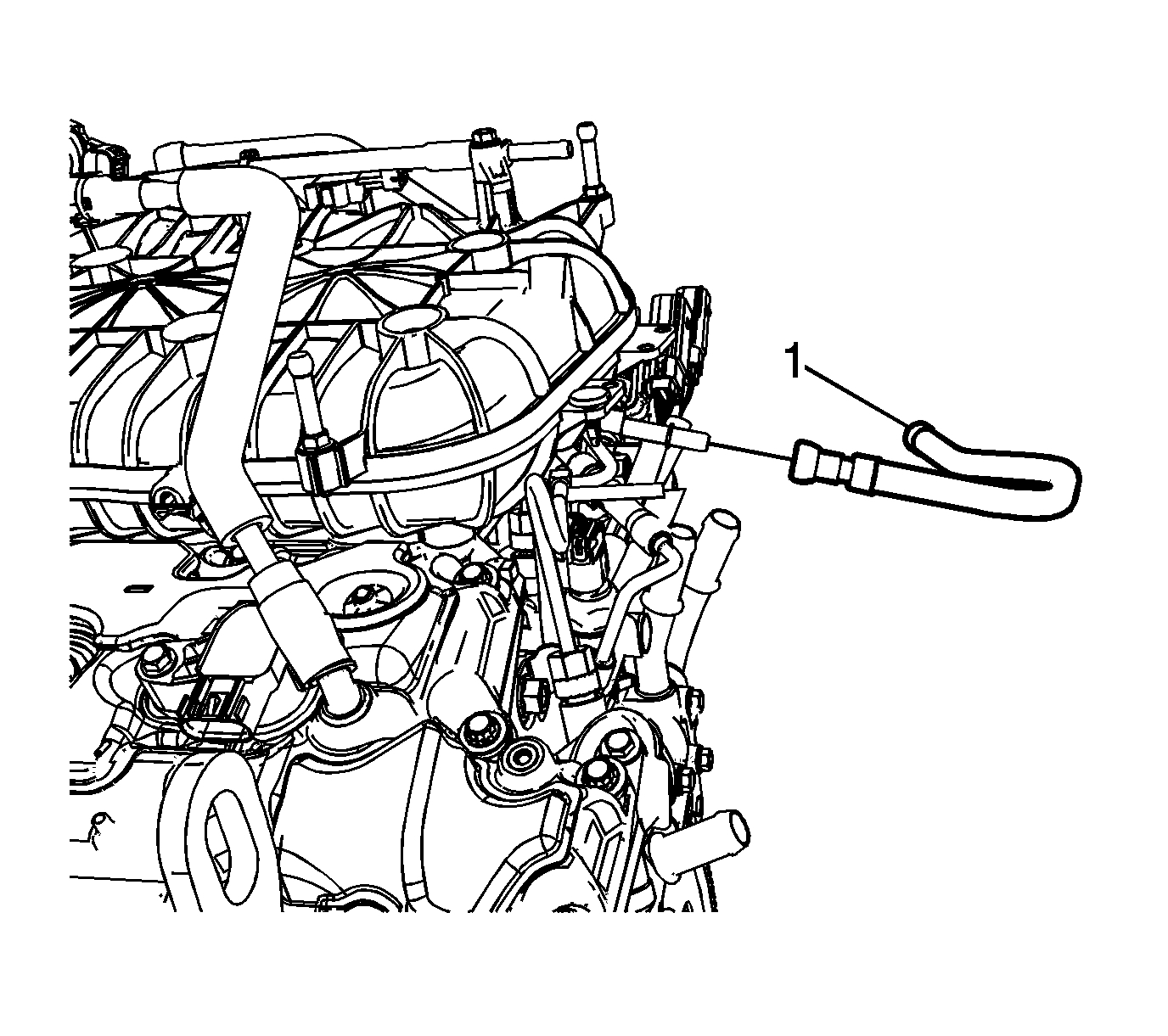

Pic 1

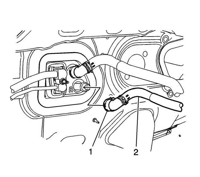

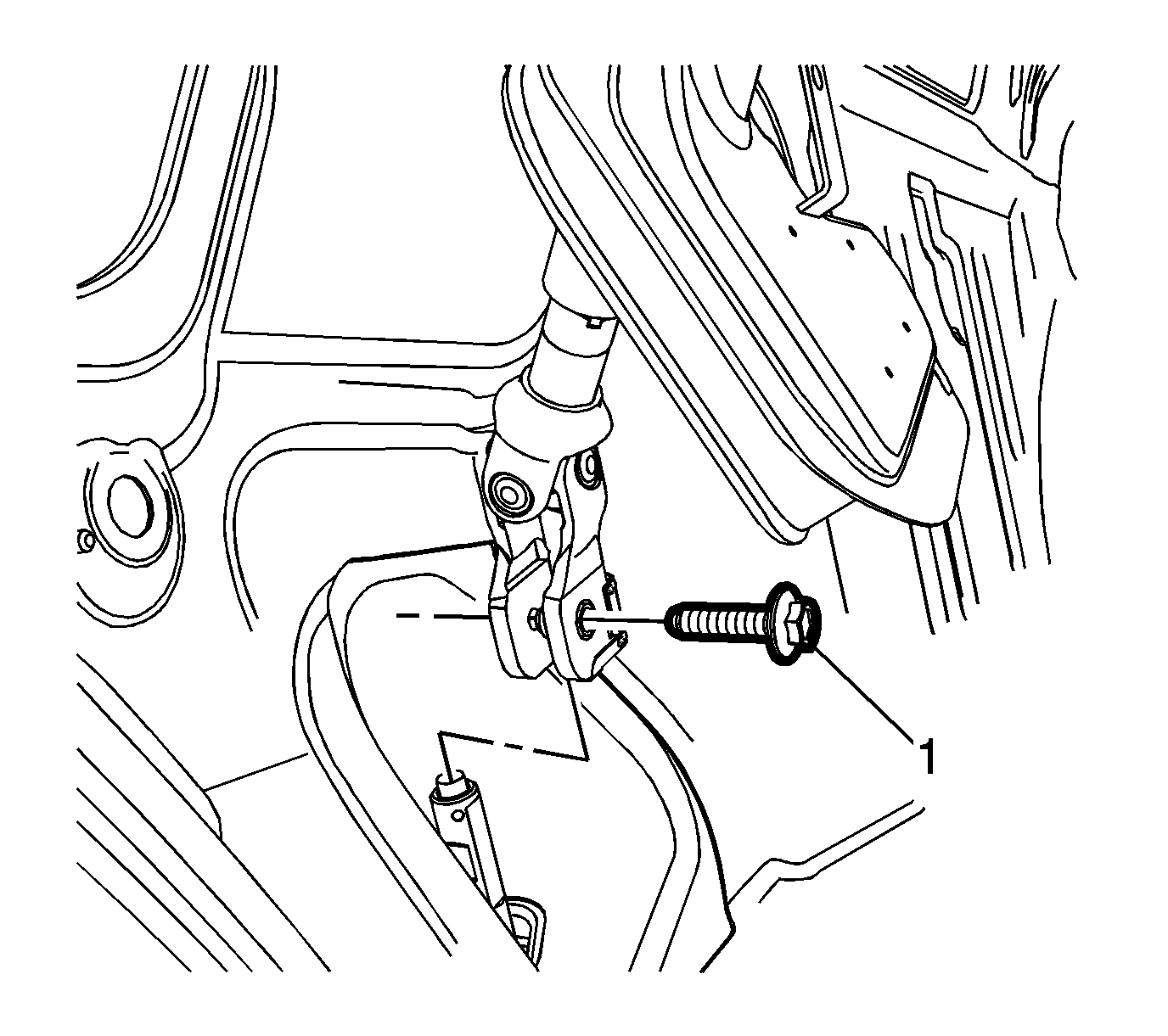

3. Remove the bolt (1) from the coupler and disconnect the steering shaft coupling from the steering gear. Refer to Intermediate Steering Shaft Replacement See: Steering Column > Removal and Replacement > Intermediate Steering Shaft Replacement.
Pic 2

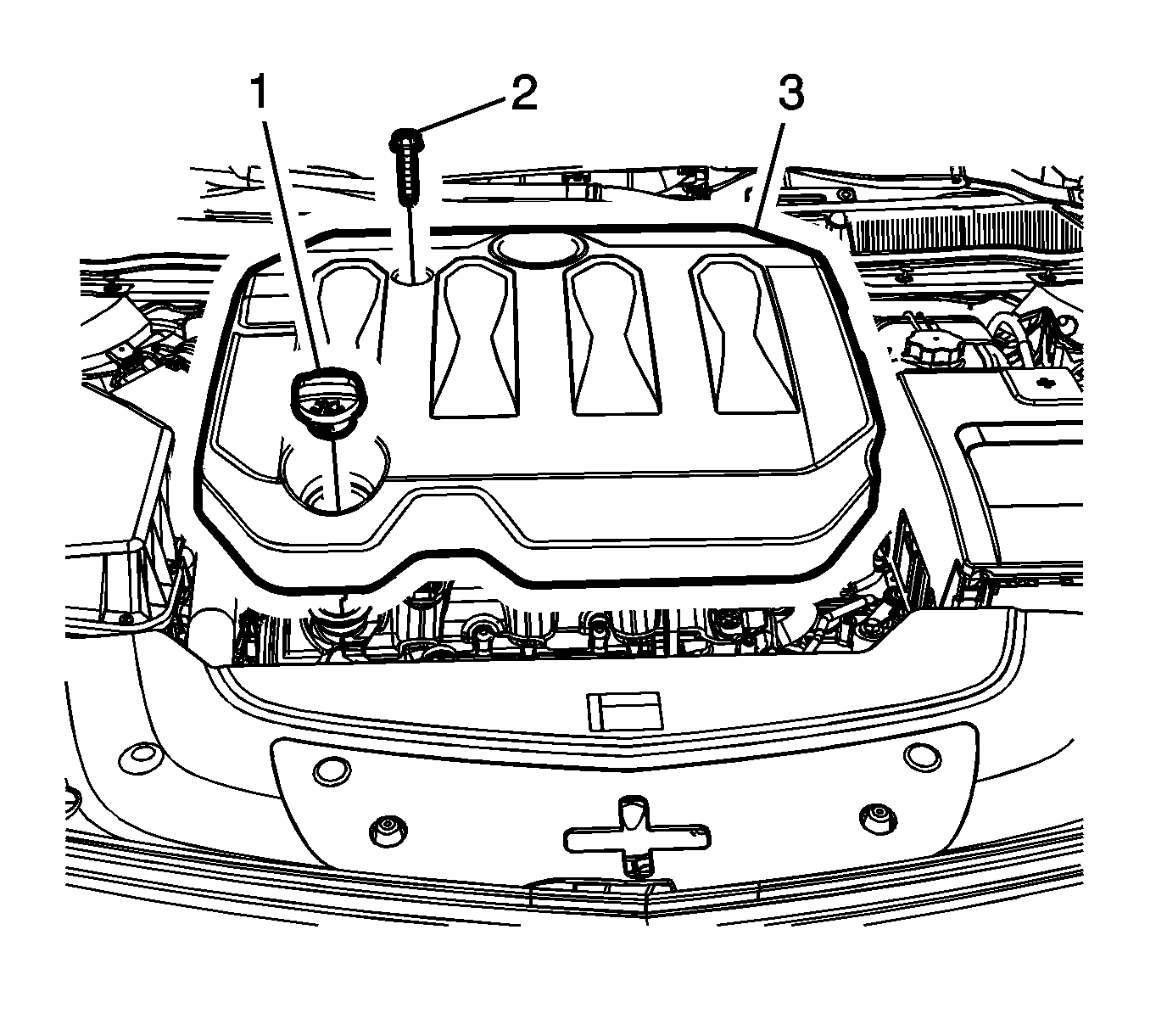

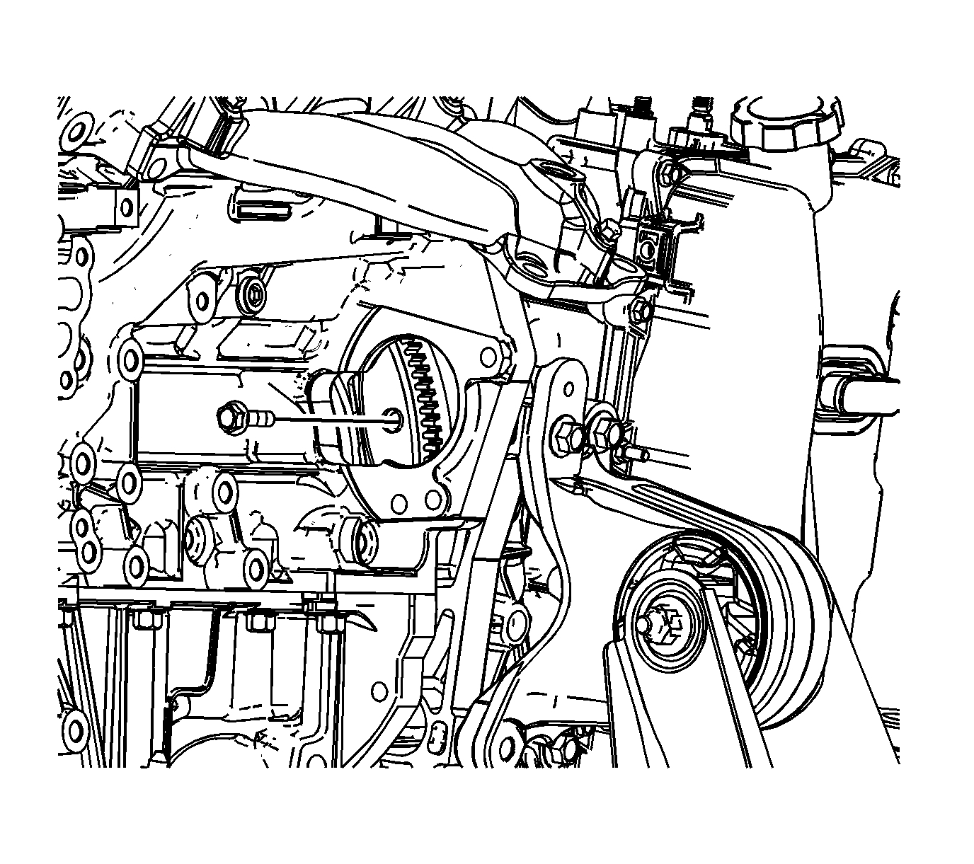

4. Remove the intake manifold cover (3). Refer to Intake Manifold Cover Replacement See: Intake Manifold > Removal and Replacement > Intake Manifold Cover Replacement.
Pic 3

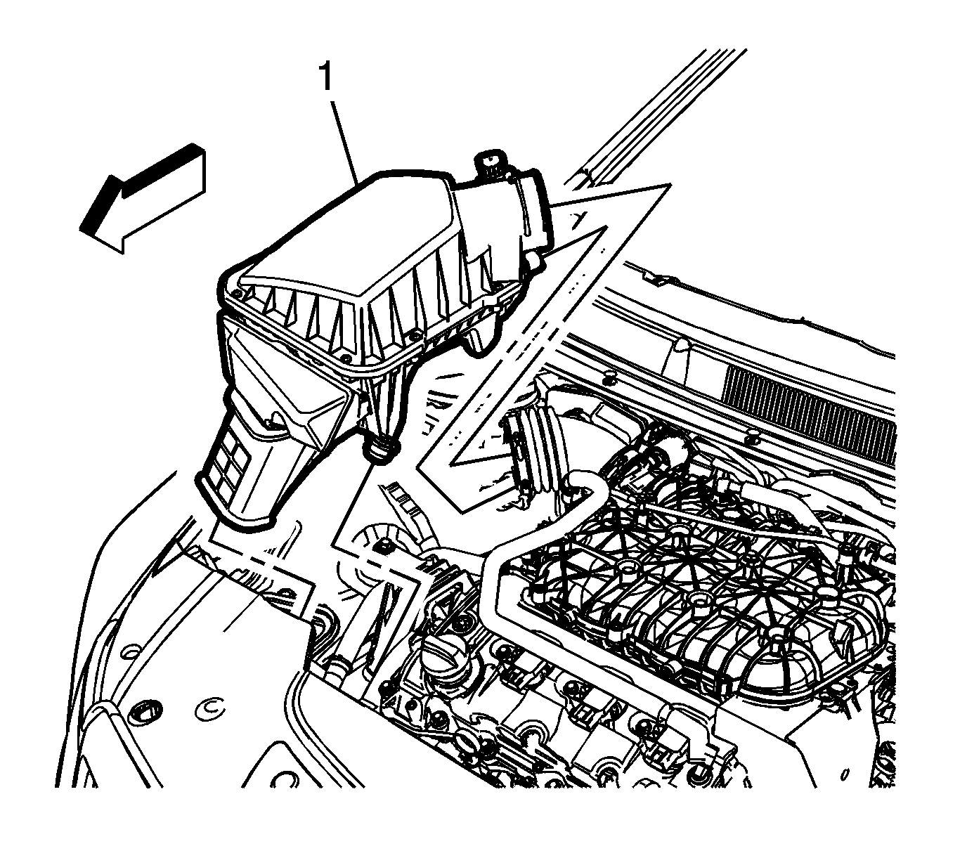

5. Remove the air cleaner assembly (1). Refer to Air Cleaner Assembly Replacement See: Air Cleaner Housing > Removal and Replacement > Air Cleaner Assembly Replacement.

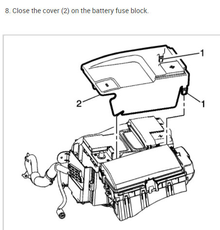

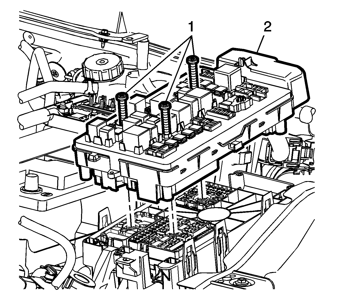

8. Remove the front compartment fuse block cover.
Pic 4
9. Remove the front compartment fuse block (2).
Pic 5

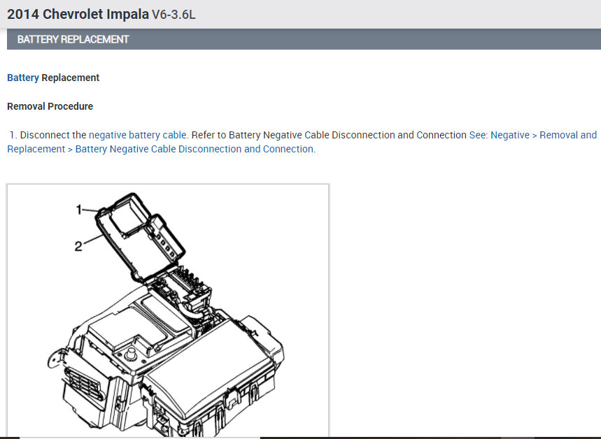

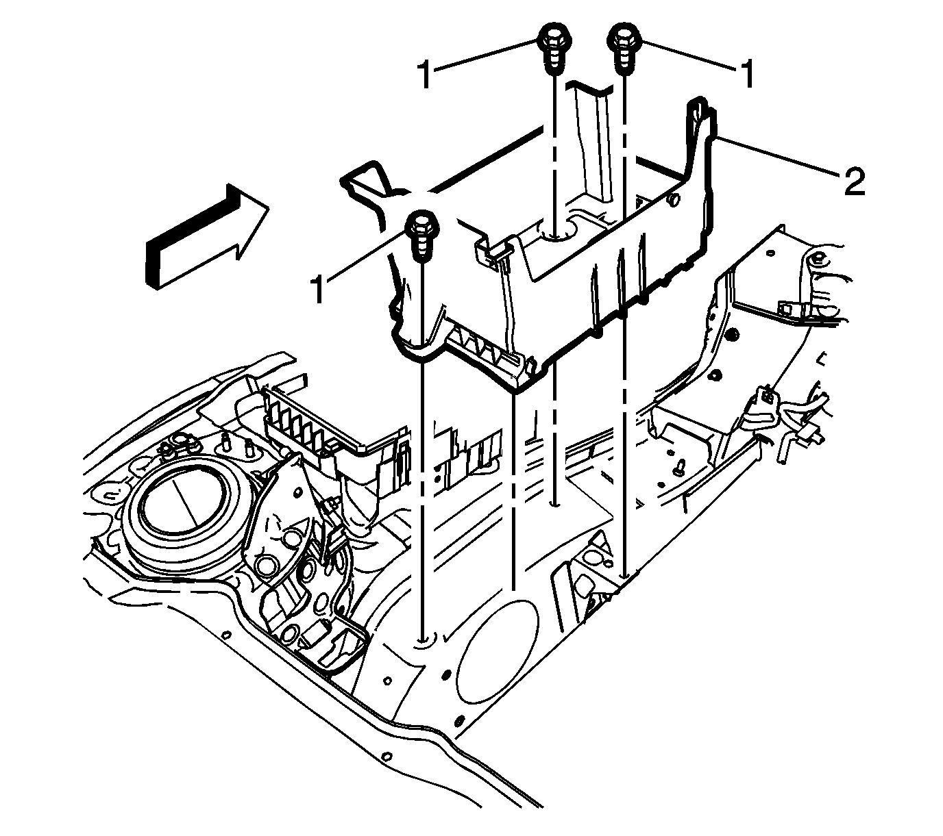

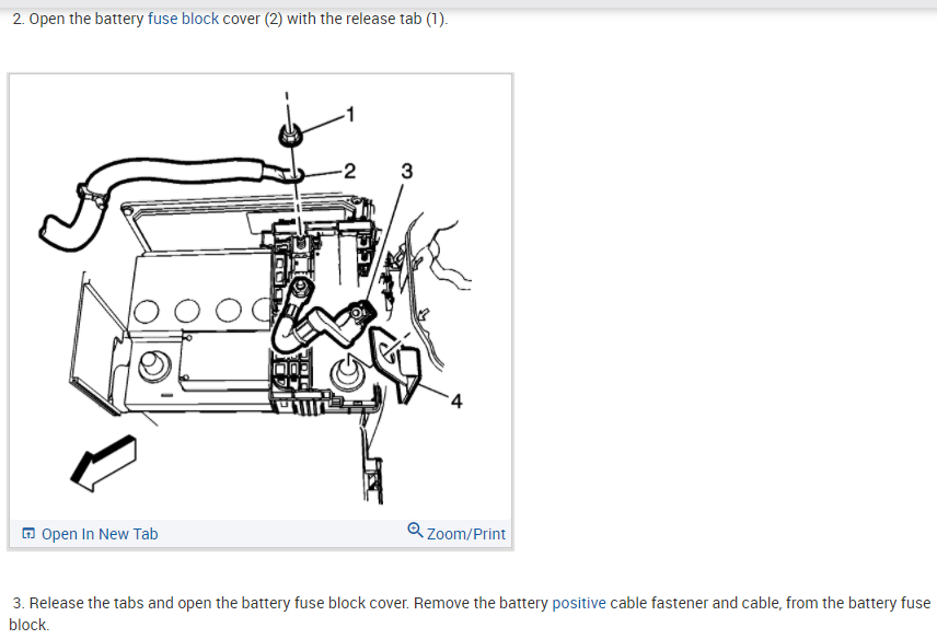

10. Remove the battery tray (2). Refer to Battery Tray Replacement See: Battery Tray > Removal and Replacement > Battery Tray Replacement.
Pic 6

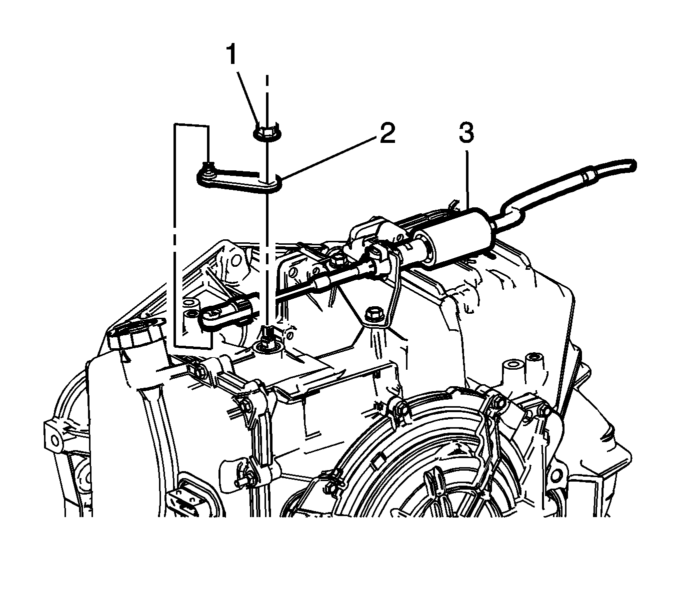

11. Disconnect the transmission shift cable (3).
Pic 7

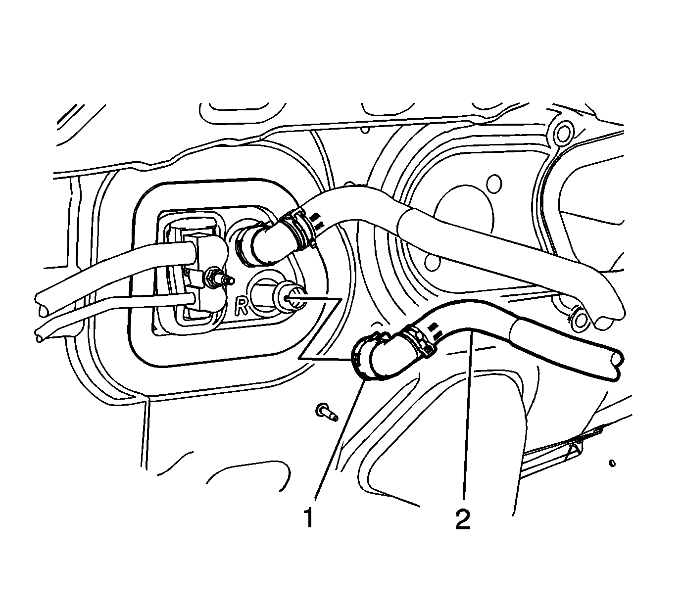

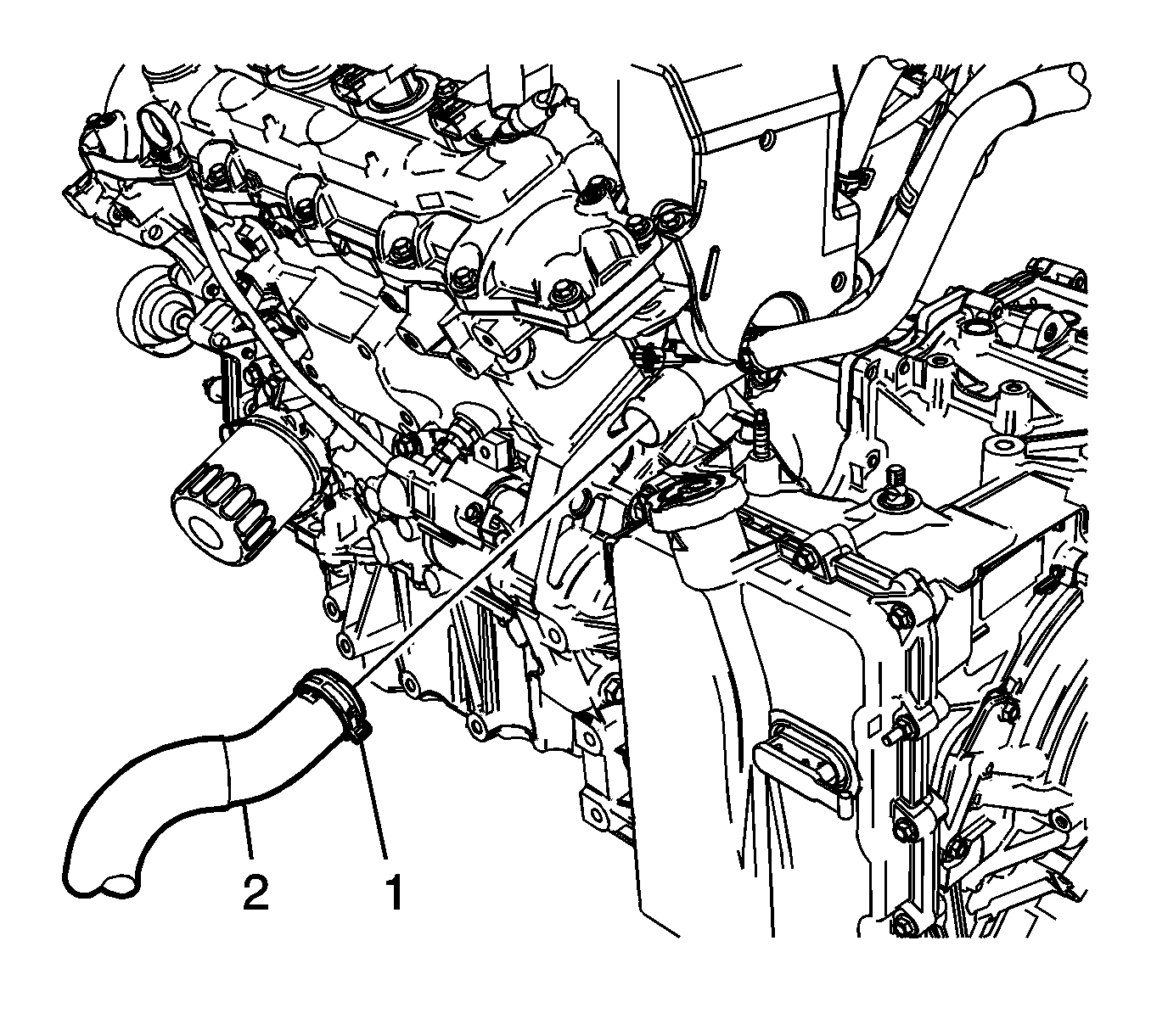

12. Disconnect the radiator outlet hose (2) from the engine. Refer to Radiator Outlet Hose Replacement (LFX) See: Radiator Hose > Removal and Replacement > Radiator Outlet Hose ReplacementRadiator Outlet Hose Replacement (LKW) See: Radiator Hose > Removal and Replacement > Radiator Outlet Hose Replacement.
13. Disconnect the radiator inlet hose from the engine. Refer to Radiator Inlet Hose Replacement (LFX) See: Radiator Hose > Removal and Replacement > Radiator Inlet Hose ReplacementRadiator Inlet Hose Replacement (LKW) See: Radiator Hose > Removal and Replacement > Radiator Inlet Hose Replacement.
Pic 8

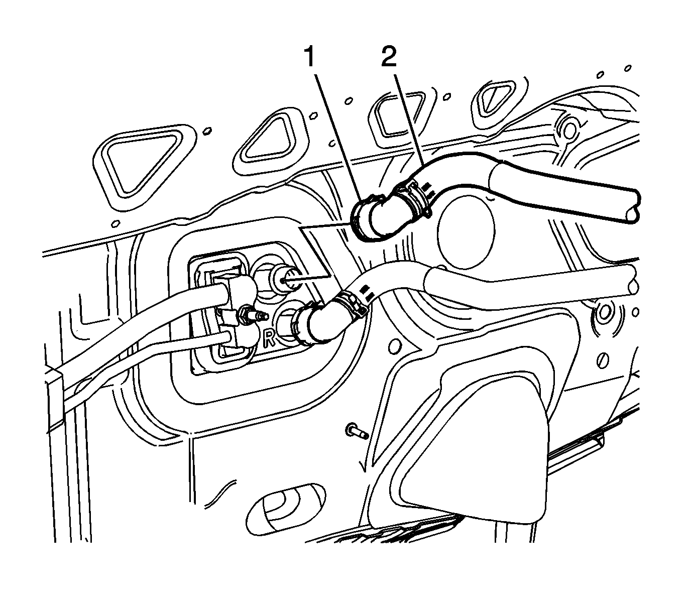

14. Release the clip from the quick disconnect (1) and remove the heater inlet hose (2) from the heater core tube.
Pic 9
15. Release the clip from the quick disconnect (1) and remove the heater outlet hose (2) from the heater core tube.
16. Remove the A/C connectors from the service ports.

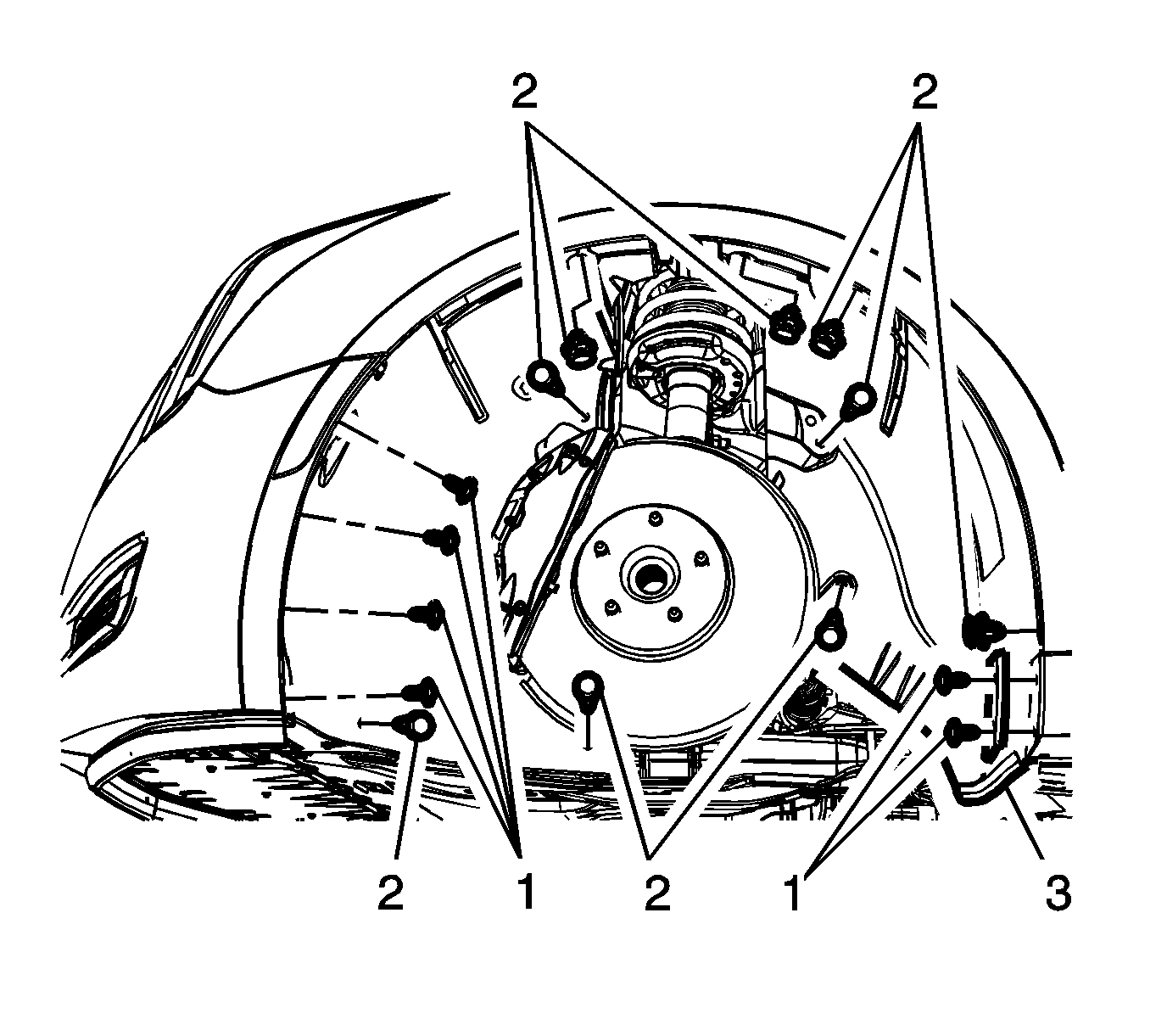

17. Remove both front wheels. Refer to Tire and Wheel Removal and Installation See: Wheels and Tires > Removal and Replacement > Tire and Wheel Removal and Installation.
18. Remove right side front wheelhouse liner. Refer to Front Wheelhouse Liner Replacement.

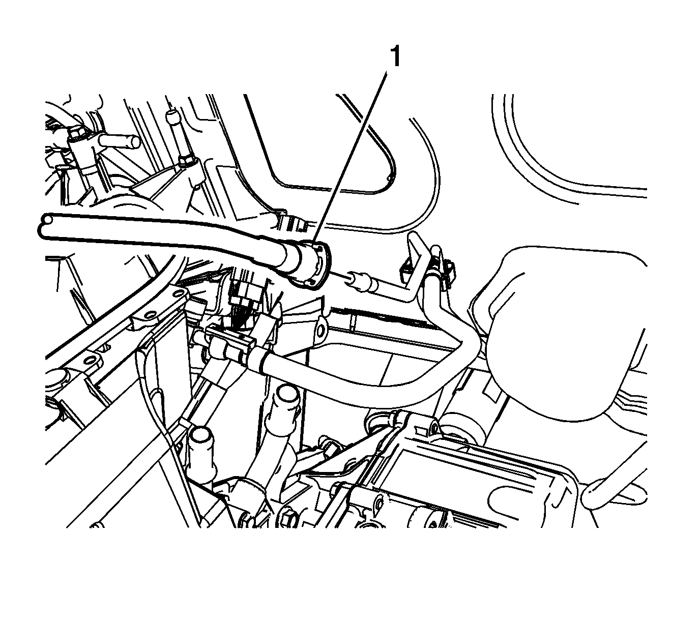

20. Disconnect the fuel feed line (1). Refer to Metal Collar Quick Connect Fitting Service See: Fuel Line Coupler > Removal and Replacement > Metal Collar Quick Connect Fitting Service.
21. Disconnect the fuel feed line from the engine bracket retainer.
Pic 11

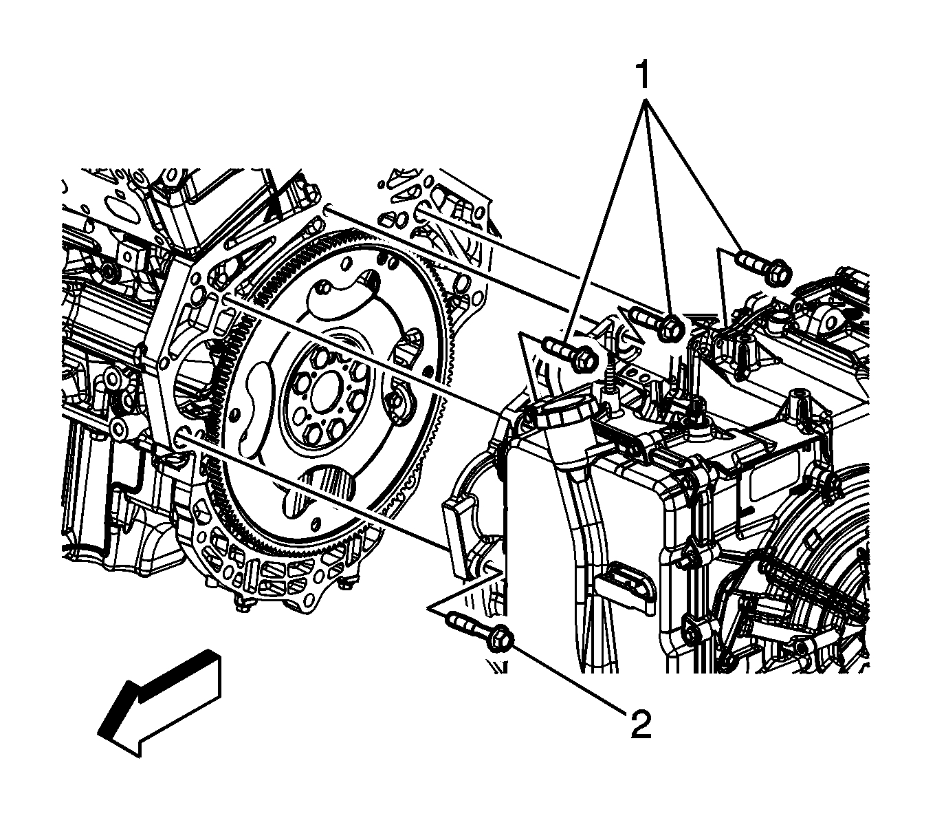

24. Mark the torque converter to flexplate relationship.
Note: Rotate engine clockwise using the crankshaft balancer bolt to gain access to each bolt.
25. Remove the torque converter bolts.

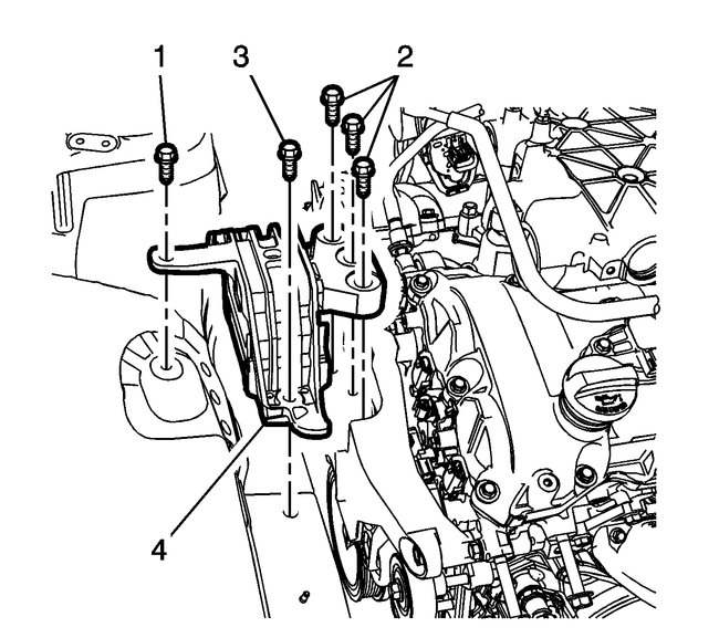

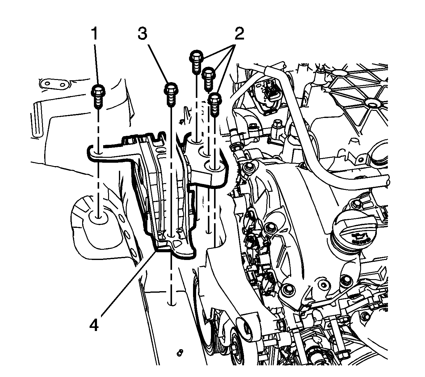

35. Remove the right side engine mount to engine bolts (2). Refer to Engine Mount Replacement - Right Side See: Engine Mount > Removal and Replacement > Engine Mount Replacement - Right Side.
36. Remove the left side transmission mount to transmission bolts. Refer to Transmission Mount Replacement - Left Side See: Transmission Mount, A/T > Removal and Replacement > Transmission Mount Replacement - Left Side.

8. Install the right side engine mount to engine bolts (2). Refer to Engine Mount Replacement - Right Side See: Engine Mount > Removal and Replacement > Engine Mount Replacement - Right Side.

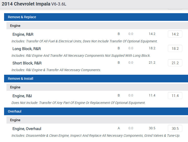

Wow, it's a lot to take out and put back in think im able to do that.
I did find an engine already.
Do you know how long it will take to remove and replace like hours?
Monday, February 15th, 2021 AT 5:42 PM
  • 110,055 POSTS

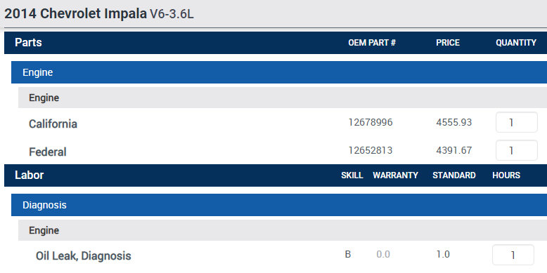

Flat rate is 14 hours. If you aren't experienced, it will likely take longer.

Yes, it looks like the engine block is cracked and those types of breakages cannot be repaired. Joe attached a great set of steps for replacement above. I've attached below what the repair guide give for time requirements. Hope this helps and let us know if you have any further questions on this issue. Thanks again for using 2CarPros.
