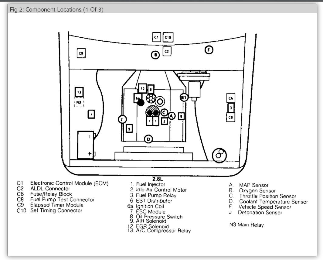

It sounds like the starter has gone bad. Lets use a test light and see if the starter solenoid receives a signal when the ignition key is in the crank position.

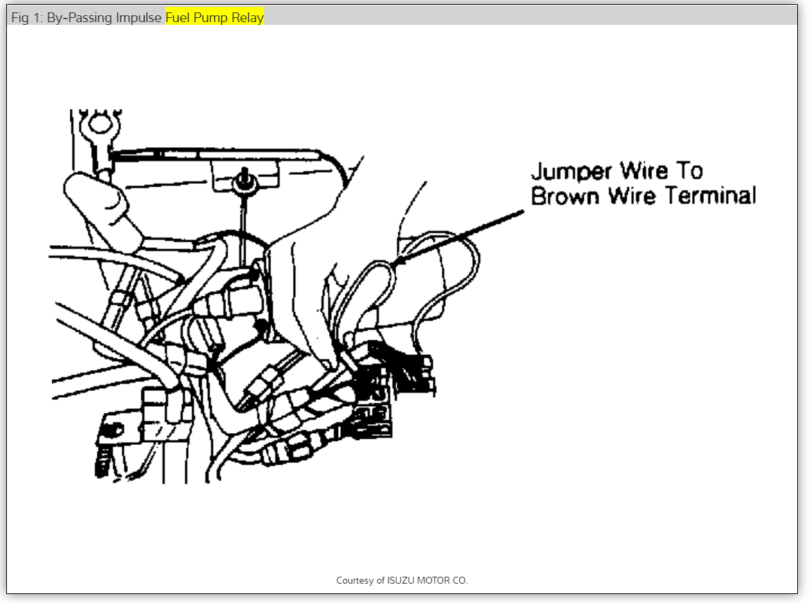

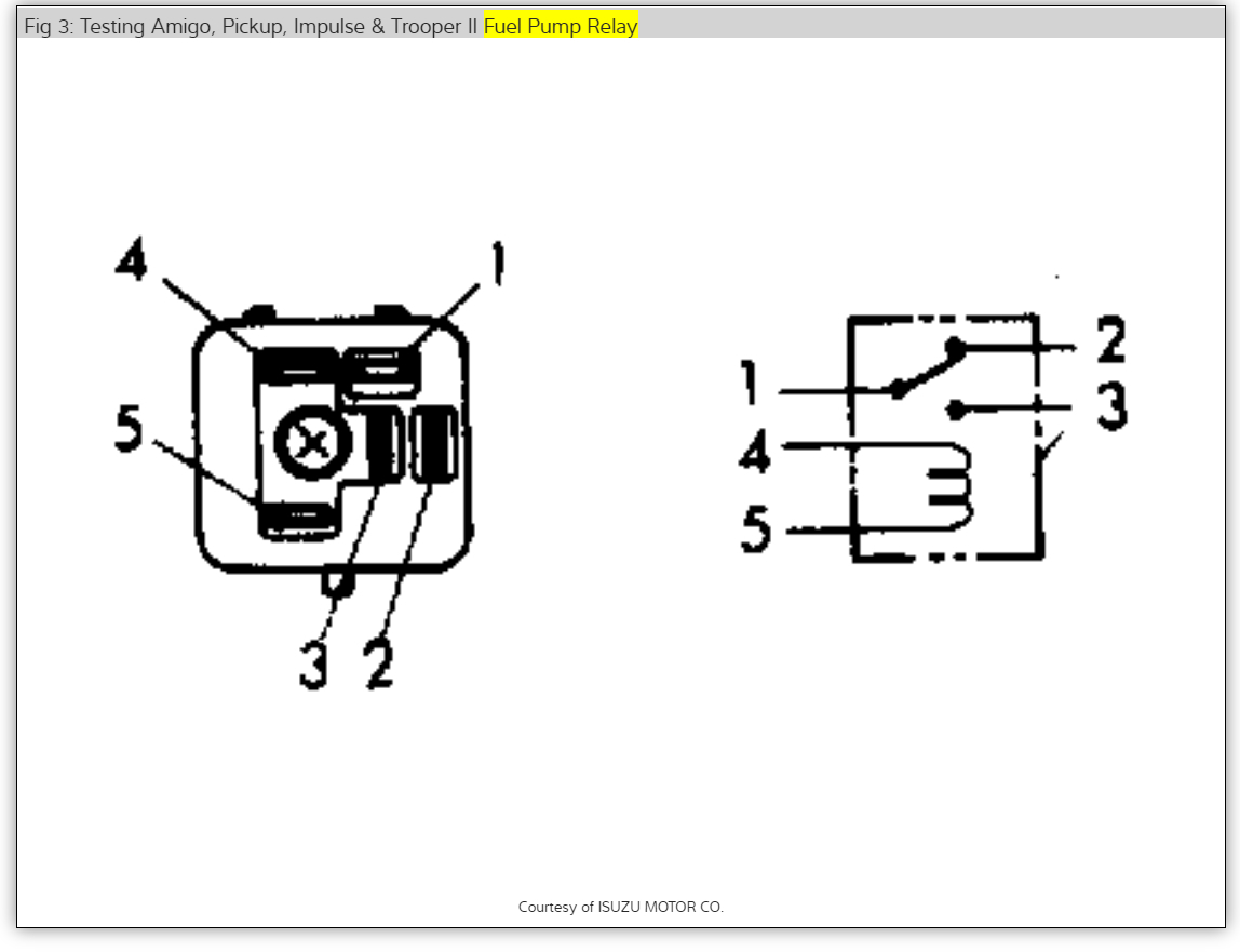

No. Starter works great. Engine turns over easily. Just no ignition. Jumped fuel pump because lines are dry. Next I'll jump the pump relay.I have no diagnostic tools so doing it old school

I would try replacing or jumping the ECM reply here is its location. (below)
Nov 6, 2017 at 3:28 AM
