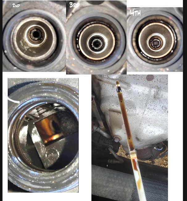

Okay. so, it's not the battery. I think it might be a blown head gasket or something like that. I can't tell if the engine oil is milky. I bought some $60.00 head gasket repair, but i don't know how i would try it if i can't start the car?

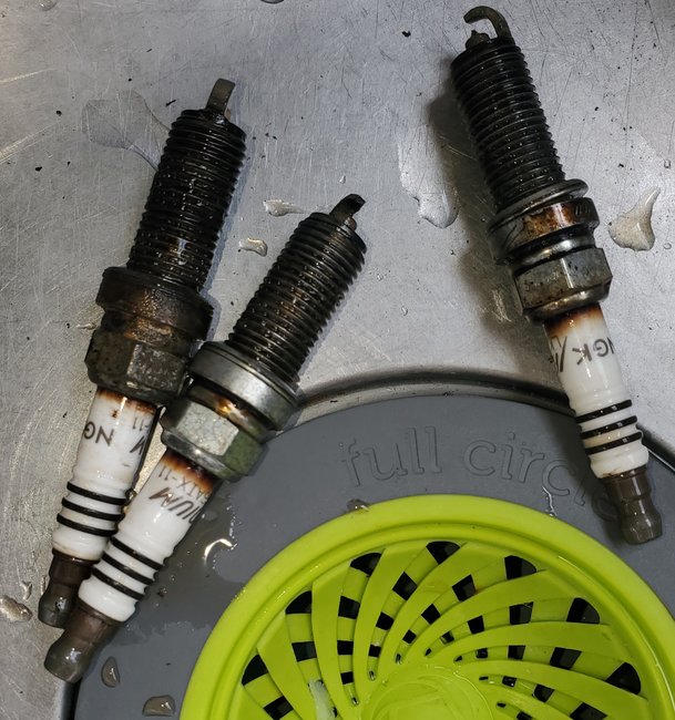

I checked the oil dip stick, the oil cap & below the cap. Also, i checked All 4 spark plugs and there is no leaking from the exhaust manifold. I Got new spark plugs to put in, brand new oil to put in fresh if i need to drain the old and a bottle of Bar's Head Gasket Repair.

Here is the 2nd, 3rd and 4th spark plugs... (that's not water or anything beside them i put them in cole and salt to clean them, but i got new ones to put in.
Oct 15, 2021 at 3:01 AM
So, there is info here that could lead us in a different direction, but I think you are correct that the plugs need to be changed.
You are correct that these plugs are fouled and need to be replaced. So, let's change those and see if the engine starts.

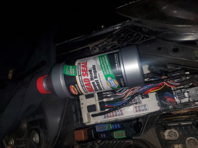

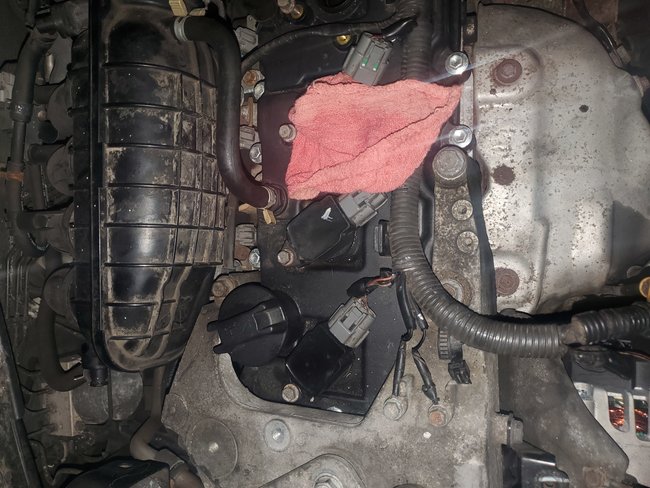

I changed the plugs and got a new battery, the reason why the car wouldn't start and the first place was it ran hot. when i was trying to start it i had cylinder 3 unplugged and the spark plug taken out and there was some liquid spouting up from there. i bought some Bars Head seal gasket repair and some new coolant. Should i put both in my radiator, put the spark plug back in and connect the ignition coil, then try to start it so it can maybe run long enough for the Bars Head Seal gasket repair to run through the system and fix the leak or just work in general?
Oct 18, 2021 at 9:32 AM
DUWHOP31
  • 151 POSTS
Or should I put the Bars Head Seal Repair in then the coolant and leave #3 cylinder without the spark plug and ignition coil connected?

Okay. That is great info.
No, I would not use that at all at this point. If you had fluid coming out that could have been fuel, so we need to start by replacing the plugs, starting the engine, and testing for a blown head gasket.
Here is a guide that will help with this:
Also, you should do a compression test to find out if you are losing compression as it sounds like we have a warped head.
If we have a warped head, then it is unlikely that this chemical additive will fix it at this point.
If we confirm this and you want to try it then that is fine but if it doesn't work at least, we know what needs to be done.

Okay. so, i changed the spark plugs and put the coils back on and tried to start it. It cranks but it will not turn over. I sprayed some starter fluid in the intake and still same thing. Like it wanted to start but didn't turn over.
Oct 19, 2021 at 4:51 AM
Okay. So just a little more background on this. When this started, it was after it got hot and overheated? Then when you topped it off is when the water was spilled? However, this would not restart after the engine got hot?
If that is the case, then we need to just jump right to a compression check. It may not be a compression issue but if we don't check that and confirm it is not that issue then we will be chasing our tail.

But i tried turning the crankshaft pulley by hand and it did turn... i have new oil so i decided to drain my current oil and from the top you can't tell but oil the drain plug it looks like chocolate milk. Now that i have all spark plugs changed radiator filled up should i add the nee oil and try to start it?
Oct 20, 2021 at 2:52 AM
So, I think we have confirmed what happened. You appear to have a warped head and most likely have no or not enough compression which is why it is not starting.
You need air, fuel, spark, and compression in order to get the engine started.
Milky oil means you have water in it and that would have only come from the coolant. The only what that happens is if you have a head gasket pushed out or a warped head.
There are some other causes but when you had an overheat and a no start, then a warped head and no compression makes the most sense.
https://www.2carpros.com/articles/coolantantifreeze-in-the-engine-oil
I know this is not what you want to hear but I am pretty sure that is the issue. If you want to get a video of what it sounds like when you are cranking the engine, they normally make a distinct sound, and we can try and confirm it further that way.
