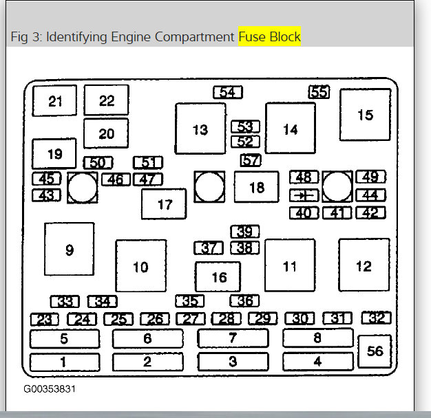

The car doesn't even try to crank so I know it is not the VAT problem. Brand new battery, ignition cylinder, and ignition switch. all the accessories work fine. car has run fine before this and is serviced properly. what else should i look at? i am stumped.

Did you check the IGN SW BAT 1(40A) fuse in the Underhood Fuse Block in the left hand side of the engine compartment? I have included diagrams in the diagrams below for you as well as a link down below for you to go to:
Please go through the guides and get back to us with what you are able to find out please.
If okay it sounds like the battery is weak or the starter has gone out but to be sure lets check out these guides, they can help us fix it
and
Check out the diagrams (Below). Let us know what happens and please upload pictures or videos of the problem.

i had not checked that yet, but i have spent today verifying all fuses and relays in all three fuse boxes are good. what else could it be?
