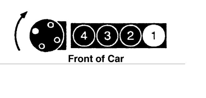

Car will not start replaced distributor, rotor, battery, and fuel pressure it good. getting spark, but BC the distributor is 1989 and the motor is a 1995 d16y8 which firing order is right? On the distributor.
Jun 14, 2017 at 4:07 PM
  • 55,770 POSTS
Here is a firing order for the car and a guide with a diagram (below) to help you get going in the right direction.
Firing Order: 1 - 3 - 4 - 2
Please run some tests and get back to us so we can continue helping you.
