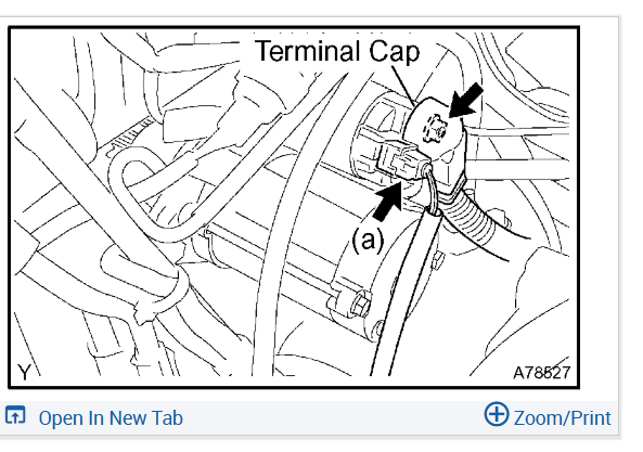

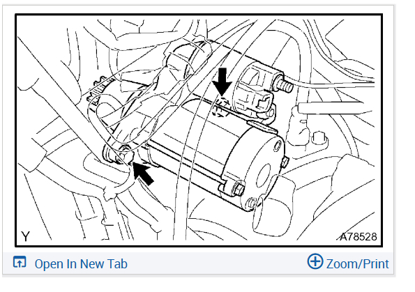

Yesterday my van would not start, or crank over. Does NOT click (sound) when you turn the key. Lights and electrical work. Battery tested to be at 12.5 volts. I bought a NEW battery (4) months ago. We jump stated it and it started right up. I drove it home 30 miles. Shut it off at home. Then tried to start it again…It would NOT start up.
Then this morning I tried to start it…It wouldn’t start again. Then I popped the hood hatch to check out the Fuses. I tried starting the van. BUT NOW The starter is in the staying Engage motion. (continues running). I quickly took off a battery cable and it STOPPED.

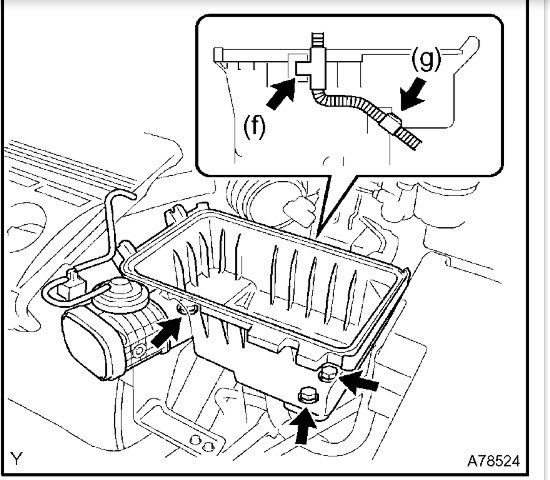

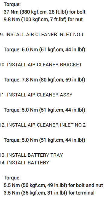

The staying engaged part says the battery is weak, so I would remove it and have it tested it maybe defective. If it tests okay I would install a new starter motor. Here is a video to help and I have included a basic guide to help you change the starter out with instructions below to help you with your car.
https://www.youtube.com/watch?v=6YRW8fyNudY&pp=0gcJCaMLAYcqIYzv
and
https://2carpros.com/articles/how-to-replace-a-starter-motor/
Check out the images (below). Please let me know what happens.
