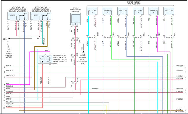

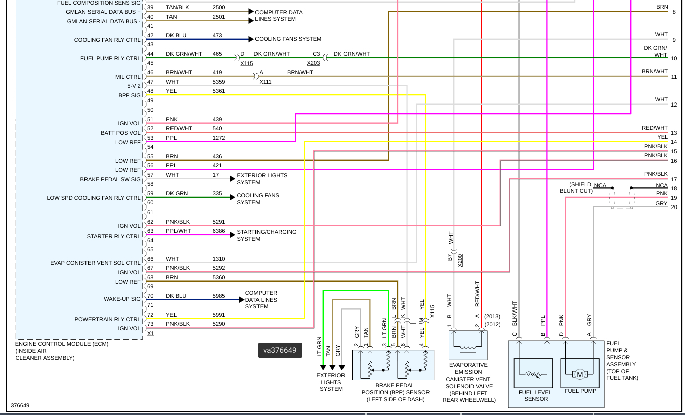

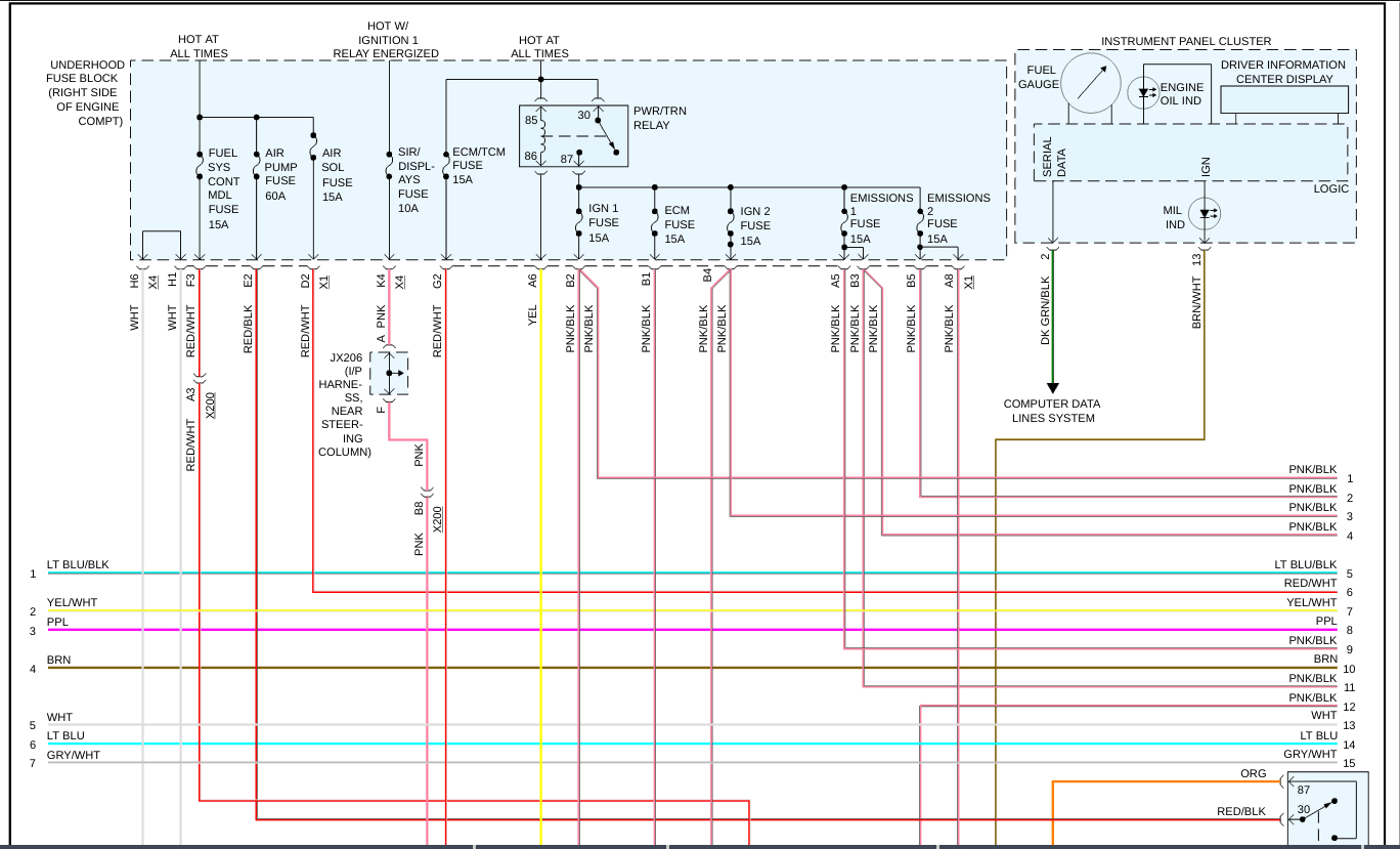

Starting disabled throttle flash on my dashboard. But I scan my codes and it said it was my ECM. I need the engine wiring diagrams so I can see how the system works.

Here are the engine wiring diagrams and a guide, so here is a link below to a guide explaining how to test the connections, if needed:
Check out the diagrams (Below). Please let us know what you find. We are interested to see what it is.
