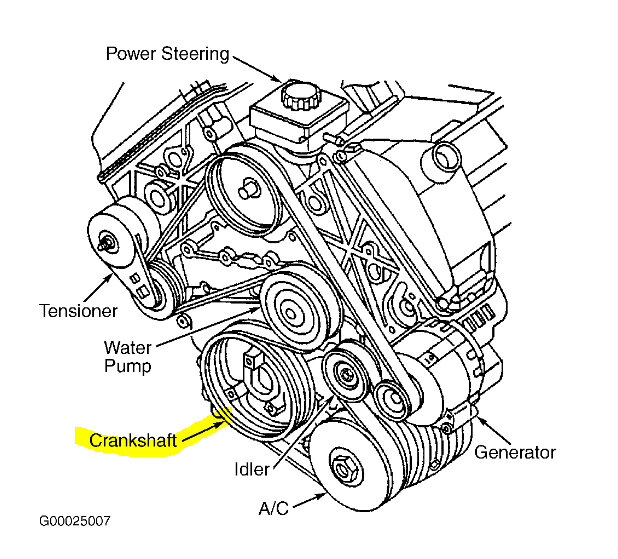

Hi, I had someone change my radiator and now it doesn't start. It sounds like it ran out of gas but has gas. Can someone please help? Thanks in advance.

There is a chance that the crankshaft position sensor was disconnected or damaged when the radiator was being installed.
Do me a favor. Check to see if there is spark to the plugs.
Here is a link that explains how it's done:
https://www.2carpros.com/articles/how-to-check-for-ignition-spark
Let me know what you find.

Can you please send me a picture please of where it's at? because I feel like he connected stuff wrong. I know very little about cars but I'm willing to learn and try because I can't afford to take it to a shop. Thank you, I appreciate your help.
Mar 12, 2023 at 8:32 AM
  • 110,248 POSTS

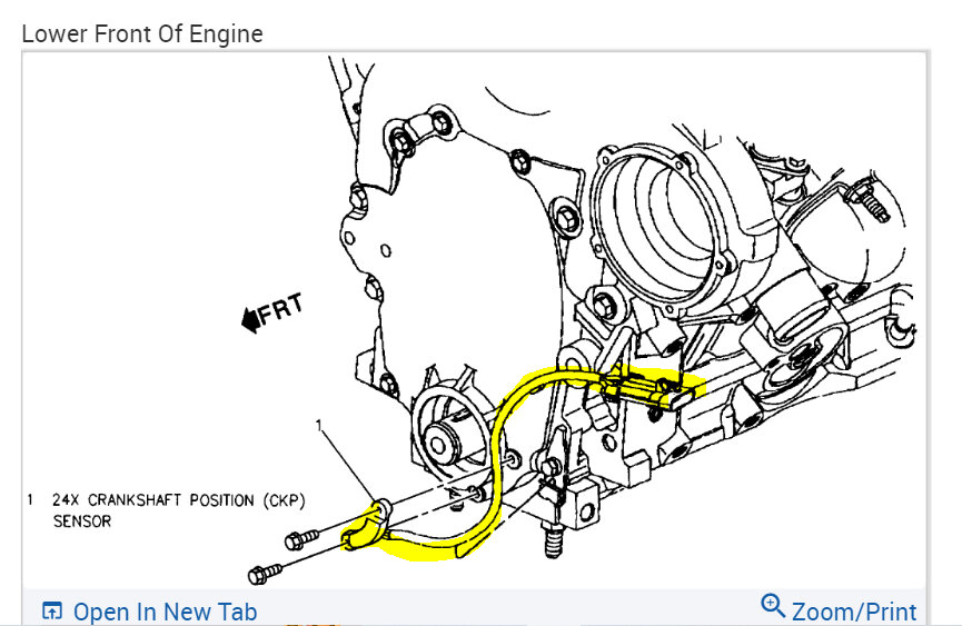

The sensor is at the front of the engine. I attached a pic below showing it, but the pic is from my manual and is somewhat vague.
In the pic, you are seeing the front of the engine without everything attached to it. Things that are missing are the belts, alternator, p/s pump, and so on.
I highlighted the crank sensor and the connector. When you look for this, look all the way down at the bottom of the engine where the belt is driven by the crankshaft pulley. See pic 2.
Let me know what I can do to help you.
