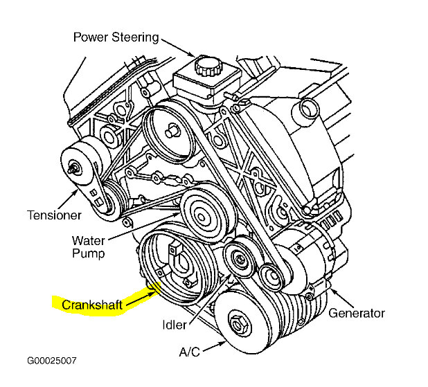

Can you please send me a picture please of where it's at? Because I feel like he connected stuff wrong. I know very little about cars but I'm willing to learn and try because I can't afford to take it to a shop. Thank you, I appreciate your help.
Sunday, March 12th, 2023 AT 3:32 PM
  • 109,867 POSTS

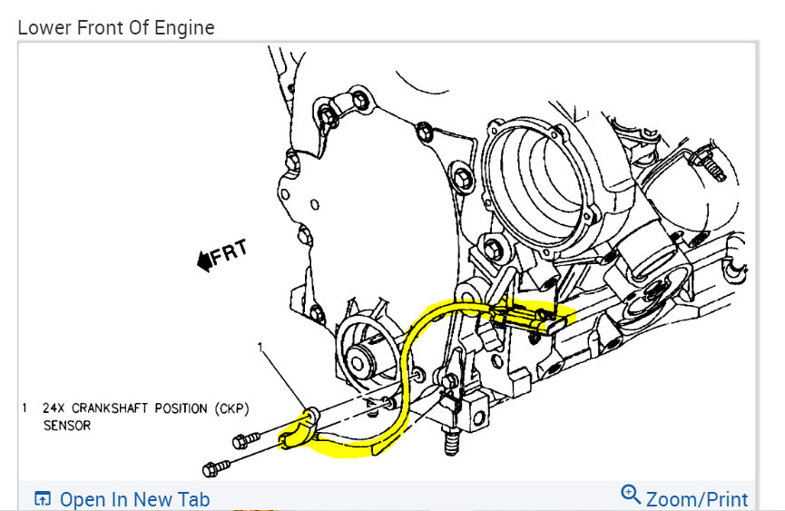

The sensor is at the front of the engine. I attached a pic below showing it, but the pic is from my manual and is somewhat vague.
In the pic, you are seeing the front of the engine without everything attached to it. Things that are missing are the belts, alternator, p/s pump, and so on.
I highlighted the crank sensor and the connector. When you look for this, look all the way down at the bottom of the engine where the belt is driven by the crankshaft pulley. See pic 2.
Let me know what I can do to help you.
