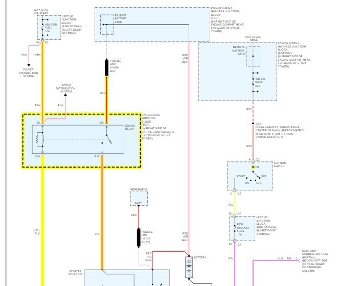

Turn key to start nothing happens no power . Turn key to access. Power comes on . Battery is one year old terminals are clean and tight. Alternator is outing out at 13.v. This happens approximately 2-3 times a week. After cont.trying it starts?
Jun 28, 2021 at 12:43 AM
Good afternoon,
This sounds like the starter has a dad spot. Each time it lands on the spot it will not start until it is moved around.

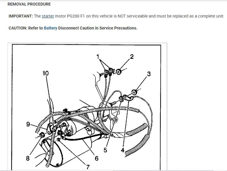

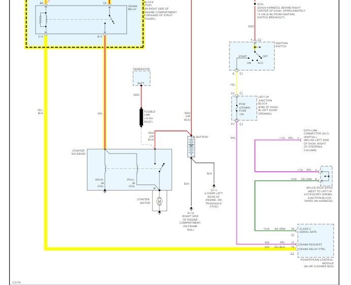

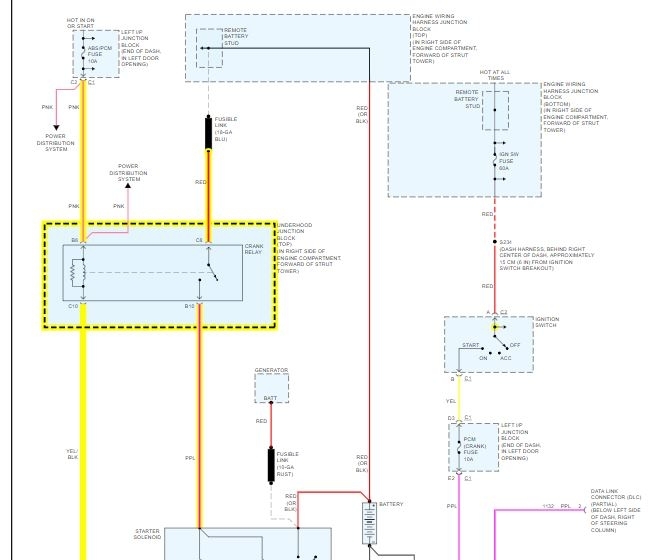

I attached a wiring diagram for you to view. Test the little wire on the solenoid for power when it does not start.

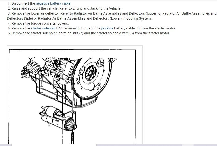

I also included the procedure for replacing the starter.
