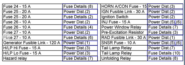

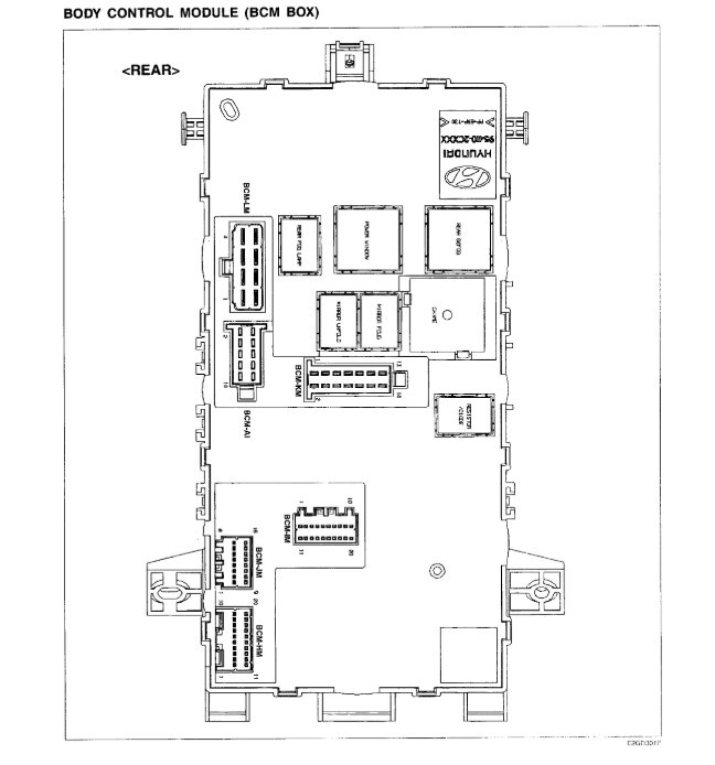

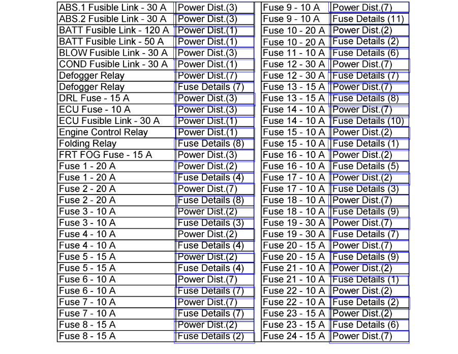

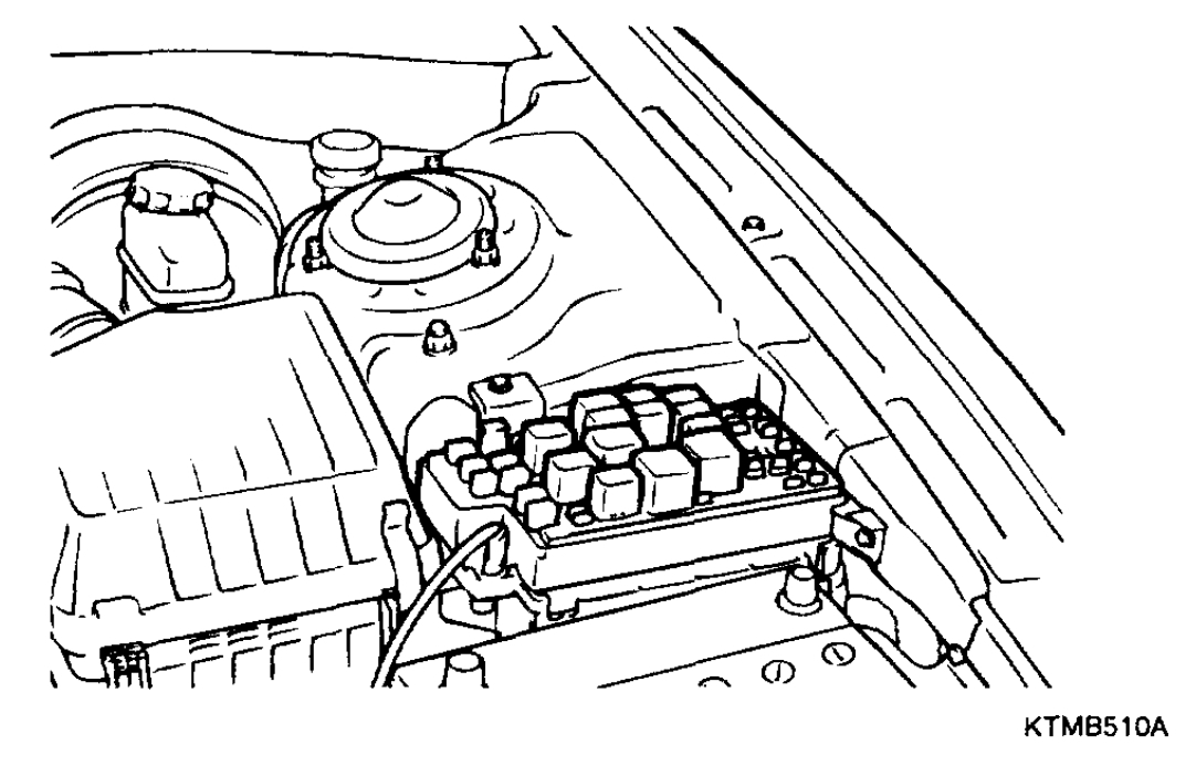

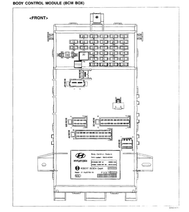

It is possible there could be loose ground wire connection recheck all the ground wires connections and plug in connectors you unplugged when removing the transmission, or it have blown an ECM or fuel pump fuse or relay. I'm attaching fuse block details and links below for you to reference. Please let us know if this was helpful and what fixed the vehicle.
