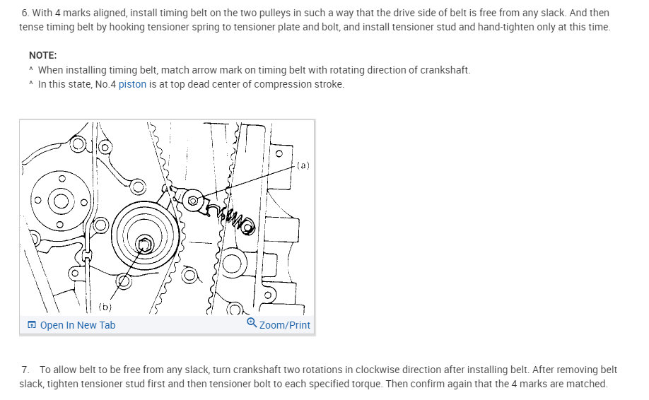

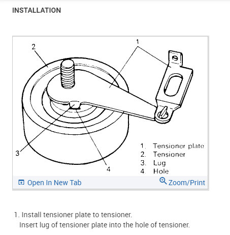

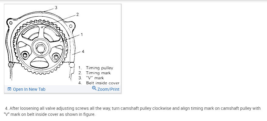

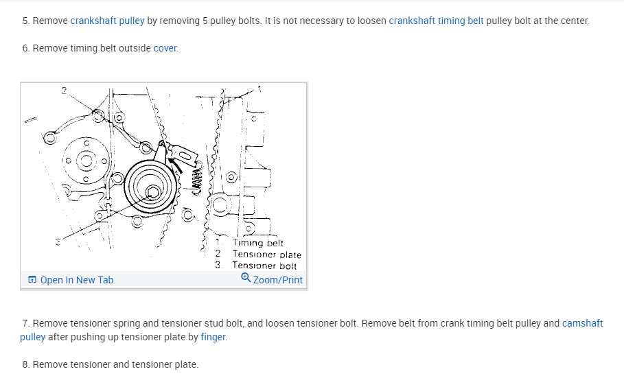

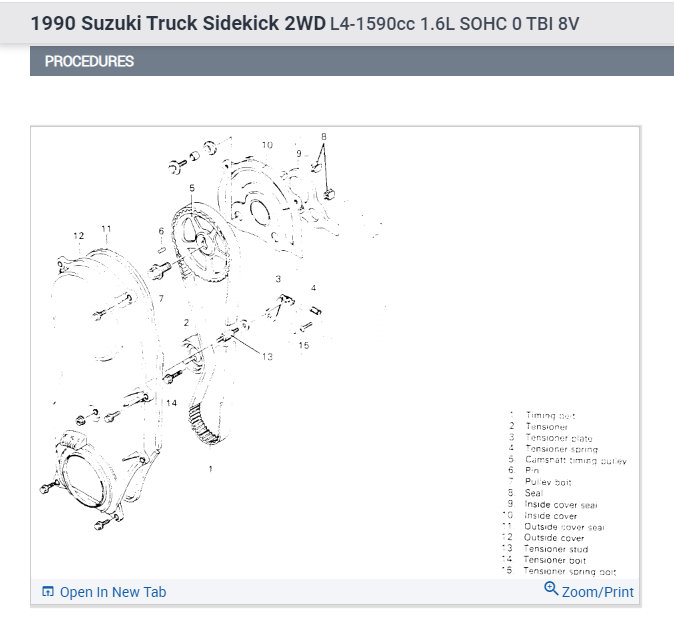

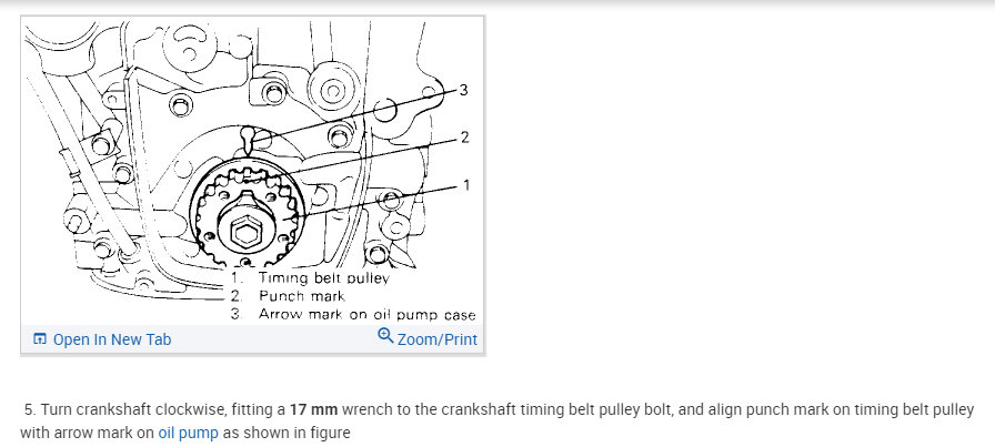

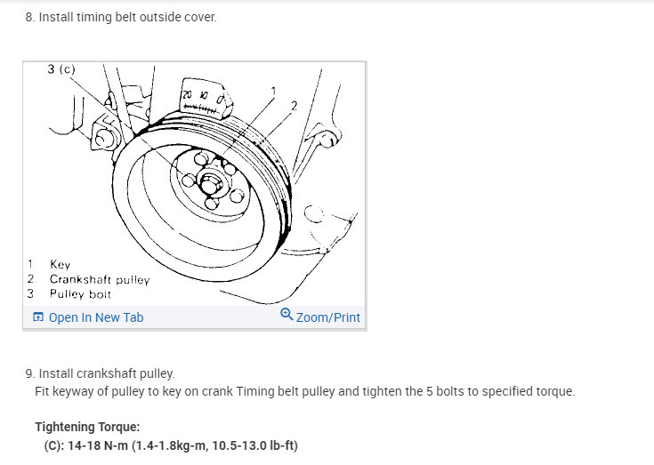

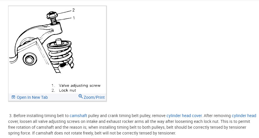

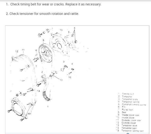

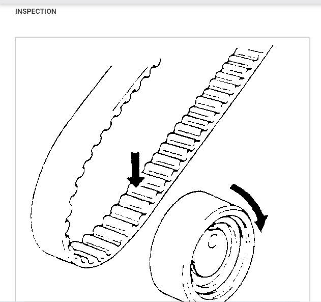

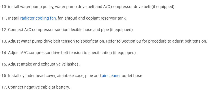

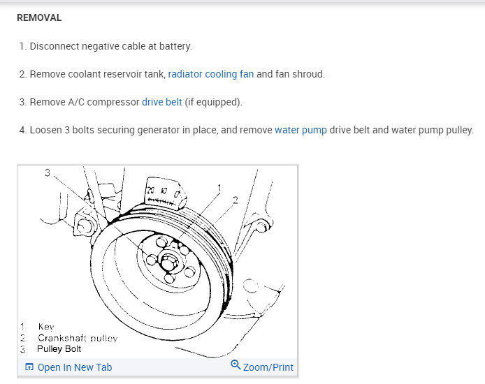

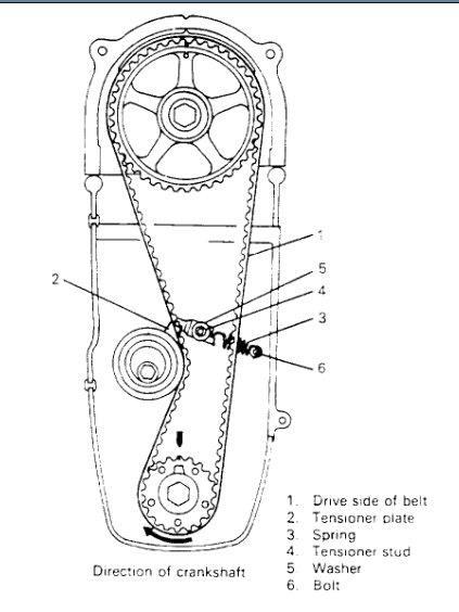

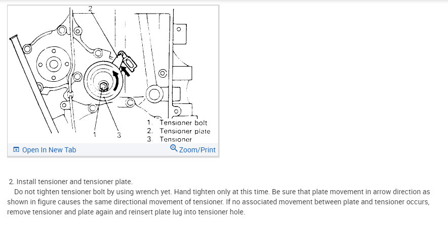

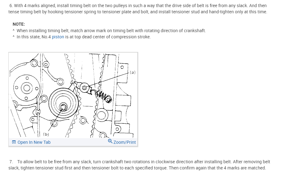

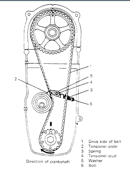

That isn't good news. I was questioning that toward the end of my reply. On a good note, this has an 8-valve engine, so nothing was damaged internally. If it was the 16 valve, you would be looking for a different engine.
Regardless, I attached the directions below for replacing the timing belt. It really isn't too bad of a job on this vehicle.
Let me know if this helps or if you have questions.
