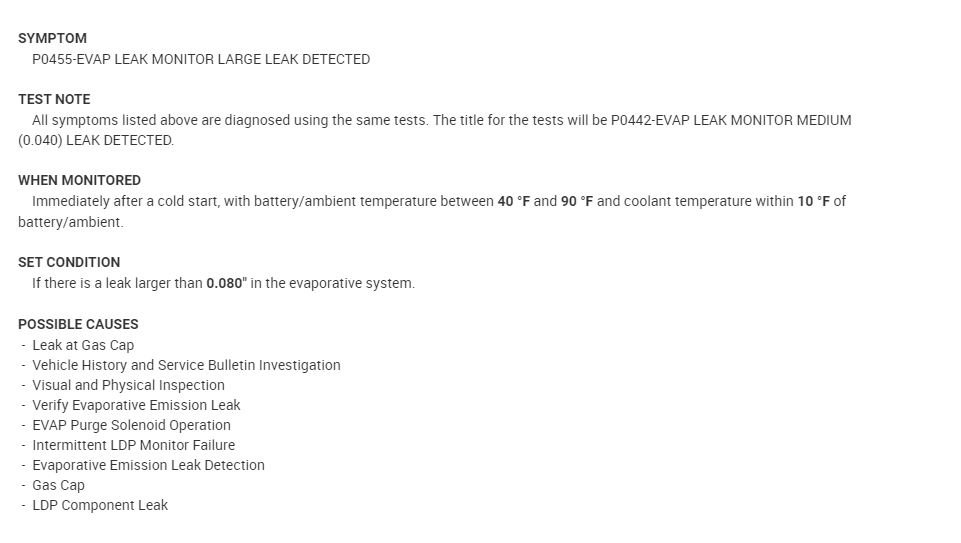

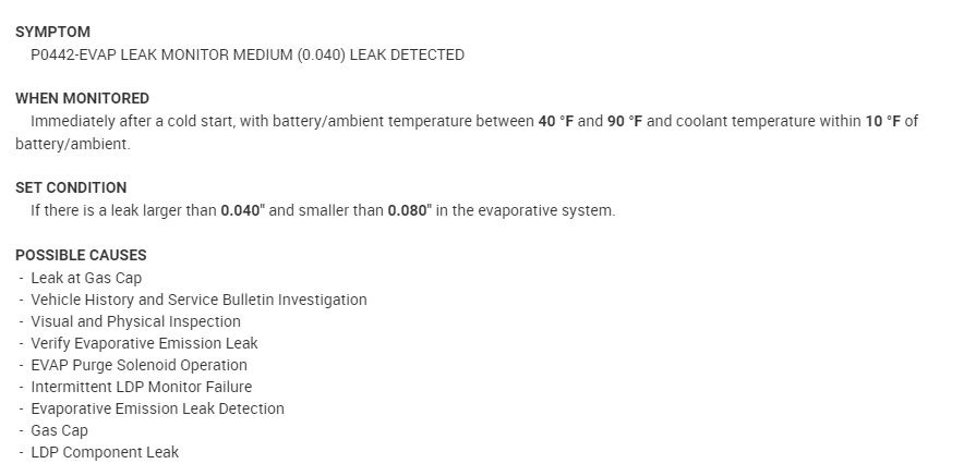

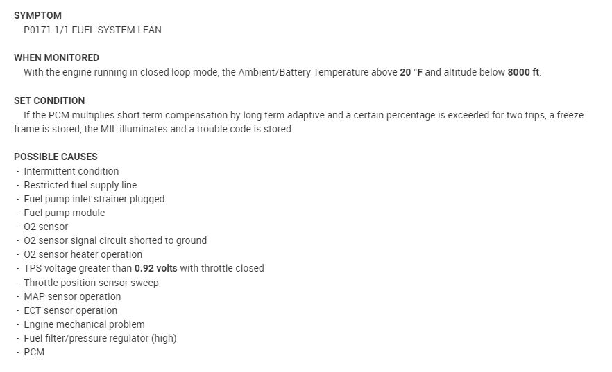

Put a new radio smelled something shut truck off. Started to drive in the morning and shut off will not start. Codes p0171, p0455, p0442 and p0420.
May 20, 2020 at 3:13 PM
Good morning,
Does the engine crank over?
Can you hear the fuel pump run when you turn the key to the on position?
Did you check for spark?
As far as the codes, the 420 is a bad catalytic converter.
I attached possibilities for the other codes below. None of them are related to no start.
