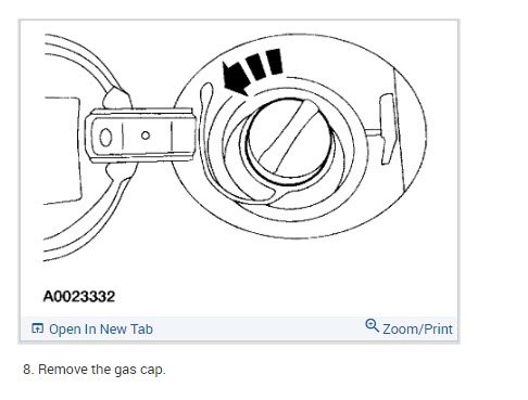

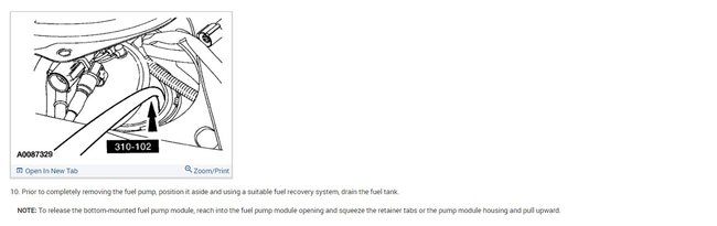

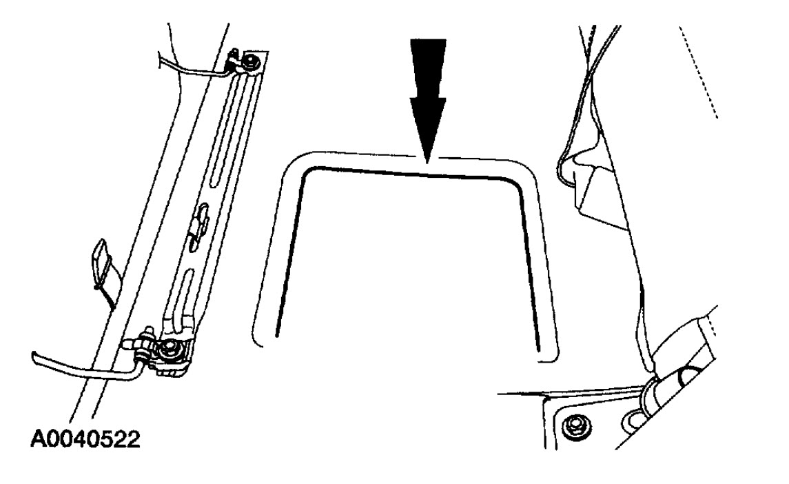

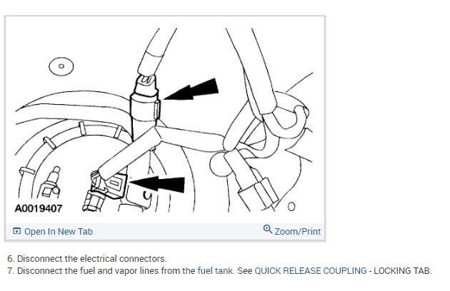

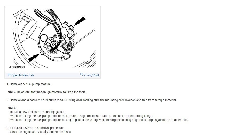

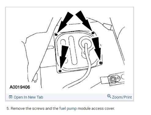

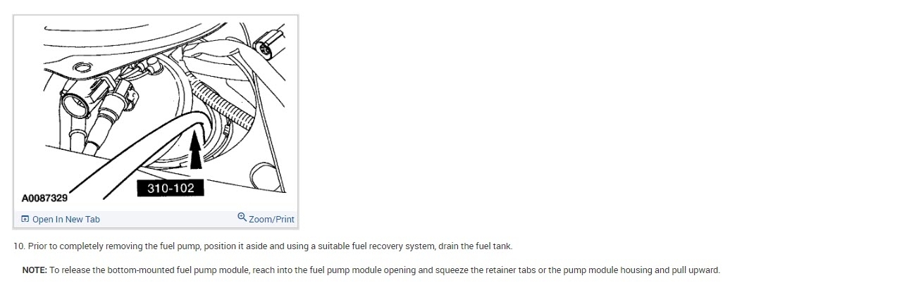

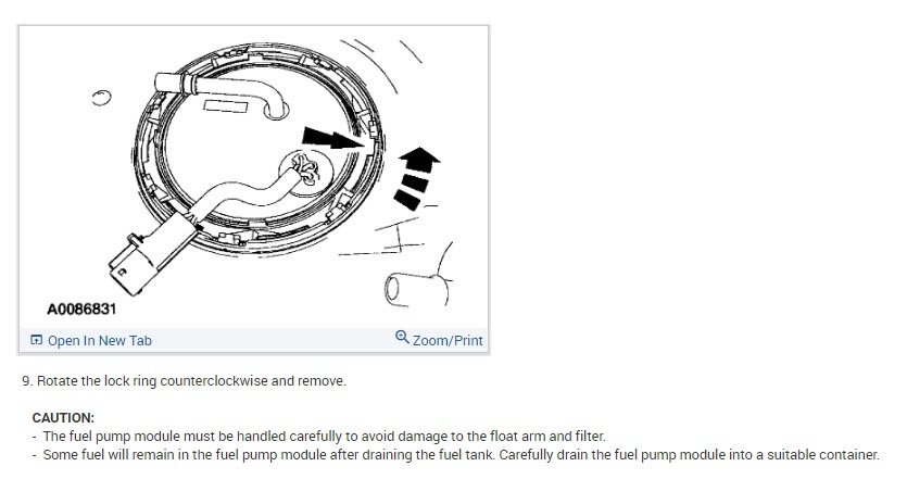

You can get it from either the filter, or at the fuel injector rail from the line coming into it. If you lift up the driver side rear seat, there will be an access panel for the pump itself, you can access it there but be careful of getting fuel on your seats or carpet. Here the instructions for the pump removal and installation in case this is your problem:

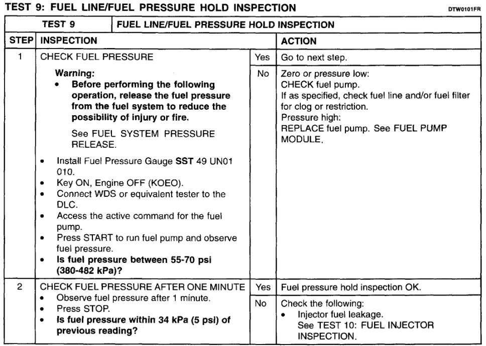

Can I check and see if the fuel pump is working at the fuel rail?
Nov 16, 2020 at 3:47 AM
BMDOUBLE
  • 1,139 POSTS
You can do it easier at the location under the left rear seat, but yes with a gauge so you can verify pressure. 35-55 psi is the specification. https://www.2carpros.com/articles/how-to-check-fuel-system-pressure-and-regulator

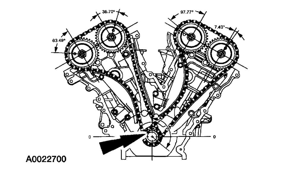

If it jump time that will cause it not to start also right? I look at the timing chain it seem to turn when it was cranking but could have something broke in there that i can't see.
Nov 16, 2020 at 10:29 AM
That is correct.
I attached the diagram of the timing chain alignments. You have 2 chains that have guides and tensioners.
https://www.2carpros.com/articles/how-a-timing-belt-works
I attached a youtube video of the process for you. There are 2 parts.

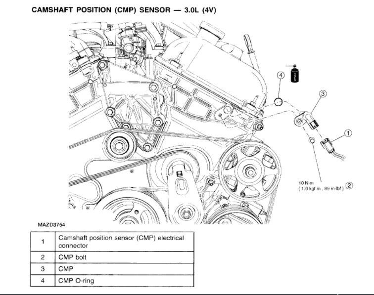

How many camshaft position sensor does this have one or two? I replace one already.

Okay, I attached the location and procedure for the cam sensor for you.
CAMSHAFT POSITION (CMP) SENSOR
Removal and Installation
1. Disconnect the electrical connector.
2. Remove the CMP bolt.
3. Remove the CMP sensor.
4. Remove the O-ring.
5. To install, reverse the removal procedure.
Nov 16, 2020 at 5:33 PM
